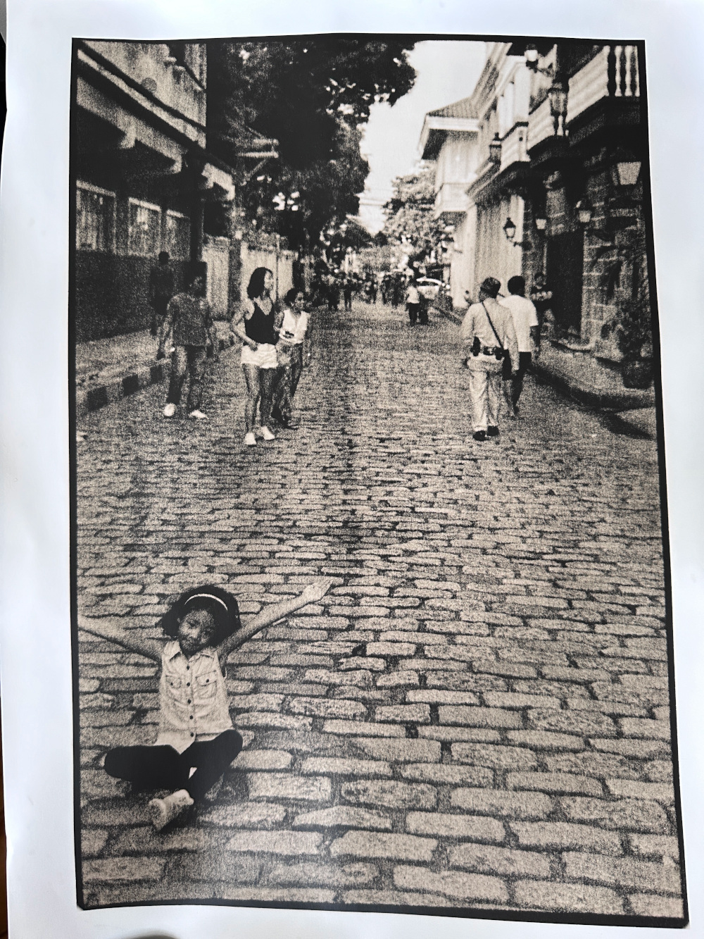

So, I have some old Fotokemika Varycon paper, totally fogged when using normal paper developer. But in Lith is it usable.
And I am happy with the results, but in the same time - man, once when this package is gone - no more of this, you cannot buy this stuff any more. Same goes for Fomatone MG 543.

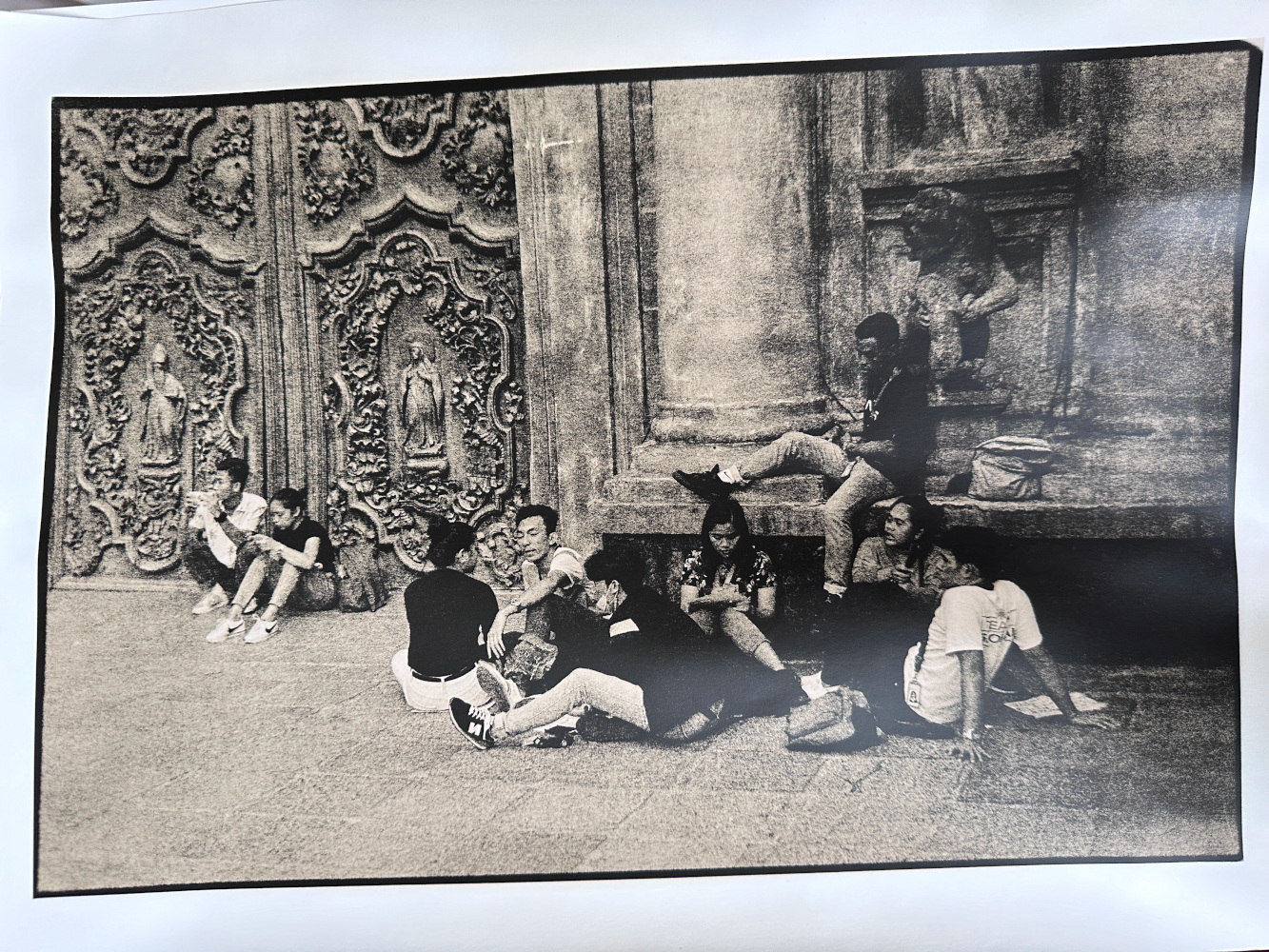

Let me share results of Fotokemika Varycon in Moersch Easy Lith (25ml A, 25ml B in 1 liter of water):
Beautiful result!

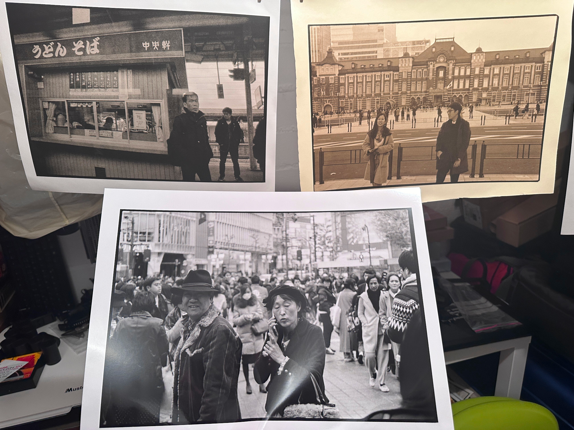

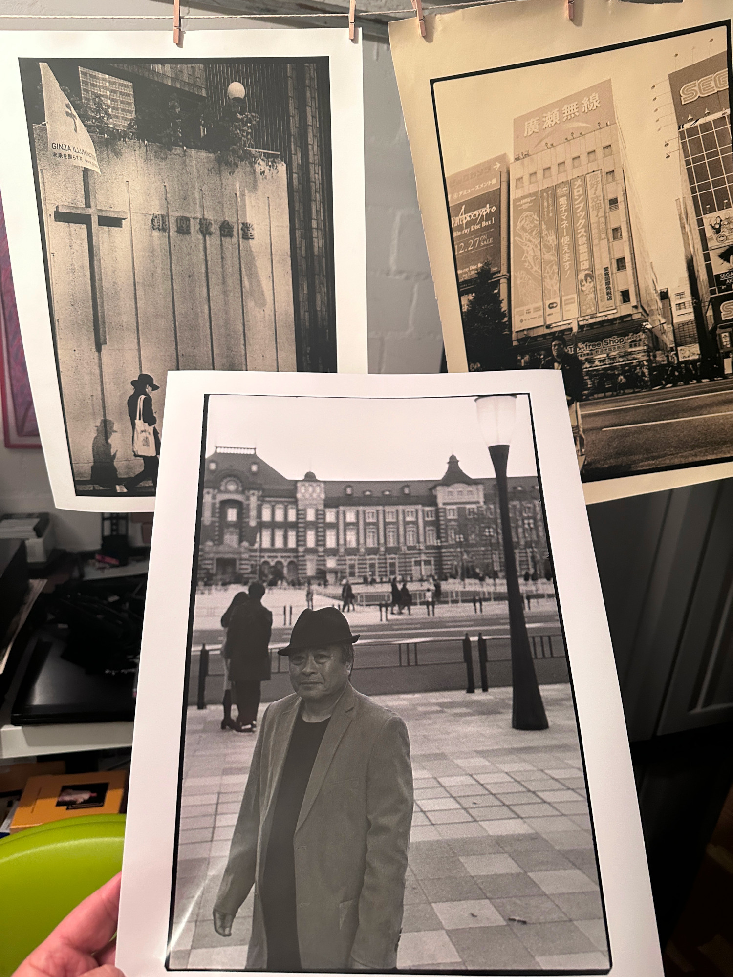

I made a comparison of prints: Lith Fotokemika Varycon (up left) vs Lith Fomatone MG 542 (up right) vs Normal RC print on Fomaspeed (bottom):

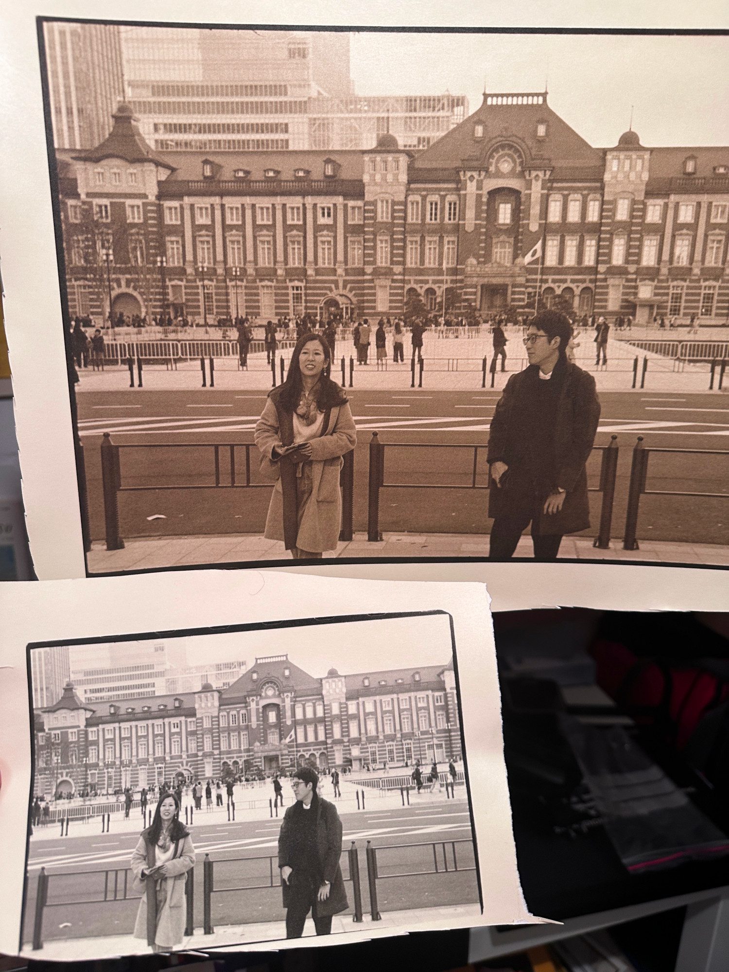

Second comparison: Fomatome MG 542 in Easy Lith vs Fomatone MG in Ilford PQ universal:
