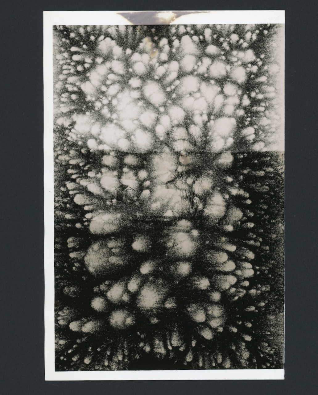

I tried lith printing for the first time and found out that Fomabrom Variant 111 doesn't work with lith. I thought it should be OK for lith. I was using Moercsh Easy Lith and tried with 20+20 and 50+50 mixes. I tried an old Agfa gevart brovira BW 112 in the same mix and it worked fine.
But then I read somewhere that even Fomatone MG 131 have had problems with Lith because Foma changed something in the paper.
I was thinking of buying some new paper for lith process, so what it should be? Have you ordered / tested some papers lately? I'm not interested in overall experiences of papers but results with enough recent batch of paper..
Below is result of Fomabrom Variant 111 and Moersch EasyLith:

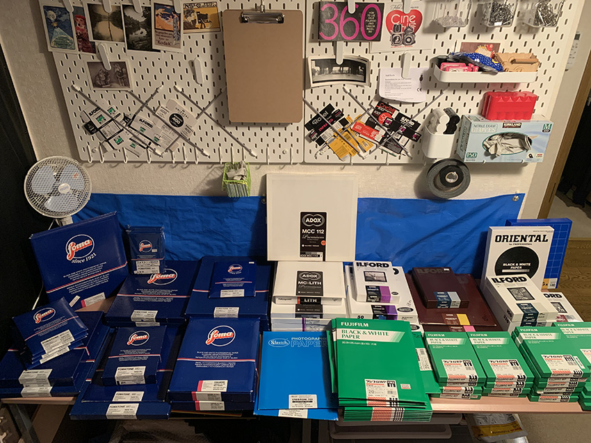

Good question! I have a smallish(?) stock of around 20 boxes of old Foma papers - before the formulation change, as well as some other brands. However, since I have different projects in mind that I want to print in lith, I know I'll need to source more modern papers to do so. I know there are some work arounds for the snowballing effect of modern Foma papers (like pre-soaking the paper before it goes into the lith developer), but it would be nice to work with papers straight out of the box, either for first or second-pass lith. I know Ilford Warmtone papers can give a subtle lith effect that people enjoy, but I haven't experimented enough with it to determine if I really like it or not. Until recently I was using Fuji's Fujibro papers (only available in Japan, and have since been discontinued, although I can still find some in the shops) since they had a nice sandy tone that I liked. The paper was prone to pepper fogging by the 4th or 5th print though.
I had started to compile a list of possible modern papers to use for lith (and processes to use with them, since some work better in different developers/dilutions/temperatures/etc. than others) but my main computer died recently so I'm not sure if I had backed up the file or not. I'll take a look and see if I can find it. The Facebook group on lith printing is a good resource, but I'd like to create a website or wiki that people could contribute to so that all the information is in one place. Most of the lith information on the internet is quite old, and often repetitive, using examples of papers and developers that no longer exist.
Here's a photo I took back in March when I was re-organizing my darkroom and taking stock of everything I had in it. Most of these papers I've been saving for lith projects but I've been reluctant to start using any of them since they are such a finite resource!

Neutral tone VC papers often lith very coarsely or not at all. I'm not surprised you ran into trouble with foma 112. You might get something usable by tweaking the processing parameters (exposure & developer additives & development time), but fomatone is just a whole lot easier to lith.
Thanks! Waiting for my Fomatone to be delivered :D

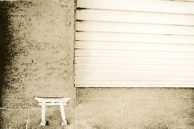

Here in Japan Fuji made a paper called Fujibro in two RC flavours - fixed grade and variable. For whatever reason, the fixed grade version liths, but the variable one does not. None of the fibre papers they used to make lithed either. I used to be like a lot of people in preferring fibre prints (for lith work especially) but got over that once I realised the Fujibro would lith - it was cheap and produced nice sandy colours. The only problem with it is it is extremely slow at normal developing temps (20C = 40-60 min) but speeds up considerably at higher temperatures (30-40C = 5 min). It also gets a lot of pepper grain after the third or fourth print. And in does not do second pass lith well at all - prints look muddier than the original.
As for Dr. Rudman's books - they are excellent, but if you can't find an affordable copy, I wouldn't worry about it too much. A lot of the information about second-pass lith (and other techniques) that are in his books are available online in many articles and blog posts (some feel no compunction to copy almost directly from him). Plus, many of the papers he refers to in his books are no longer available, so it makes more sense to see what people are doing now with available papers (the lith group on FB is a good place for that too).
Lith print on Fujibro (RC) paper:
