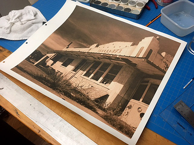

The best, #1, most kickass thing I've found is going 2-tray for lith. Warm tray of dev, 2nd tray of warm water with a splash of old brown or very tiny bit of fresh dev. Once the print seems like it's getting close, go to the warm water and the critical snatch point slows down. You can go back to the straight dev if needed, since the paper now has some dilute dev in the emulsion, it takes a minute to speed back up. This has been a huge help for me to get "closer to perfect", and you can see the print much better in the dilute dev - the highlights are much easier to judge, and I feel like you get more delicate highs with more tonality this way.
16x20 Ektalure, 2-tray dev, no selenium or bleach or post-toning:
