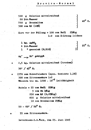

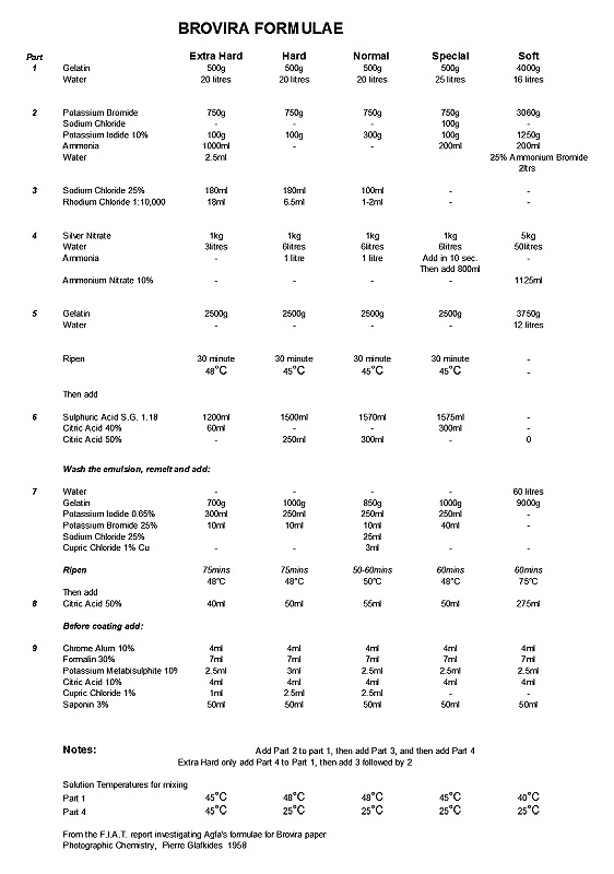

I am wrestling, as I said, with trying to decipher formulas and patents for my next book and have run into a number of seeming errors, omissions and misprints. I am able to see the original BIOS and FIAT reports from the RIT library, the U of R library, the GEH (now GEM) library, and the Kodak Research Library. I have compared the BIOS and FIAT reports (British and US Intelligence) and find that they are virtually identical, but the copies of them are quite different. Here below is the original Brovira Normal formula with some German, and the Glafkides copy.
Note that the original (this is the BIOS copy) gives names to the two different gelatins used and includes a conductivity end point for the wash. This is all either omitted by Glafkides or so rearranged using text over several pages and charts, that this original is difficult to reconstruct.
This is just an example for you all taken from the original documents.
A fellow APUG member called me on the phone, and said that there was no Iodide in Brovira, but he did not know that KJ is chemical notation for KI in German. I am referring to no person who has posted in this thread thus far. So, I hope there is no stir created by this comment. Yes, there is dump Iodide.
