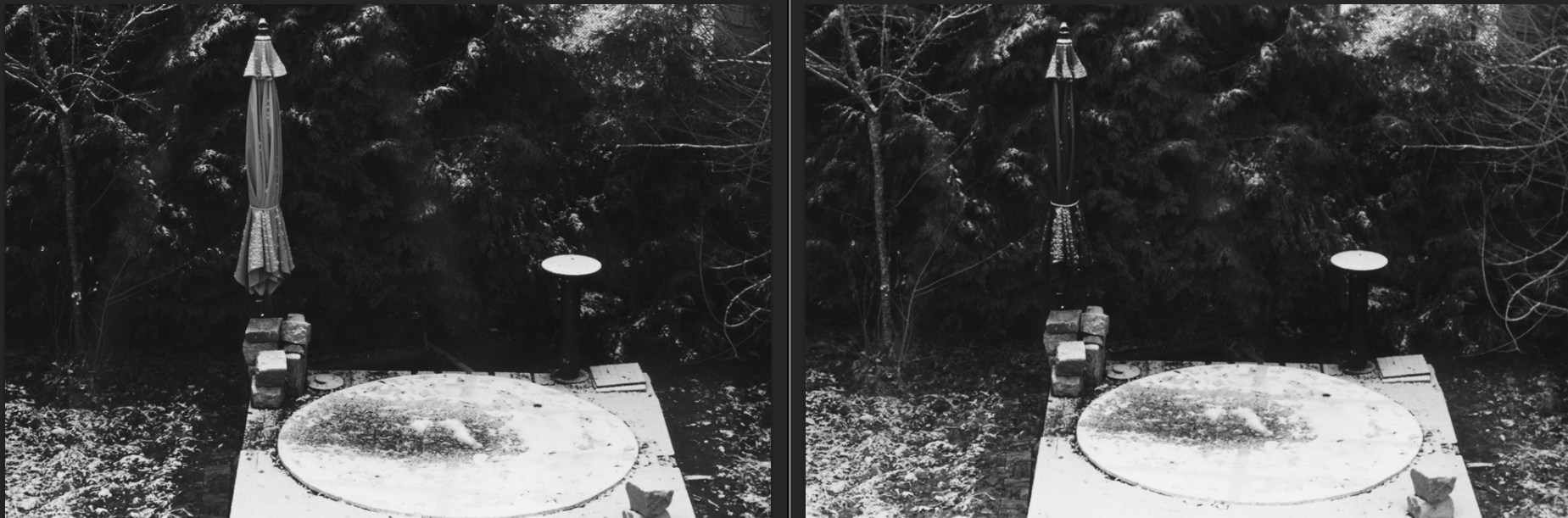

Fomapan R 100 might be the surprise here - was for me, but test I ran couple of days ago shows very small IR response. Left: Unfiltered Fomapan R 100 @800 | Right: Filtered with Heliopan RG715, +13 stop or half an hour exposure. You can see that the turquoise sun shield turned black and the evergreens reflecting some winter evening light. The response is very weak, but it's there!

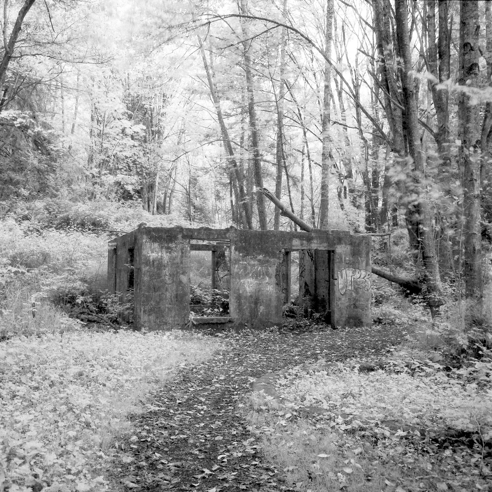

I use Rollei Infrared 400 with Red23, Red25, Red29 and 720 filters. Each provides its own depth of the Wood Effect.
Which one do you prefer, which gives best speed/visibility TTL/Wood combo for you?

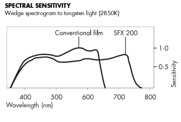

If we look at Ilford SFX 200 and say Adox HR-50 / Scala 50 sensitivity curves, we can see why.
SFX has weaker NIR response.
Ilford SFX 200:

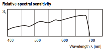

Adox HR-50 / Scala 50:

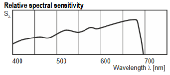

Fomapan R 100:
Therefore some NIR sensitivity

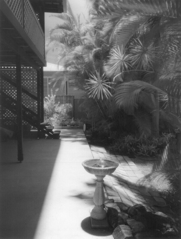

I know Aviphot has already been mentioned, but I will say, it is EXTREMELY responsive. Even with the cheapest IR filter I could get for my RB67, it has an extremely obvious wood effect, and the sky goes black without a polarizer, something I have heard folks mentioning they needed sometimes. I would definitely recommend picking up Aviphot or a derivative, and playing around with it.
