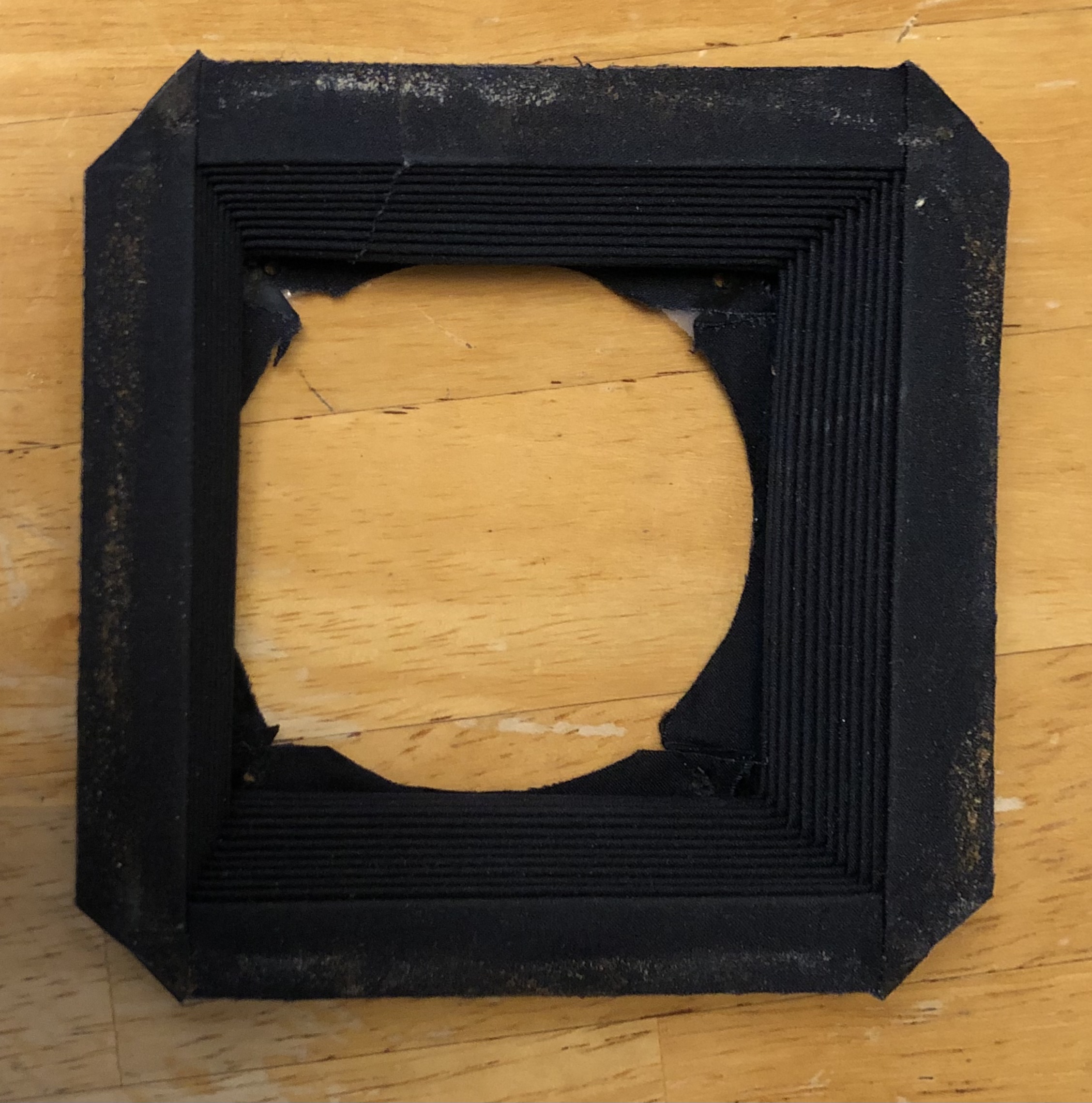

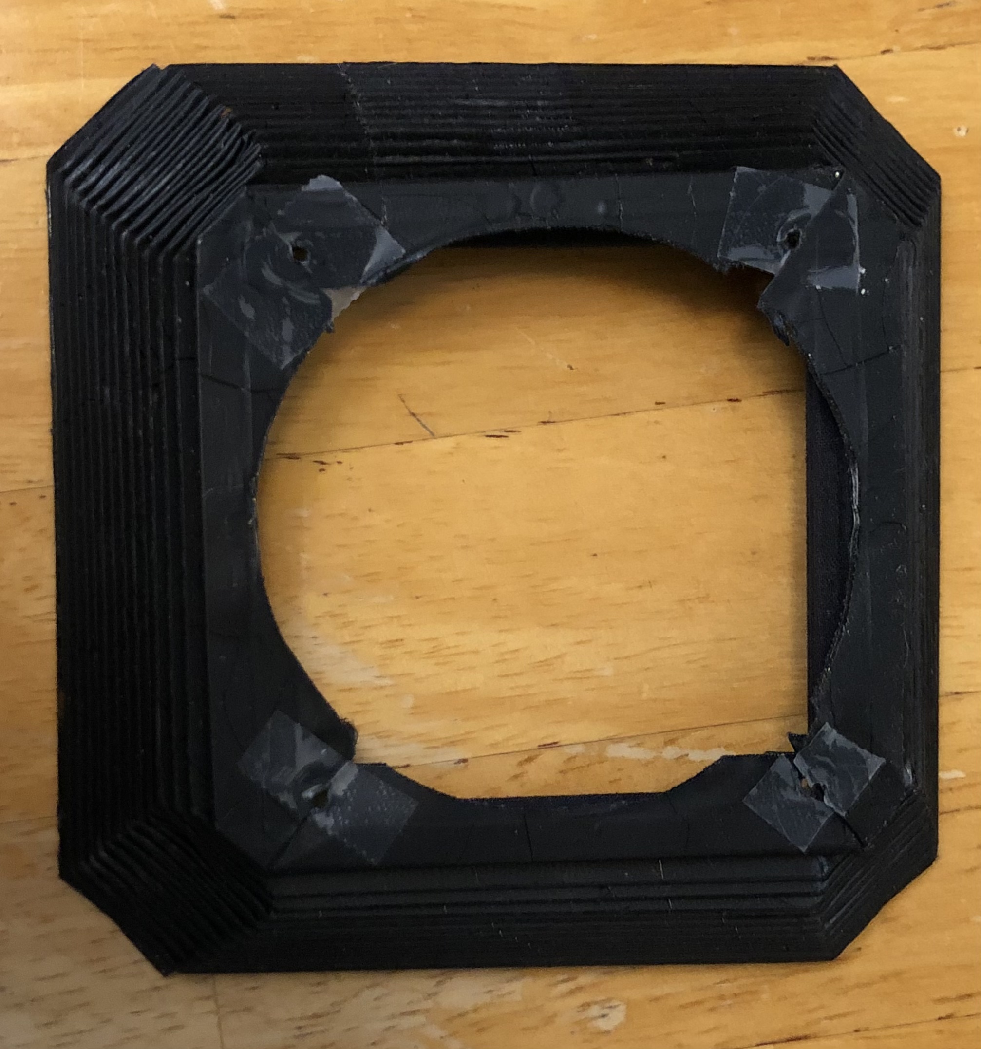

Here's how my recently replaced TechV 23b bellows looks. You can see the screw holes on the front and the adhesive residue on the back.
B1CB6F9A-10E7-4755-9DF0-C5B1B4DBB849.jpeg 8D1269CF-80CC-4752-82DB-084593736BB7.jpeg
View attachment 260056 View attachment 260057
Thanks again. I've watched last night YT for Technika IV replacement, so I would assume V is at least the same and looks like it. I will definitely be able to get this done myself, so that is good news. Just asked CustomBellows in UK to see what new bellows is going to cost from them (I hope they have Technikas in their database so I won't need to send them dimensions). As I am more and more towards Technika 70, it is still generally the same construction bellows wise and I doubt Linhof mounted its bellows differently.
What you see on the rear end is residue from a sealing material that goes between bellows and back standard. Bellows themselves are still attached to standard with screws (they are outside of bellows edge, so no holes shown). Front takes some fitting to get bellows front frame inside first crease, it is then glued to it for secure fit, then screwed in (as first step in mounting bellows). So overall it is not a difficult task, but requires some care, good cleaning of old residue etc. This is good news. Getting right bellows so they provide original extension may be another. I would think CustomBellows does it per Linhof specs. The guy on YT appeared to have new ones from China/HongKong and had to cut off few front creases for the front frame to fit in, which disturbed me a bit. But that is for the time when I get whichever camera and deal with bellows and that is a sure thing given I'm looking at cameras built in the 60's.
