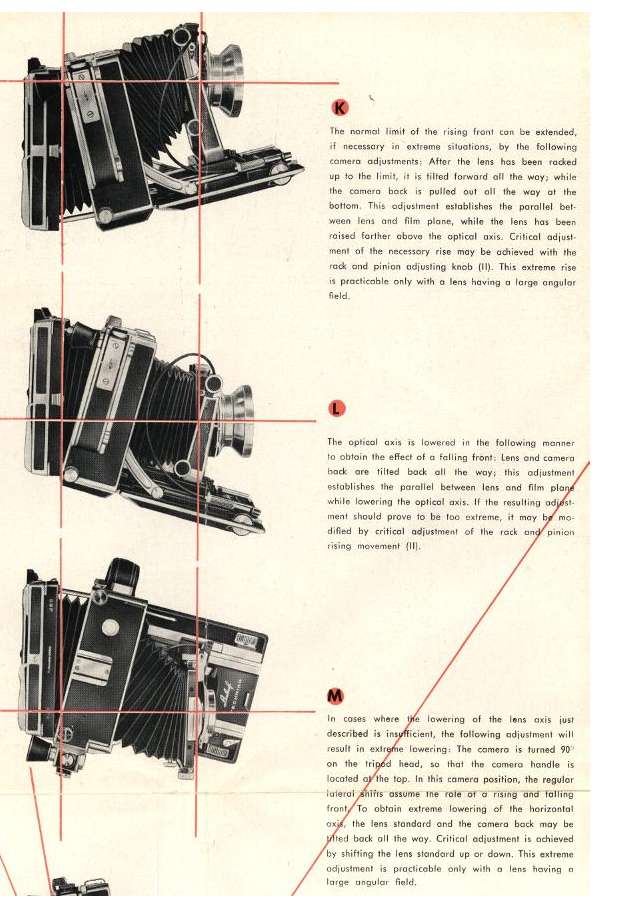

With the technila you'll have to practice this kind of operation to shine in architecture:

For that I would prefer a monorail of the Sinar Norma class, I feel the technika is more landscape oriented but as it's a very versatile camera it also will do architecture with indirect movements like those depicted in the picture I posted.

One of the problems found in architecture shooting is that you may not be able to shot from the place you want, because you have an obstacle, etc, then you displace the tripod to a viable place and point the camera to de direction that gives you the view you want but that direction does not place your subject on film, then you use movements (image placement) to put the subject on the film sheet... This is why large circles and ample movements are desired. Don't worry, not necessary to start with that, this is something you will find in your progression, but for sure that when you discover it you will love it.
For the moment see how the bed drop allows to extent rise, and what indirect movements are...
