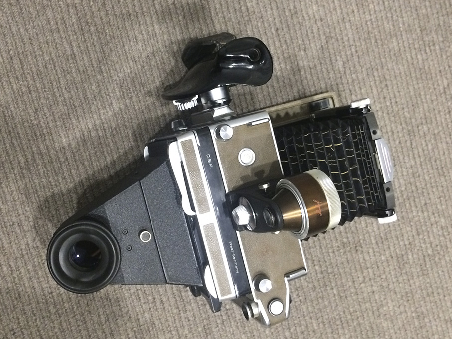

I have a Deardorff 8x10, A Shen-Hao 5x7 with a 4x5 reducing back and a Linhof Technica IV. If I had to keep only one for LF shooting it would be the Linhof. Some of the pros:
- Reflex viewfinder option is great and easy to source online
- Universal viewfinder can help with lens selection
- Rotating back
- Small profile lens can be folded inside the camera
- The grip is very handy and makes it easy to carry, setup and store
- Infinity focus stop clips for various lens focal lengths
- Very robust design and build
- Typing in "linhof" in eBay will always reveal another thing you just must have!
Some of the criticisms have been covered above. I think there is just a subtle user experience or aesthetic with a wooden view camera. The Linhof tends to "fight back" a bit if you try to do something it doesn't like. Wooden cameras just seem to be a bit more forgiving. Again, nothing to do with ability to make a great image either way.
A picture of my setup attached. Bellows are crackly but still very light tight!
