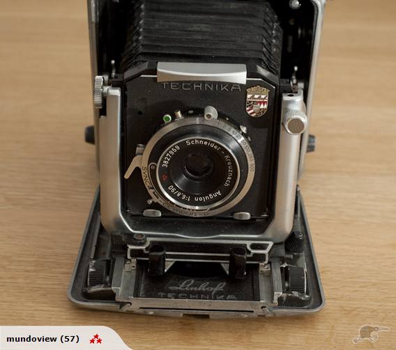

Hay guys.. I was looking at a moskva 5 originally as my first medium
format camera...
but I've been looking at this linhof technika...
this technika has had a few modifications.. Rangefinder has been removed.
other mods include a cut away at the top plate to all movements for wide lenses.
and its been stripped away of anything that was necessary
for use as a field camera.
Im trying to find info on this camera.. but I dont know the exact model.
maybe somebody here knows? Also what are the pro's and con's of this
camera.. im guessing it has interchangeable lenses..
thanks. :smile:

Looks like it could be a 6x9cm Technika V. Or, it may be a Technika 70 that once had a rather large rangefinder on top. One way to tell is:
The tech 70 had a sliding thumb tab on the right side (from behind the camera) that was part of a quick way to change the position of focus cams. If there is no such device on this camera I would say its a Tech V.
Looks kind of cool utilitarian actually. Probably works great.
