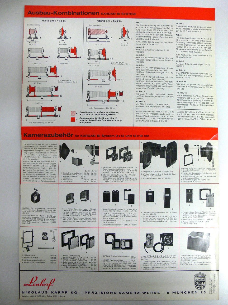

I own Linhof Bi system with all three standards (4x5, 5x7, 8x10) and was searching for instructions etc. when trying to assemble the extension rail (the threaded part was missing).
Here is the picture of the list of accessories I found, maybe useful.
Great, very helpful. I'm trying to source out as much as I can on Linhof LF gear as it appears to be a tightly held secret on the net. Some systems could crash a server with abundance of data, Linhof ... seems like forget about even starting a server. Good thing is Linhof appears to be a well thought out system that only goes in a couple of general directions for part interchangeability.
As mentioned by Kumar above, only the rails and clamps are not exchangable with the Kardan family (GT / GTL / TL etc).
One of the difficulties I had was to proper mount the Bi Kardan with 5x7/8x10 back on the tripod and e.g. ball head with Arca-style release plate did not sound firm enough for me for that. I ended up with large 120mm in diameter leveling base (Sunway DYH120) to mount camer direclty on the gitzo tripod. There are Linhof tripods that could mount the base of the camera (if I am getting it correcly) but they are heavy (not carbon made like gitzo).
