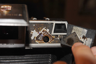

ZenziFriend
Mar 14, 2013
64
Germany
the screws for adjusting the rangefinder of the Model III
It is easy, remove the letherette besides the viewfinder, then adjust the ground glass to Focus a medium range obcet, and adust the screw until the rangefinder is correct...
Adjusting a Technika Rangefinder by xipho68, auf Flickr
