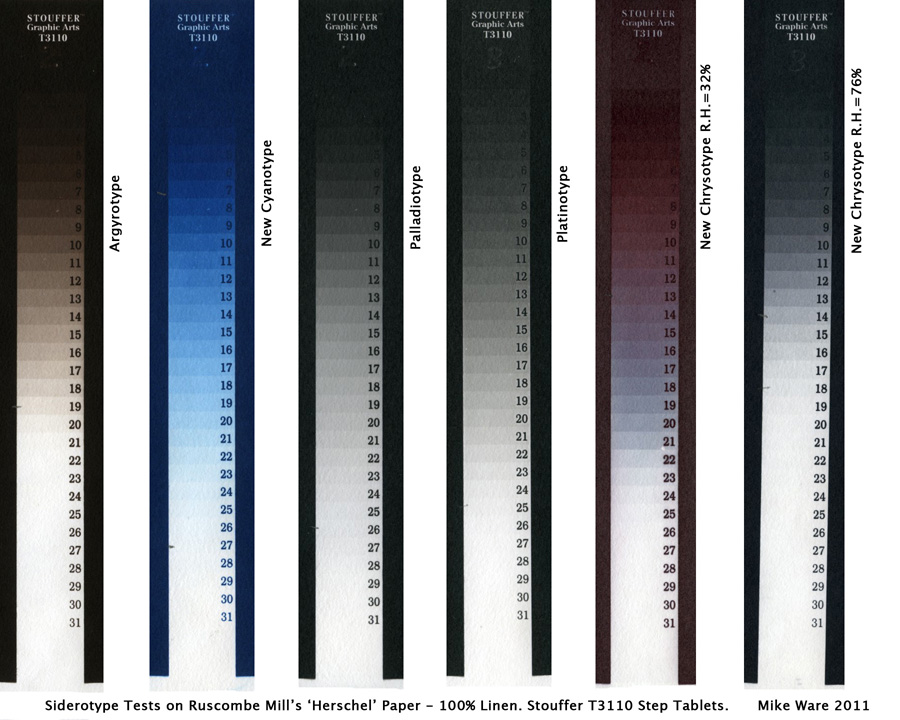

Thanks for all comments on this new paper option - a response to specific points:
Regarding surface:-
Cold- or hot-pressed is an issue of taste, of course, and actual image size, i.e. viewing distance. Herschel suits my current printing at 11"x16", but I'm still happy with the texture at 8"x10"; at 4"x5" it might become a little obtrusive.
Many hot-pressed papers, like Arches Platine, lose some of their calender in the wet processing, especially on the felt side.
Processed Herschel paper does not look much different, compared with processed Arches Platine - just a hint warmer white, perhaps, and a little more 'tooth'.
To provide an impression, I'll risk an attachment of some steptablets - although the scanner optics have rather overemphasised the surface texture.
Regarding performance:-
Herschel paper's most important advantage over Arches Platine, COT 320, or Weston Diploma is that it displays no spots - black or white.
Its difference to most machine-made papers is that it requires absolutely no preliminary treatments of any kind before coating with iron-based sensitizer solutions.
That appeals to a lazy operator like me.
Its absorbancy is economic (~30 cc of sensitizer per square meter, dependent on ambient RH) but gives sufficient coating weight for a good Dmax.
The 200 gsm weight provides quite adequate strength for handling wet-processed 16"x20" sheets - I've not tried a full Imperial sheet, but have no doubt that it would be strong enough.
A weight heavier than 200 gsm in linen might cause drying problems.
Regarding expense:-
When printing in precious metals, failure with a cheap paper will cost far more than success with an expensive one.
False economy in choice of paper can make one a favorite customer of the Pt/Pd/Au chemicals suppliers.
As a rough estimate: a skilled papermaker can probably hand-make 10 sheets of paper in about the same time that it takes one of us to hand-make one siderotype print on it.
At what sum do we value our handmade prints? So should we be prepared to pay as much as 1/10th of that for the sheet of fine handmade paper?
Mike

pschwart
Jul 15, 2005
1,147
San Francisco, CA
Your points are well taken. The midtones look a bit grainy in the step tablet images, but that could just be the scan. I am always game to try a new paper, but still don't know if it will available in the US ...
