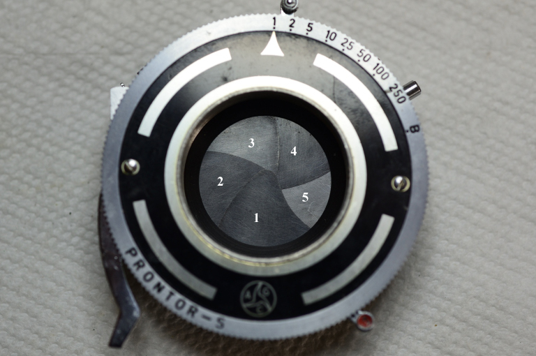

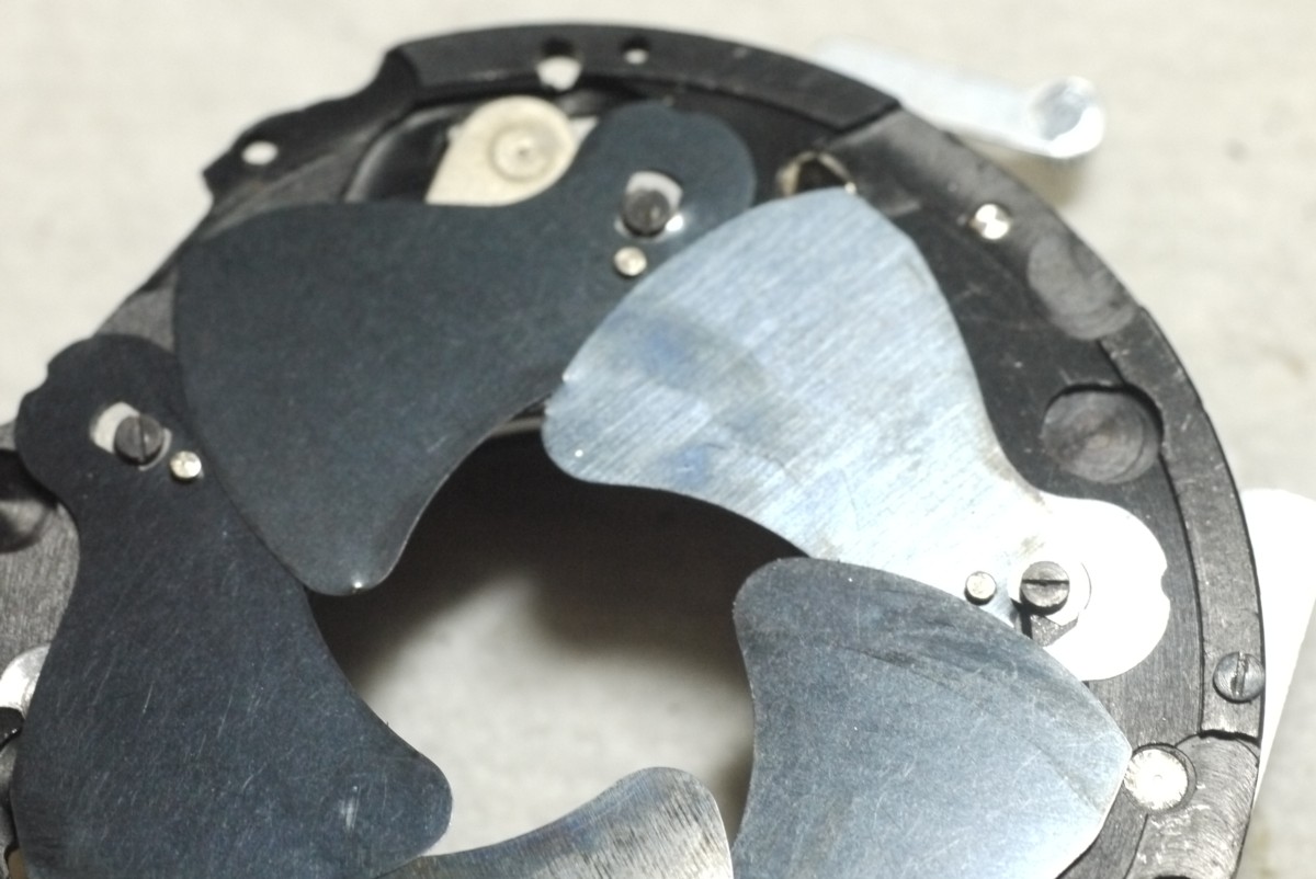

I got a Nettar with a Pronto shutter. One of the blades is messed up, which is quite a surprise considering the multiple affirmations of "Good Condition!", "Works Great!" from the seller. The back does not appear to come off. I assume this must be accessed from the front? That would entail removing the speed control, self timer, release linkage (essentially everything)? I've done an extensive web search but not seen anything with this detail.

I have no idea how to get into that shutter (sorry) but wonder what your goal is. Those blades look seriously messed up. Are you thinking of trying to straighten them?

As there appears to be physical damage (deformation) of at least two of the shutter blades, I don't think there's much point in disassembling the shutter to remedy its problems. You won't be able to restore those shutter blades to ideal flatness.
That aside, if the Prontor shutter is anything like a Compur, the three screws on the back of the shutter housing should "split the case" when removed, which separates the mechanism plate (interior body) from the housing. The shutter blades should be accessible once the outer case comes off. The aperture blades will likely stay affixed to the outer case (don't remove the retaining plate that holds the aperture blades in place unless absolutely necessary! You can do a lot of cleaning in place with patience and time). Once the outer case is lifted off, it should reveal the shutter blades. Odds are, they will not be held in place by anything, so remove the case gently and take a photo immediately to record the position of the blades (which way they overlap, which blade is in the first position, etc). This should give you access to the blades, but I'm doubtful they can be restored to functional condition.

I agree, there are at least two blades with damage. I presume those are shutter blades, not aperture, due to the shape of the partial opening.
I also agree, there's almost no chance of restoring those blades to usable condition. If it were mine, I might try burnishing the blade edges against a backing block (which wouldn't even require removing the blades or clockwork), but I'm almost certain the metal is stretched, which will prevent the blade ever returning to flat (get the dents to lay down, and the whole blade will curve like a potato chip). The other alternative might be to actually cut or grind the damaged edges back enough to eliminate the deformed metal, but that's also a procedure very deeply fraught with opportunities to fail -- and no guarantee the shutter would close completely after removing metal from the edges of the blades (nor any guarantee you can do the job without warping the remaining blade).

I have successfully flattened such edge bends in the past by placing the blade on a smooth flat desk top and rubbing the bent edge with the sooth, rounded end of a plastic handle #0 screwdriver. Some blades have a pivot pin in them so a wood block needs to be used for them. A layer of paper towel can be used between the blade and wood block also.

looks like at least one of the blades is off the pivot. wonder if it was taken appart but not reassembled correctly.
That's what I think, the blades were assembled in incorrect order and hit one another when it was operated.

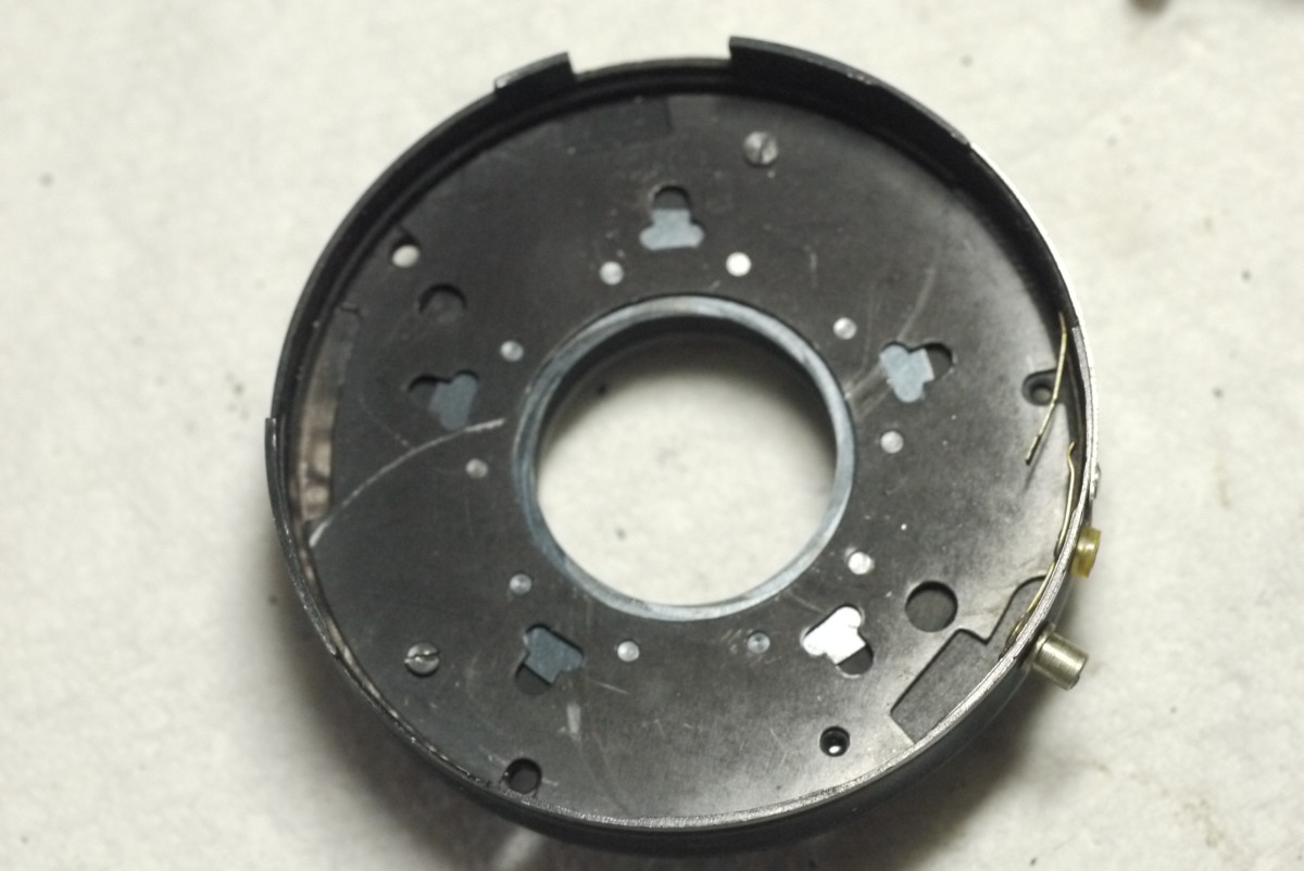

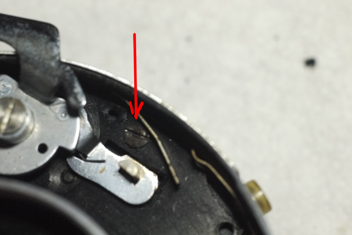

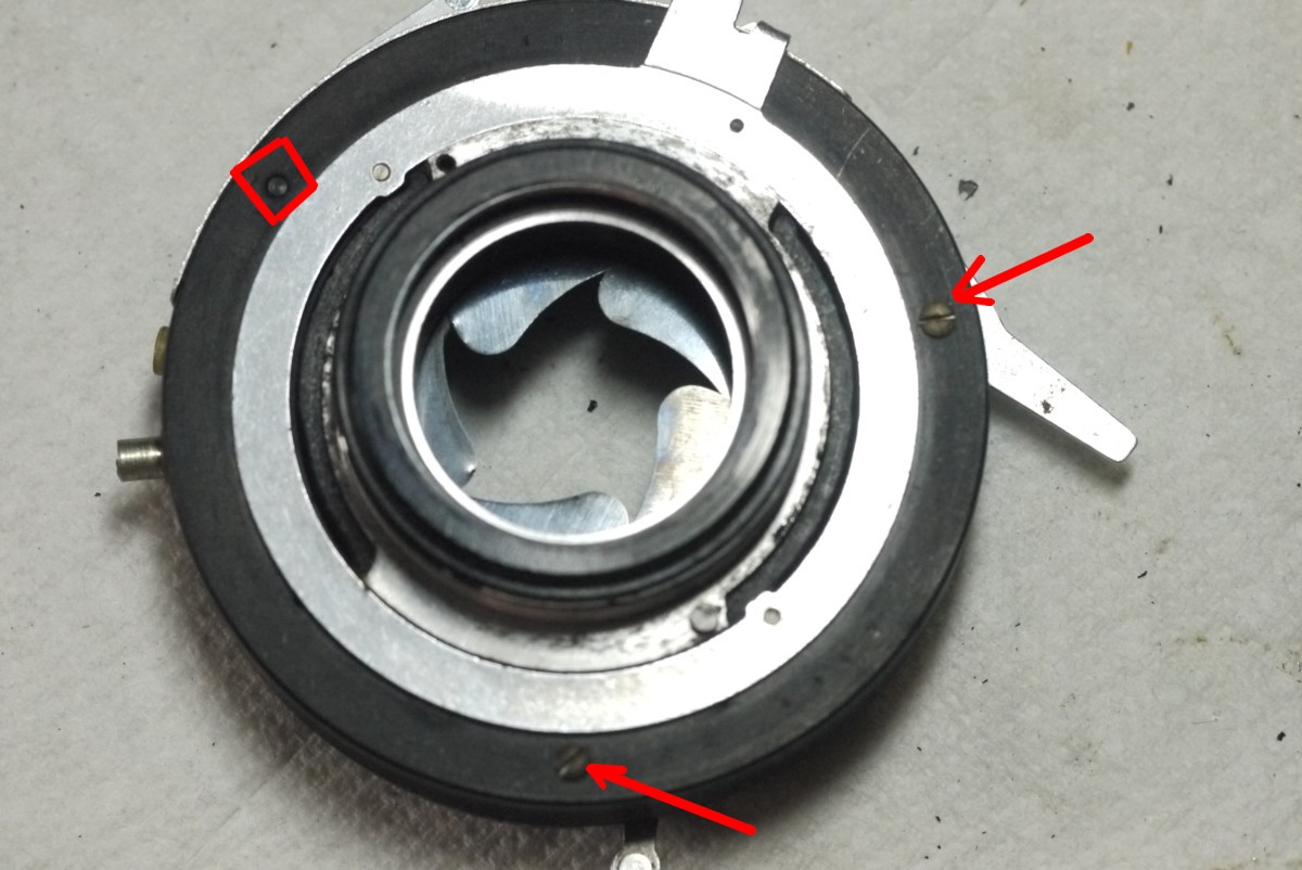

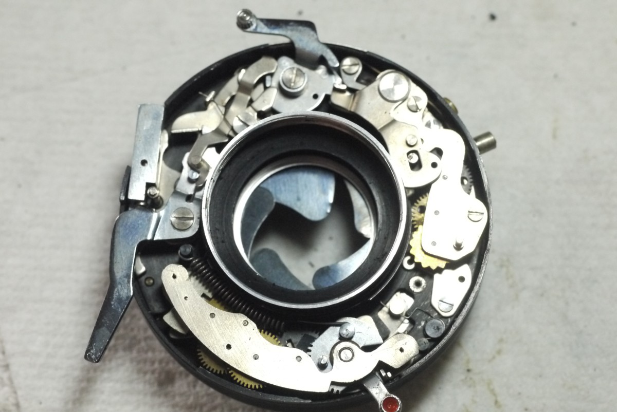

For those that may come after me, I leave these breadcrumbs. This is a late model Pronto shutter off of a 518/2 Nettar.
Disassemble the shutter down to the usual point for an immersion cleaning.

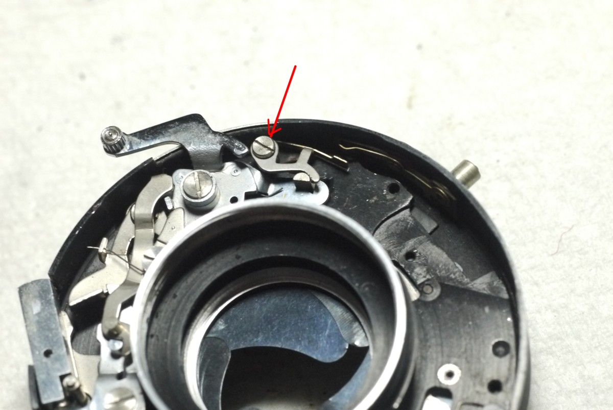

On the back are two screws. Remove them. Note that where the third screw should be it looks sort of like a pin.

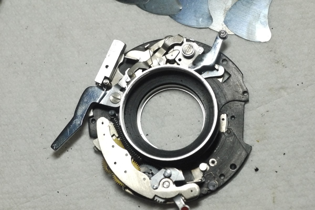

Turn it over and remove the shutter escapement. Then remove the little lever that closes the flash contacts.
Now you can see a screw head just below the flash contact. Remove it. That is the "pin" you see from the back. Why they put this screw in from the front is beyond me.

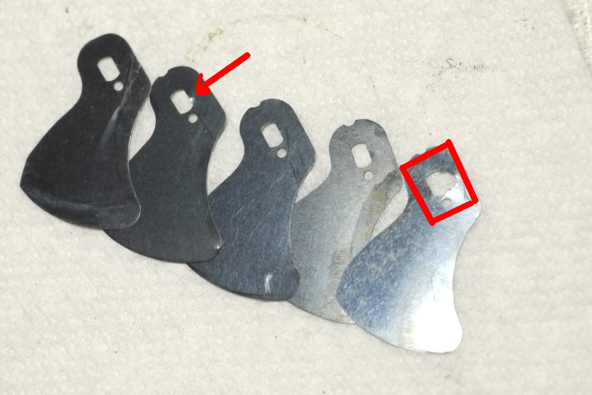

The mechanism will pull out of the shutter housing. Here are the shutter blades with the errant one put back in place.
The loose shutter leaf has a chunk taken out of it. Another one has a ding. I can't imagine how you could do this. It does not look like this shutter has ever been removed before.
The cool thing about the Pronto is the mechanism is self contained, i.e. it can still be worked when disassembled. I believe Copals, Klios and Varios work this way. Compurs need to have the cam plate in place to work them, so they're not as fun. The iris mechanism is also self contained. No worry about the blades coming loose.
I'll stick with the "blades were assembled incorrectly" statement.
In your photo of the blades the one on the far left has a rounded end at the controller end and the other 4 have a notch in the controller end. The notch is there for case or component clearance. Looking at the service manuals they state that the earlier shutter's blades have a reinforcement on their top side with the 5th blade having the reinforcement on the bottom side and a specific position for it to be in. It also states that later shutters use blades of a stronger material and do not need the reinforcement. The parts manual shows a flattened edge on the controller end of the blades in some shutters. If there is no specific order for the blades in your shutter then the wrong length of screws were used or something similar occurred as the damage to the blades is from hitting something solid or incorrect installation.
There may be enough clearance to bond or solder a .001 piece of metal or bond a piece of mylar to the blades. Sheet film is .007 inch thick, 120 and 135 films are .004 inch thick. I may still have a sheet of .002 shim stock steel in my stock pile if it made the move.
