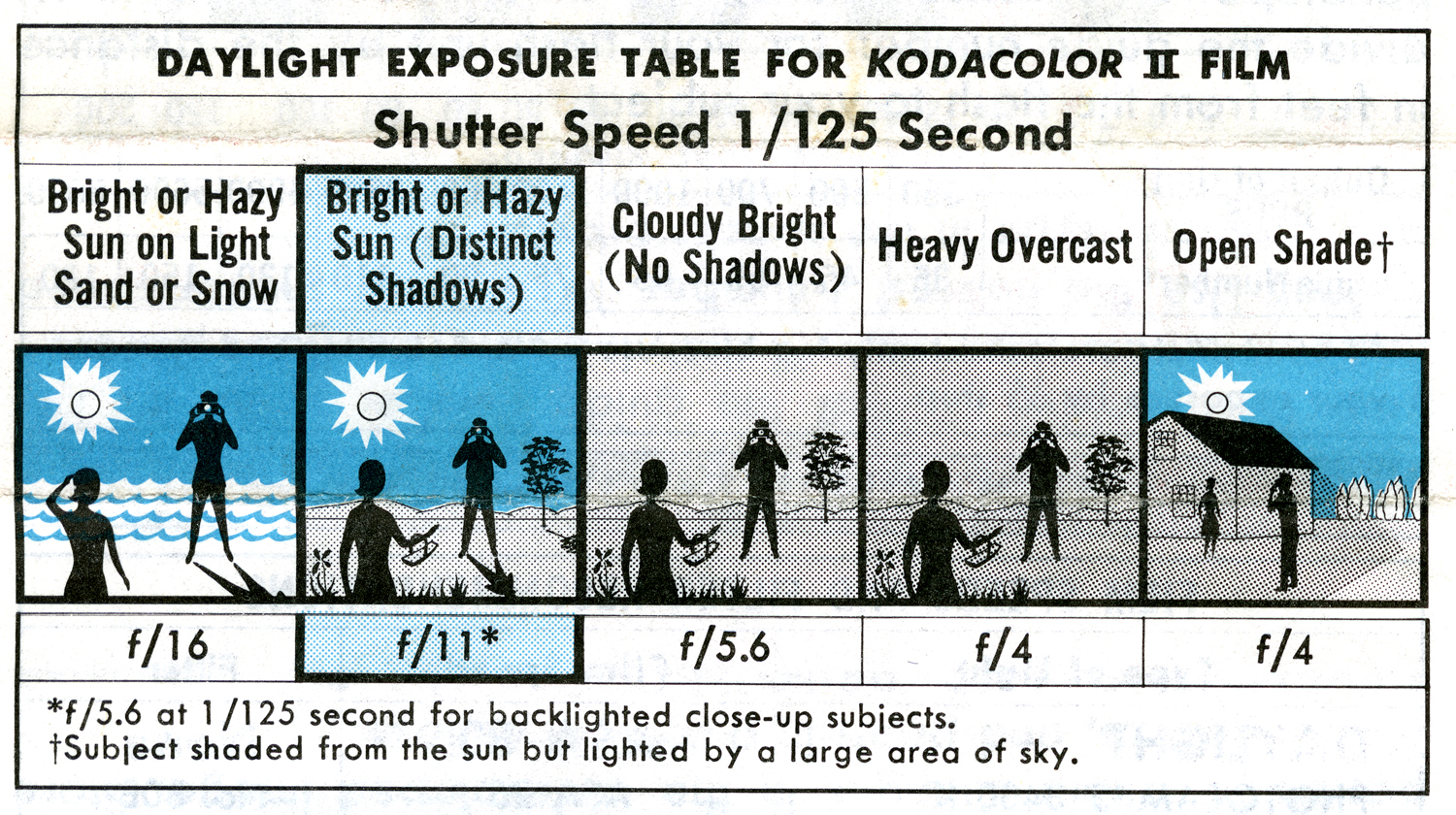

Mylightmeter is great, accurate, and has a nice analog interface. But I also keep this one on my phone (or taped to the back of the camera )
