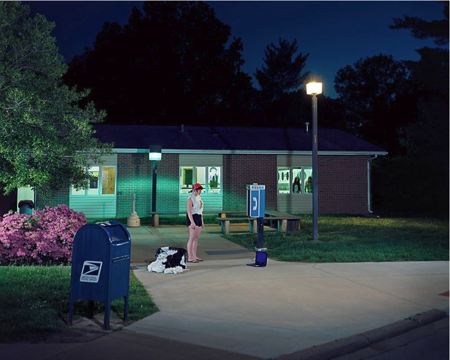

As a reference to the lighting style that I am aiming for, I've included my previous venture into cinematic lighting below. (Shot on a rented Cambo 4x5 w/ a 150mm Rodenstock -- I think-- on Kodak Ektar 100. Exposure was about 2 seconds at f/11. This left a few places soft, like the words on the mailbox. I want avoid this in this next attempt. The optical print was great and I have a 30x40 framed that is quite the conversation starter for anyone who visits my family's home...sadly, that ability went the way of the dodo once I left grad school...)

If I were doing this, I would collect some data with a light meter at the scene with ambient or existing scene lighting during the blue hour. i.e. street lamps, marquis, neon, etc.
Then find a way to measure with the light meter the LED work light output. You could borrow the work lights, play with them at Home Depot, or buy one.
A trial exposure or two will also build the data set. Then you are ready for the pièce de résistance.
LED work lights may give you color-temp fits. My most powerful LED is an Aputure Lightstorm, and it would be fairly useless in this scenario, yet it's far more powerful than a work light.
If you're near a city with a well-stocked rental house, I'd rent some Speedo packs and heads (the 2400WS packs seem to still be in rental inventories, big workhorses... I still have 2 of 'em though they rarely see much use), or a couple 575 or 1.2K HMIs. Most 1.2's will work with 120v power and don't need a dryer drop or big generator.
I've got a rental house down in denver that is going out of business this year with some 4800 packs and heads still available. They're reasonable and I'm considering them instead of the DIY route. When I did this last I had two 2400 packs for fill and 1kws camera right and left for shaping.
Either you'll want the lights to look like the setting sun, or you'll want the lights to look like the street lights. If it's the dying sunlight you're trying to match, then you'll need colored gels no matter what light source you pick. If it's street lamps you're trying to match, then you may get lucky and find LED street lamps there. But low pressure sodium vapor are probably the most common, and that's gonna require some heavy filtering to match, if that's your intent. Most professional studio lighting solutions are matched to daylight, which isn't likely going to match the available light at the scene.
You may or may not be able to run a rheostat to control the LED's. It depends on the LED's themselves. And usually, you won't get a whole lot of variation or control if that does work because they operate at such lower voltages than standard lights. They do make rheostats specifically for LED bulbs, but again, that depends on the LED's you're using and how they're being powered. A professional lighting system will likely come with it's own variable power control, so you won't have to worry about how to set that up. If nothing else, ND gels will work.
Thanks for the input. I'm shooting for a daylight/neutral bias to the color of the light. The street lamps will be what they will be, but they wont glare a huge color bias on the principal subj and area because they will be overpowered by the scene lighting. They will have the most impact on the fringes of the scene where darker/shadowy areas aren't being hit by the scene lighting. I think that would provide a kind of balance to the realism/artifice of the cinematic style lighting.
