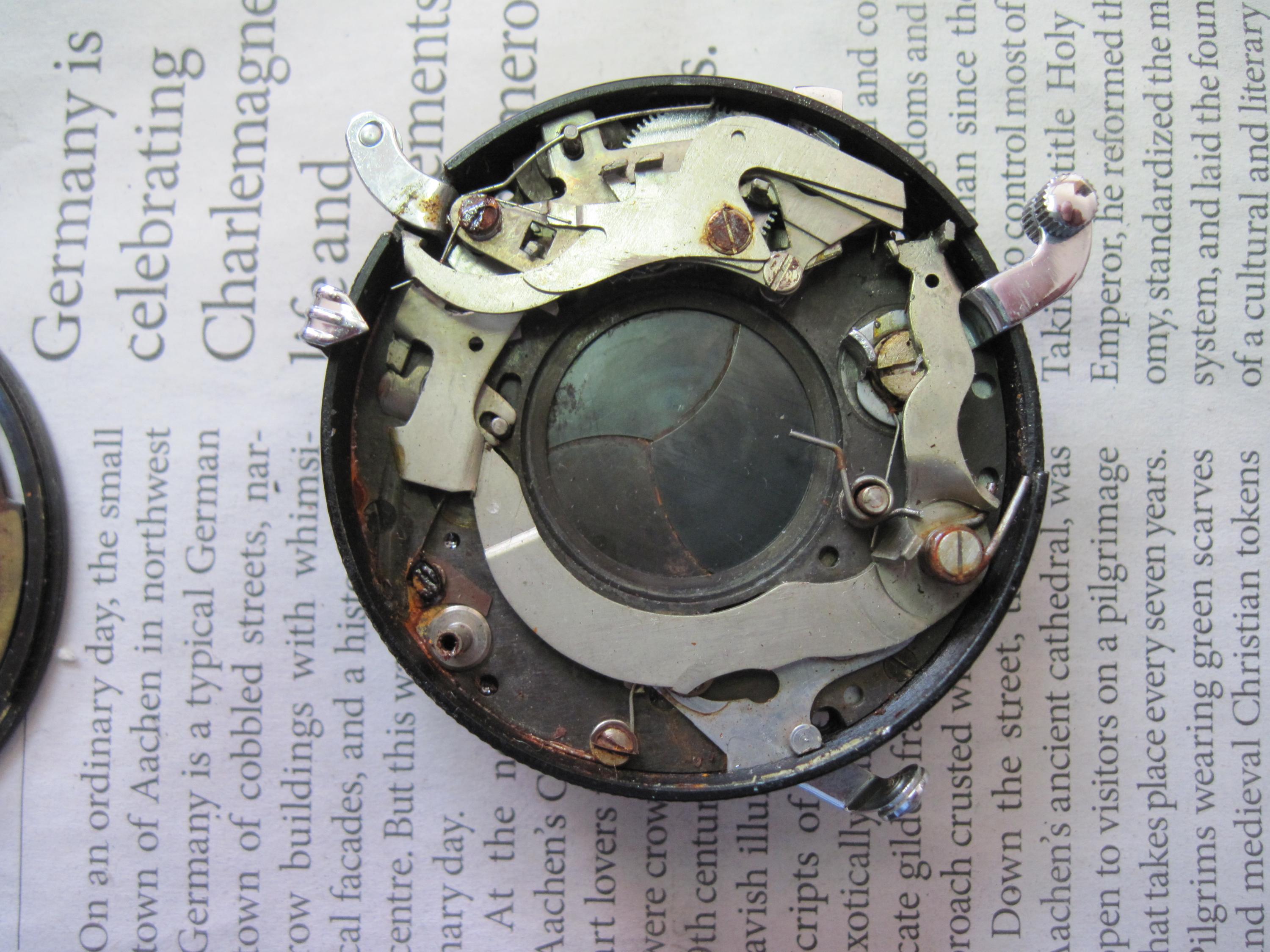

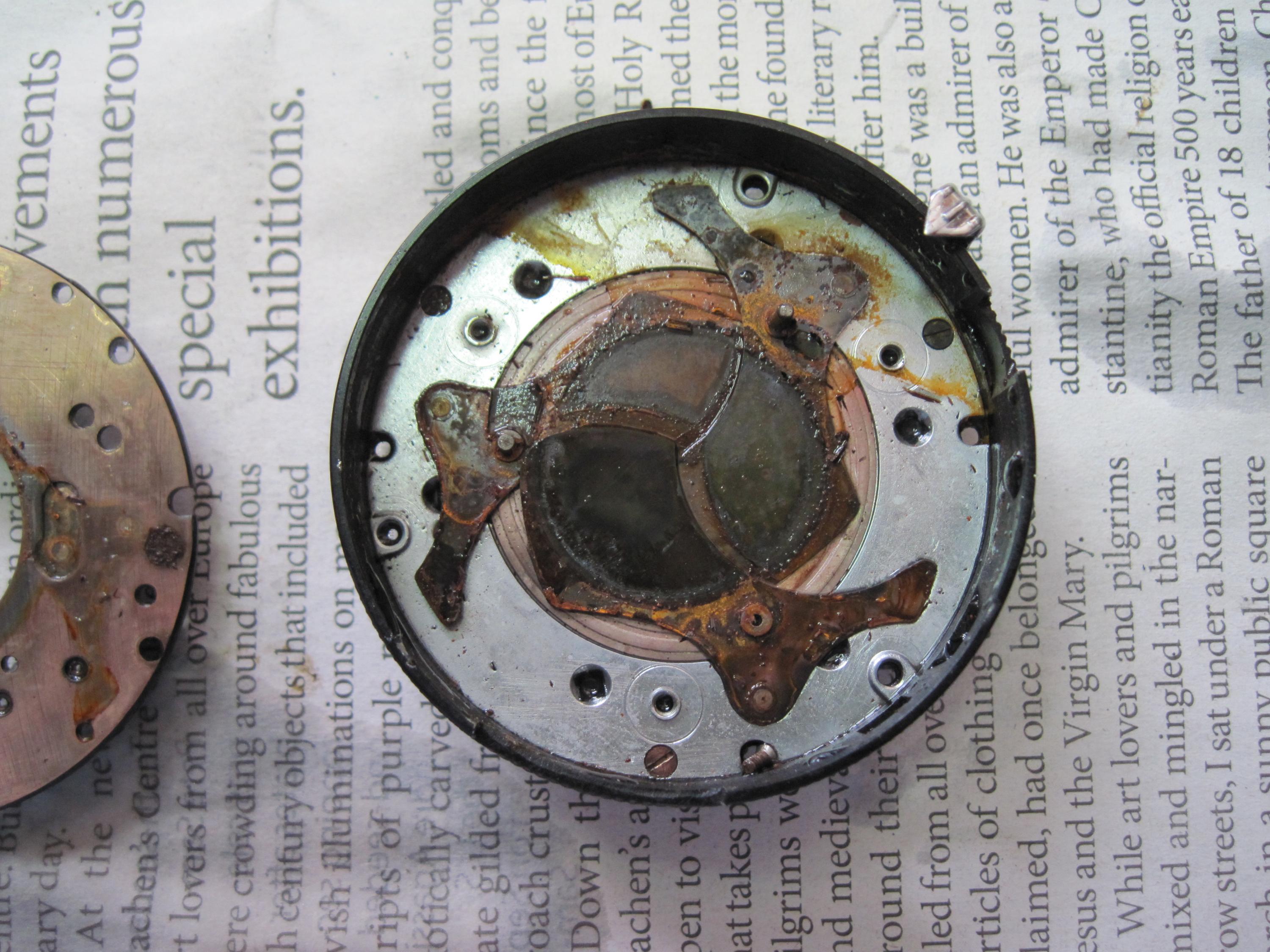

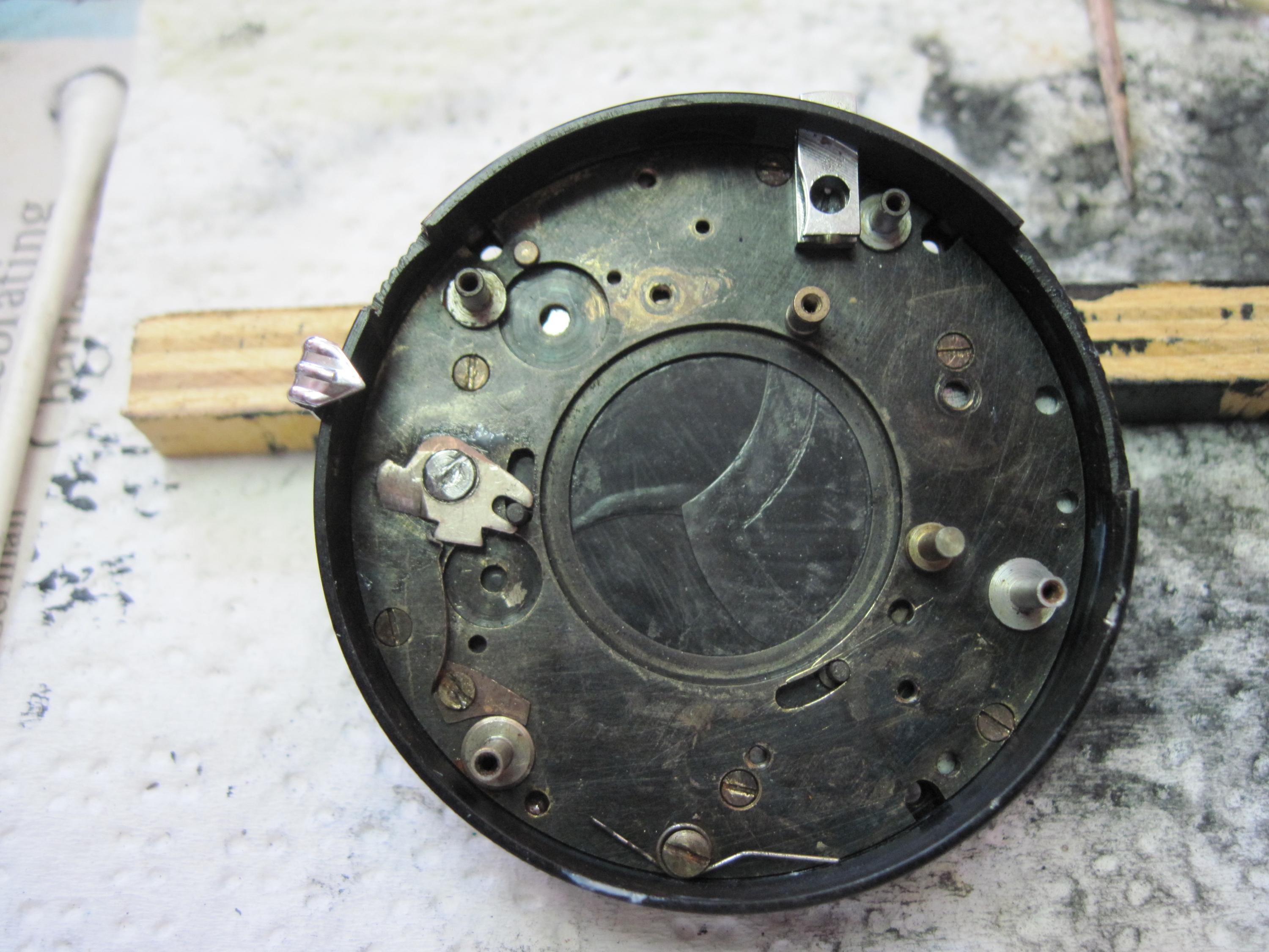

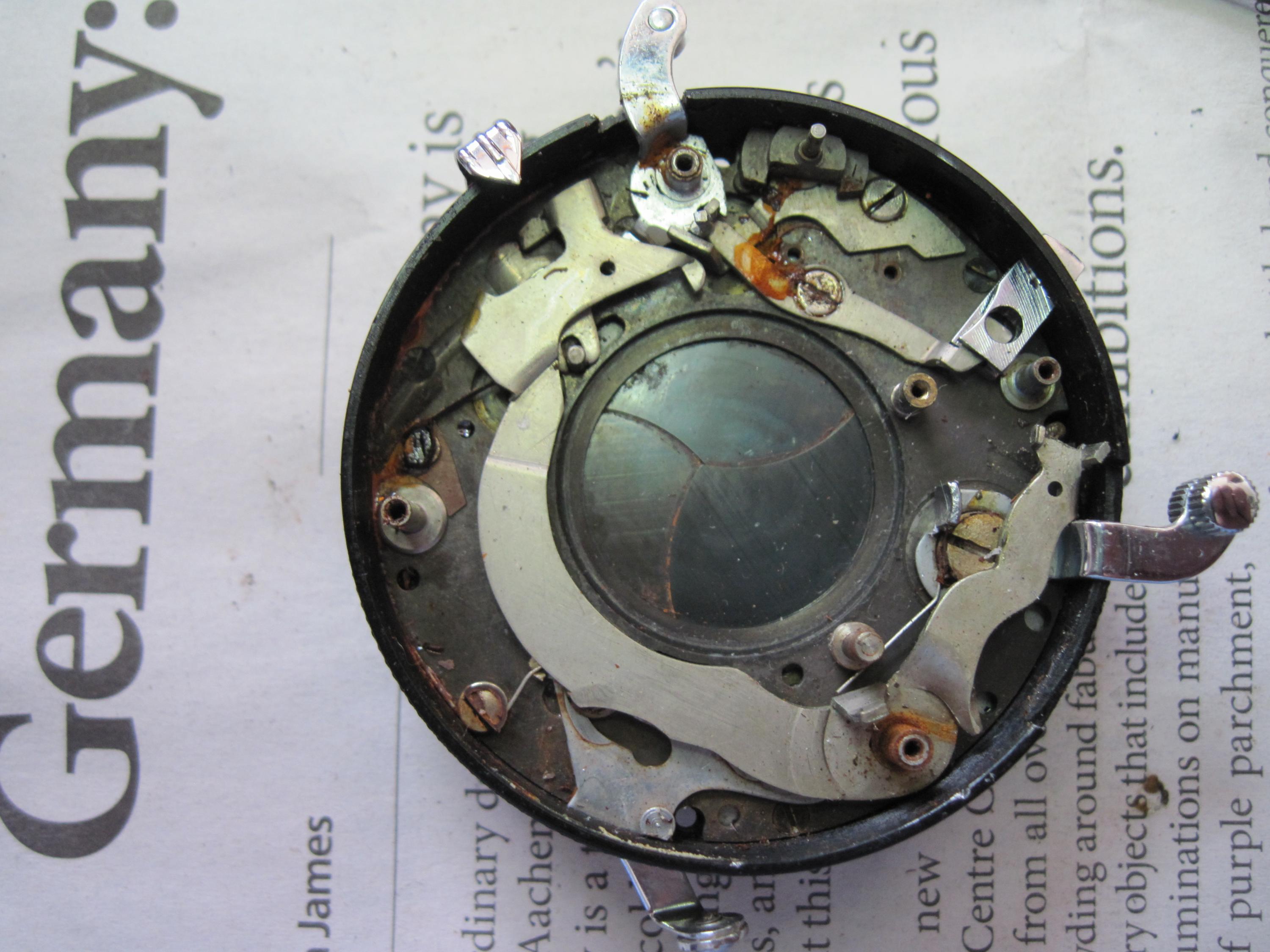

#0, correction #1 Graphex w/101 Optar, left cocked and the shutter blades rusted together.
I'll post the speed test in a few days when its back working.
After a short soak in cider vinegar the top plate was removable.

Its a #1 Graphex from 1939-1946 without flash sync. It came on a Miniature Speed Graphic lens board.
The main cocking spring and high speed springs only have surface rust and are quite strong.
The only mystery is was the name plate screw, a #0 or #1 3/32 inch long, stuck in the shutter blade path along the outer edge of the case the cause of the jam that resulted in bad storage and the rust or something that occurred afterwards. The bits of paper towel were definitely after, an attempt to get it going by wiping the shutter blades.
And yes I may sell it after I get it running, like new? I doubt I will do any filing on the speed ring.

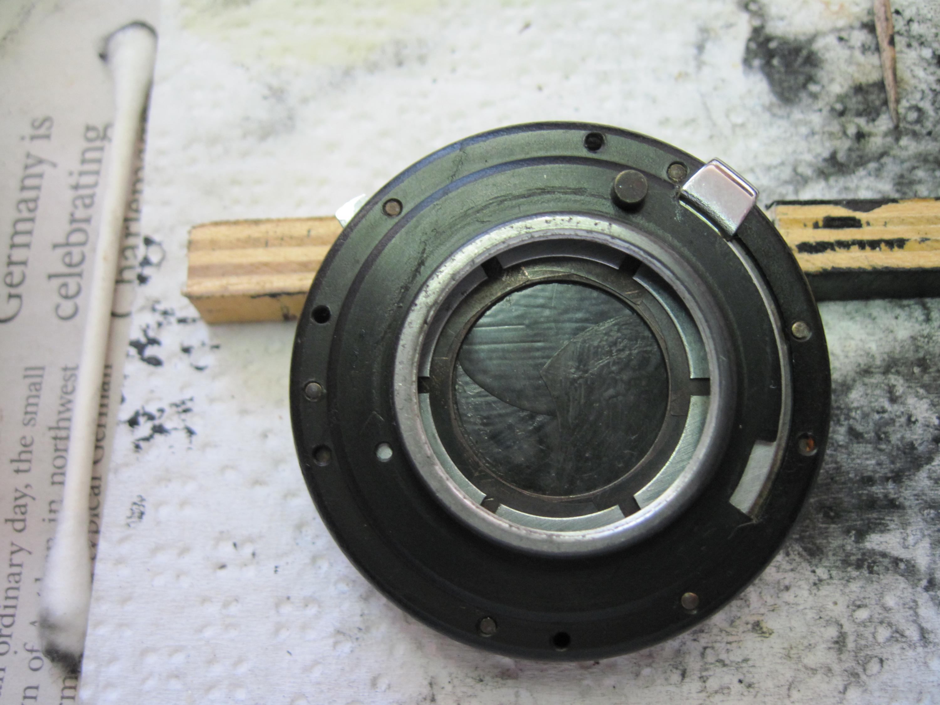

The shutter blades had rusted through leaving a thin circle at the outside edge of the shutter opening with the blades closed. They would not accept solder after cleaning so I have painted them with Golden Heavy Body Acrylic Artist Paint #1040 carbon black. It is diluted 30% with water. It dries to a plastic like flexible coat that does not crack or flake. The clearance between the shutter blades and the shutter plate is .0015 inch when assembled. If sufficient clearance had been available I would have bonded unprocessed film stock to the blades. The shutter blades are .003 thick metal. The paint will be rubbed down as needed to get the blades to lay flat against one another and to operate smoothly.

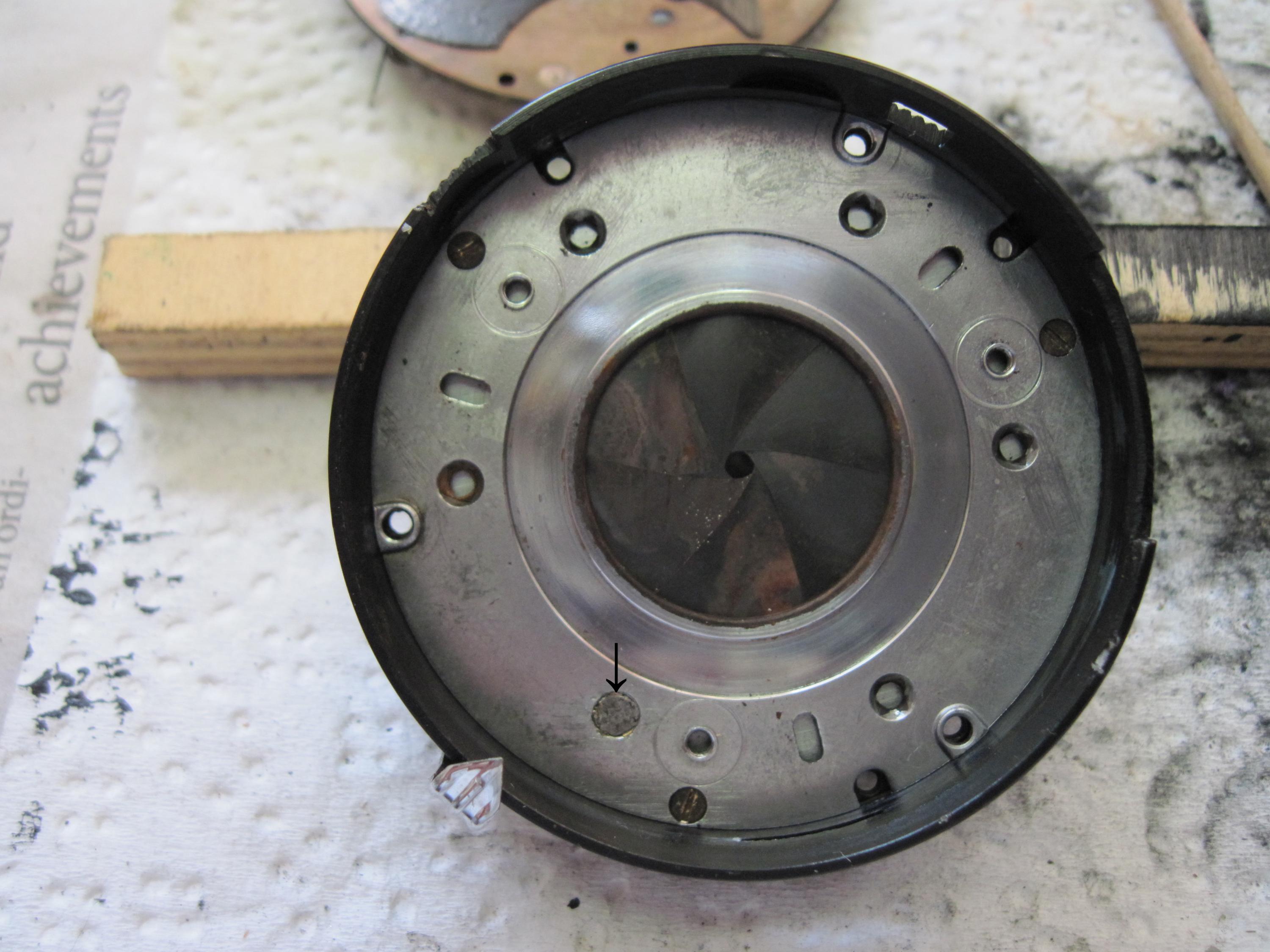

The aperture blades are a copper alloy. The pivot pins are formed by a punch cutting a 4 or 5 section that forms the hole and the edges turn up then are flared out into the aperture plate hols to retain them. All but 1 of the upturned pieces had broken off one aperture blade. I checked it and found the blade hole to be a #50 drill bit, .070 inch. The aperture blades are .003 inch. The aperture plate hole .076-.080 inch. I rolled .001 shim stock around a #56 drill bit, .0465inch, 3 or so turns then slid it into the aperture blade hole. I removed the drill bit, flushed the bottom edge of the new brass pin to the aperture blade, clipped the top about the thickness of the aperture plate, then soldered the pin to the aperture blade at the base of the pin using a 15 watt soldering iron. When the center of the pin filled with solder I left it. Upon getting the pin in the aperture plate I used the smooth section of miniature needle nose pliers to crimp the aperture blade to the aperture plate. The blade was very tight at first but gentle coaxing got it to move and after less than ten back and forth movements the blade operated smoothly throughout its full open to full closed positions. I dressed the base of the repaired aperture blade with a needle file to ensure the adjoining/overlapping aperture blades lay flat on it.

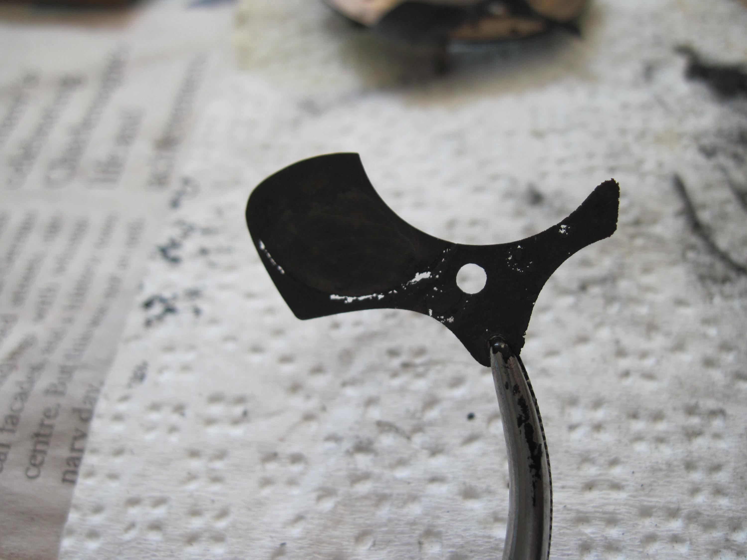

Shutter blades painted, polished with car wax, rubbed with extra fine powdered graphite, assembled, operates as specified in the manual but not as smooth as new so the fast speed(s) may suffer.
admire your eyes
I use 1.5 power reading glasses for reading, a 2 power pair on over the 1.5 pair makes the small detail as visible as it was 45 years ago. :D

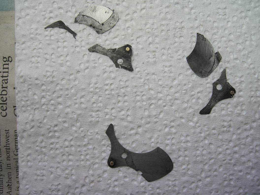

Well the pliers slipped off the end of the main cocking spring while tensioning it and hit the shutter blades breaking one off completely and separating a second along its rust hole pattern.
I went ahead and got the spring in and yes the shutter would have worked properly.
I would not have gone this far on anything but my own equipment until I have developed the technique to succeed then I would consider doing it for hire.
More experimenting and possibly making new shutter blades.
The repairable Miniature Speed will be here in a few days, I may just use it as a barrel for the lens it came with.

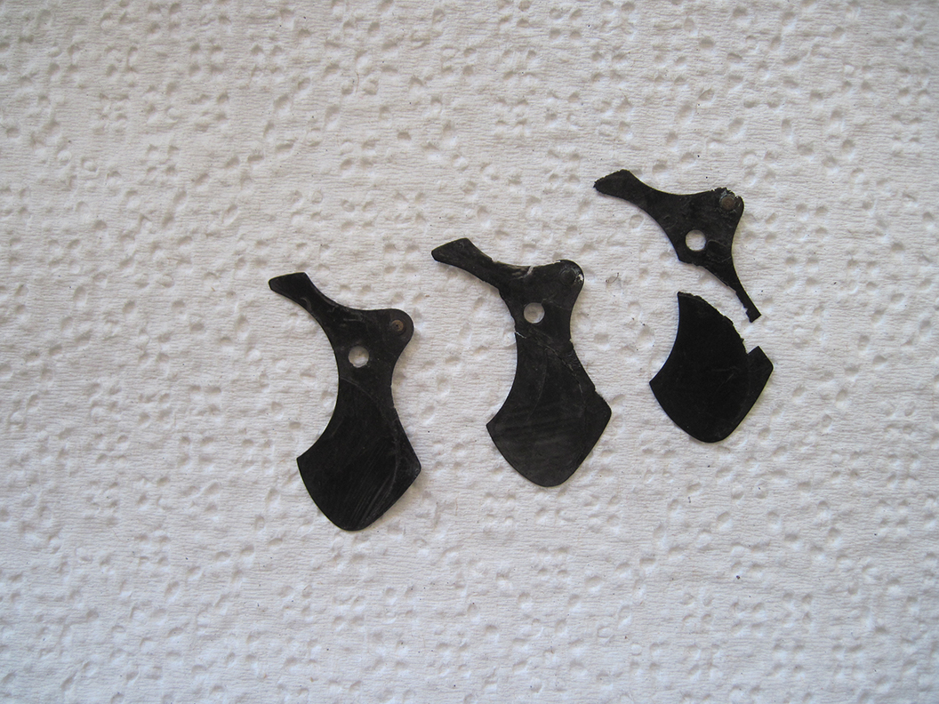

why could not new shutter blades be cut from sheet film stock or similar?
Not a dumb question. ( Dumb mistake using too small a pair of pliers which slipped off the spring 4 times prior to the near fatal to the shutter mishap.)
The material that can be used to make a blade from depends on the shutter. This one uses .003 inch blued steel? on brass pivot pin. The blades only have .0015 inch clearance between the blade and the metal plates they are between. The blade controller turns in a 45° arc and has a post that fits into a hole in the blade while the pivot pin in the blade slides in a slot.
Some shutters use fixed pins on the blade controller and plates requiring only holes in the shutter blades. Some shutters have .010 inch to .020 inch clearance for the blade to operate in.
The thinnest film is Fuji color at .0035 inch in 120 format which may not be rigid enough for the length of the blade. The pivot pin is shouldered and is a press fit onto the blade so there is no way to get it off and remount it to a new blade easily and even more difficult to make a new pin without a lathe and press.
Several years ago I made 2 blades for a Wollensak Studio shutter from Portra sheet film as that is what I had on hand that was out of date and had severe color shift. I used 2 layers gluing them together emulsion to emulsion. It worked very well.
When doing repairs such as this it is best to remain close to original design/material thickness.

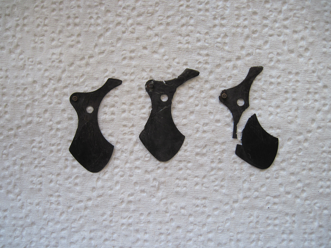

Center blade hanging together by a thin piece about the size of a thread and came apart during cleaning. Soaked in lacquer thinner to remove the paint then rubbed with a Scotch Brite pad for metal.
This thread was started to demonstrate what can be done to repair old shutters.
All gear shafts, pivot posts, lever bushings are round and is the basis for continuing the repair. A worn shutter will show wear marks or be an elliptical shape on these parts. The further out of round the worse the wear.
Wear results from heavy usage (normal), continuing to use when signs of servicing (slow shutter speeds) show up, and from poor servicing practices both of which fall into the category of neglect.
