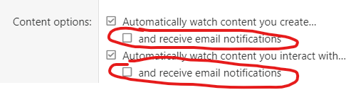

I thought I’d get an email alert if there was an answer.
Ah, no, by default, replies to a thread you make don't trigger email alerts. You can change this in your Account Preferences (https://www.photrio.com/forum/account/preferences) and look for these settings:
