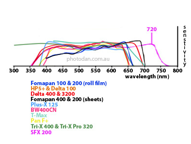

We all know film is sensitive to light outside the visible spectrum, but what are the limits? How far into ultraviolet and infrared can film be made sensitive to?
Just curious - I'm not sure if there are any practical benefits other than what we already know about UV and IR photography.

Ultraviolet up through X-Rays and infrared down to baking in the car.
AgX
Apr 5, 2007
29,973
Germany
Not quite. That spectral sensitivity is not continuous.
For instance at the UV range there soon is the obstacle of opacity of the binder, about 250nm. For IR the nominal limit is at about 1200nm, however with ultra-long exposure times something in the region of 50,000nm is possible.

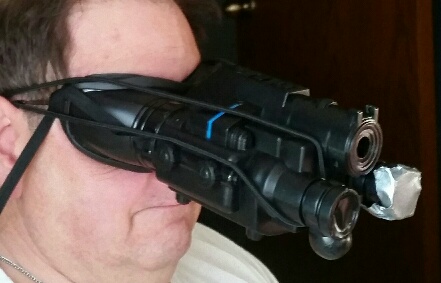

I use toy IR goggles. It has potent IR LEDS as illumination source. I can stare at any non IR film for a half hour with ZERO effects (arms length from the source ). Film manufacturers don't stumble around blind. From what I've been able to find there are areas that IR is used to view what's going on. Emulsions are brilliant white on my LED viewscreen on the goggles. Black marker ink is white, Jobo reels are brilliant white.
michr
Sep 28, 2012
440
I've been wanting a pair of these goggles myself. I hate stumbling around in the dark. What kind do you have?
mshchem
Nov 26, 2007
14,540
Iowa City, Iowa USA
Don't try walking around. Very narrow angle of view single lens, no depth perception. Jakks Pacific Spy Net night vision "binoculars " I bungee these to my head, you look like an idiot, but no one else can see you . I can read the part numbers on Jobo stuff. Amazing toy, around 60 bucks.
michr
Sep 28, 2012
440
Awesome, thanks for responding. Those googles look like pure science fiction.
michr
Sep 28, 2012
440
The duct tape is covering the LEDS that are near IR.they put out dim red light . The other LED array is pure IR. No problem.
Good to know. Did they fog film before you put on the duct tape?
mshchem
Nov 26, 2007
14,540
Iowa City, Iowa USA
Nope, I didn't try . I have a IR flood light that I tried for a while ,but I went back to the built in. All the security stuff now you can get all kinds of things.

So with presently available or specialty film stock, the answer seems to be 250nm to 1200nm with 50,000nm in extreme circumstances.
