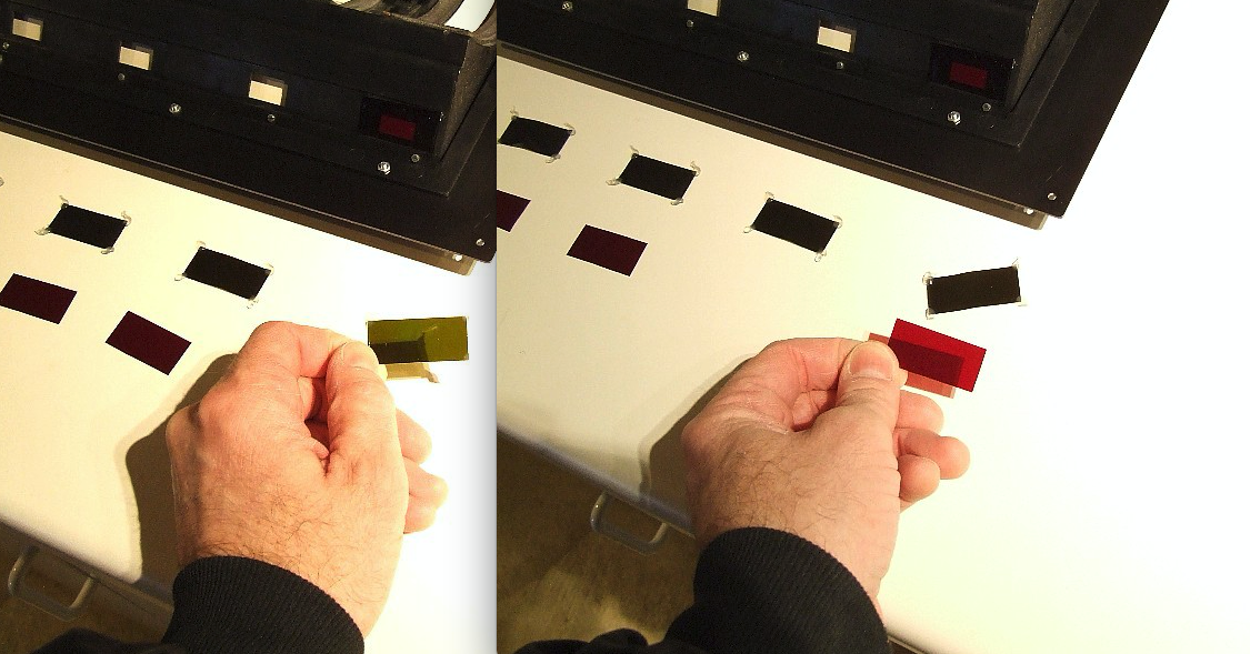

I replaced the somewhat olive-colored filters over the indicator numbers with red filters, since I only use the head for B&W printing. Otherwise, for color printing, I'd keep the olive filters but have the trap door closed over the lights most of the time unless I'm doing a quick peek at the numbers.
