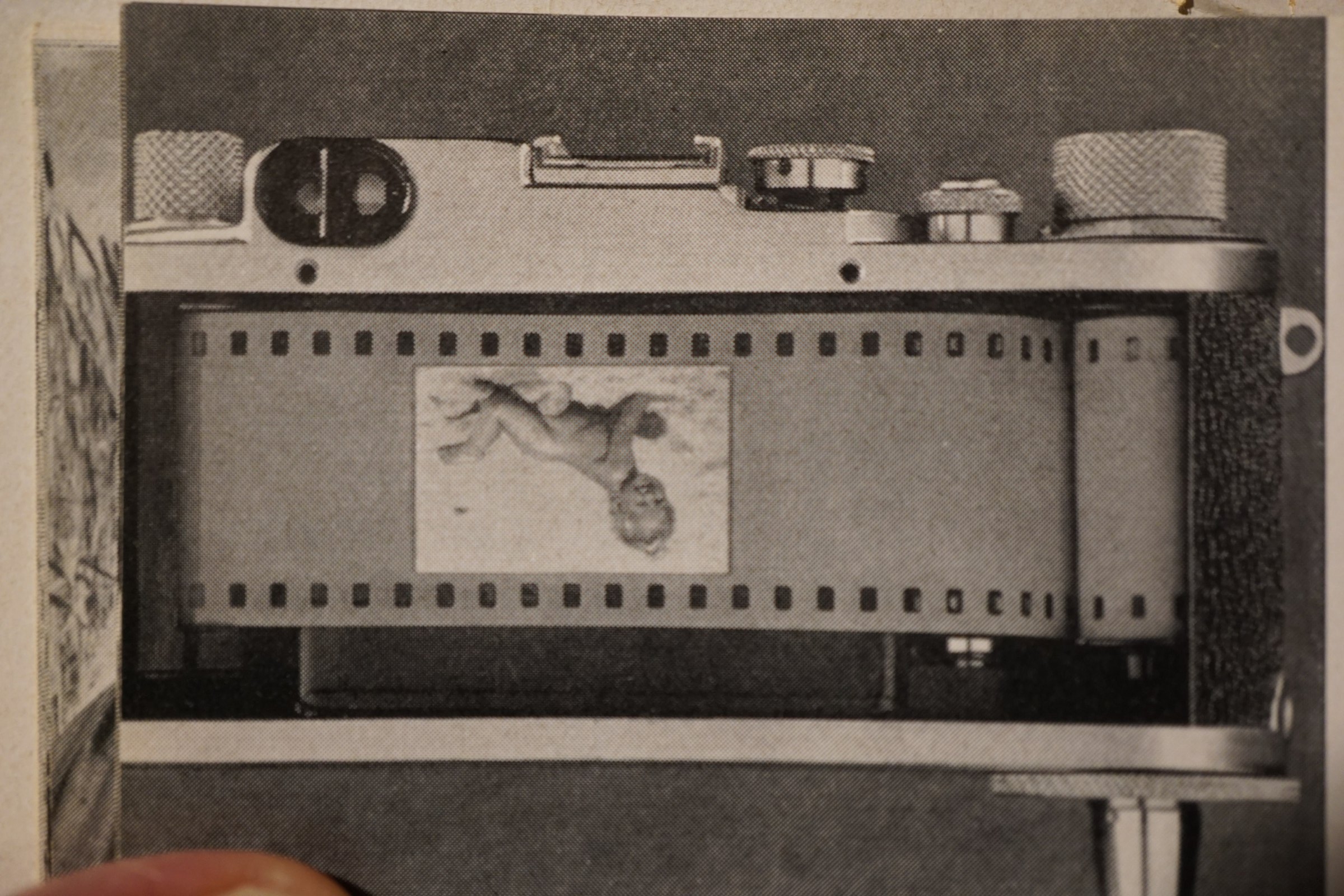

There are no sprockets at the cassette end. There is nothing to stop the cassette moving up and down if it has freedom to do so. The film is not being held in place by the sprockets: they just pull it through. The attached 1952 book illustration (from Kisselbach's Kleines Leica-Buch, page 20) shows what I am talking about.

There are no sprockets at the cassette end. There is nothing to stop the cassette moving up and down if it has freedom to do so. The film is not being held in place by the sprockets: they just pull it through. The attached 1952 book illustration (from Kisselbach's Kleines Leica-Buch, page 20) shows what I am talking about.View attachment 350741
If the sprockets are pulling film through the film gate, wouldn’t the film be properly aligned at the film gate? Perhaps not! I just find it interesting that nobody that I know among a host of Leica users ever mentioned this as a problem, although during 60 years using Leicas I have managed to create other unique screwups. I never had to insert anything to raise any cassette, no matter the film brand.

It's not an issue with Canon, Nikon, or Contax. It is, however a very well known issue with Leica thread-mount cameras. Your experience is super but it doesn't trump the experience of virtually everyone.
I still believe it’s due to human error.
It is due to the difference between the height of a Leitz cassette and a regular commercial cassette. Using the Leitz cassettes positions the image centred.
You should look at your negatives and see where the image is. Chances are, it's closer to one row of sprocket holes than the other.
Anyway - arguing about this is nonsensical. It's very well-established that this happens.

No. It arises simply because the earlier Leica cameras have a "higher" space to accommodate the cassettes. There is no problem with Leitz cassettes: they are "higher" than what you call regular cassettes. My IIIf has a baseplate with a flange that keeps the film up in place inside it: my II does not and needs a shim when I put regular cassettes into it. Nothing to do with loading.
I spoke of this issue, because mine was a IIIC and, the spring kept the purchased cassette film where it was needed.
