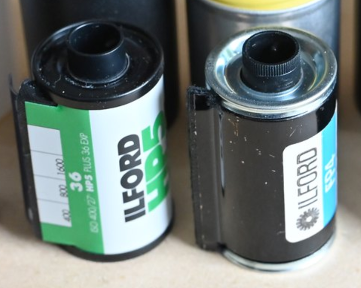

Second, experience would lead me to suspect distortion of the body, and consequent poor fit of the end caps, before the felt.
I'd normally agree with that but old Ilford cassettes have very good end-caps and the way the opening is bent makes it very rigid and secure (both sides). Normal cassettes can get a little bowed out on the flat side - but these ones don't have a flat side.
Compare:
(photo from here)
Compare:
View attachment 350427 (photo from here)
When Ilford switched to those single-use cassettes, I laid in a stock of 100 reloadable metal ones, not quite as stiff as Ilford's, but pretty good. Gosh, that must be 40 years ago now. Seems I have 51 in use and 49 new ones left, so they should see me out. Apologies that the foregoing will seem smug and unhelpful to the OP, but really it amazes me how I already had a siege mentality back then!
