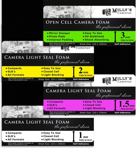

For cameras that I needed to cut foam to custom size, I ordered a sheet from Milly's Cameras in Britain and it worked well. It's inexpensive. I bought the 1.5mm thickness.

I use Jon Goodman's variety pack as well as Milly's variety pack, and slice myself with rotary fabric cutter and xacto knives. This way I get all kinds of material (open cell, closed cell, felt) and different thickness. I have too many cameras to maintain, thus buying individual kits will bankrupt me. 😂
