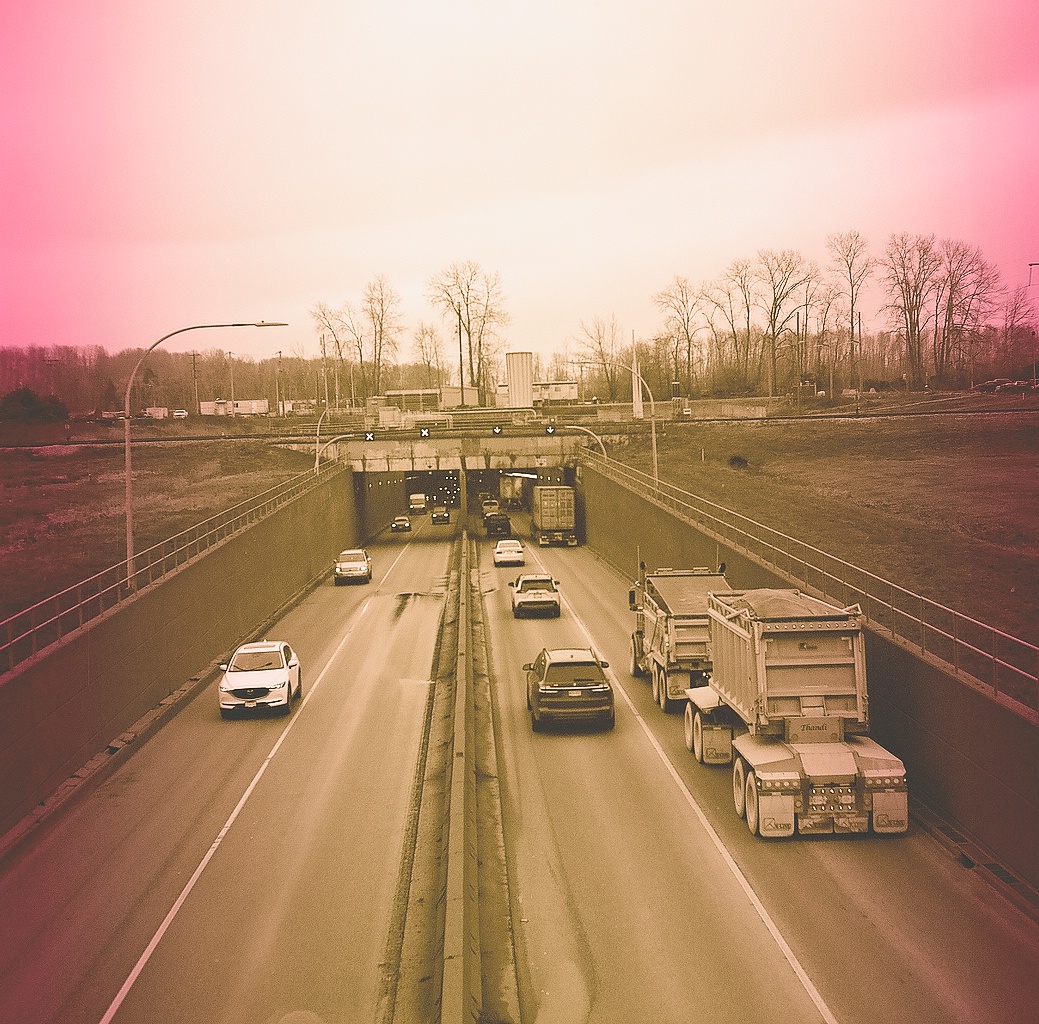

Hello, first post so go easy.
Just ran my first roll of film through new to me Mamiya C33 and have a pinkish vignetting on all the pictures. Photo lab store says it’s a light leak but I have new seals and I’ve run the flashlight inside the body in a dark closet test and can’t see any leakage at all.
Every pic had the same issue.
The film was ten years past its expiry date but can’t see that only affecting the sides of the film
Anything else to check?
Thanks in advance for the help!

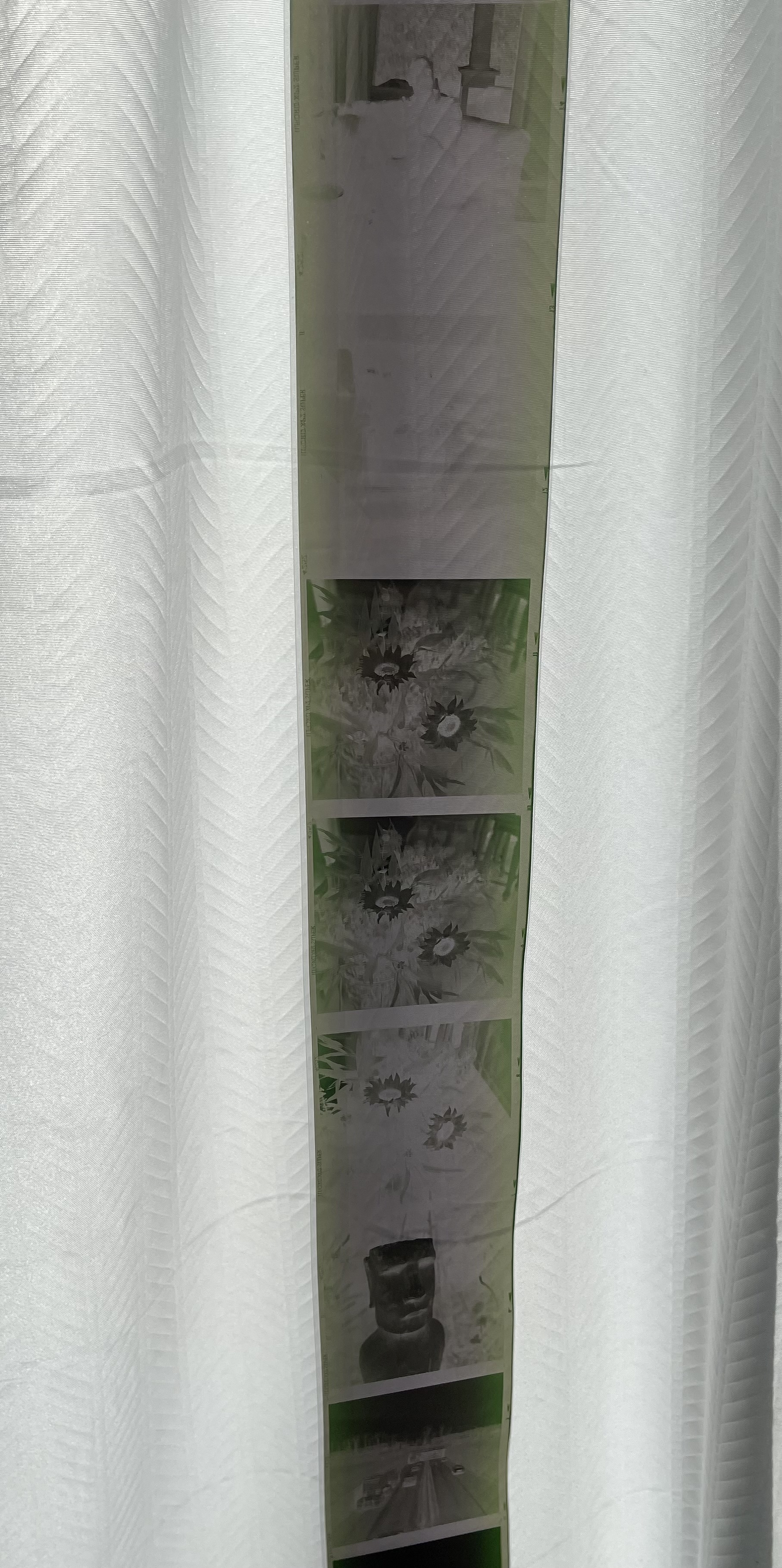

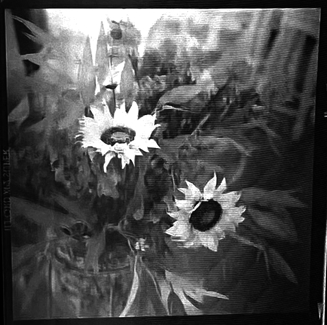

Found it difficult to get the lighting right but this should work. Backside of the negatives. Definitely a greenish tinge at the edges. Space between frames is consistent. Based on the feedback here and another convo with the camera store, it appears the culprit is expired film not stored correctly.

Kerrisdale Cameras are probably scanning it with adjusted colour negative film settings. And as a result the yellow tinge near the edges results in a colour tinge in a scanned (in colour) image.
If you work with it in black and white only, you can probably still get some use of it.
From a screen grab of your negative, inverted and then fiddled with digitally:
Complete with shower curtain induced texture effect :smile:.
A darkroom print or better scan would be a good idea. But newer film should be tried.

I used a free version of LR on my phone and was able to get useable images. I’m not worried about this roll however as it was a test shoot to get me up to speed on the C33. If my only issue is expired film, I’m good. The store told me I had a leak so I went on a mission hence my inquiry here. This has been very helpful.
I’ll attached the film box and yes, you got that correct!
Also will attach one of the pics post processing.

Yep I was going to add that when you convert to black and white the effect should be reduced. You can further reduce it by applying a gradient in the dodge or burn filter modes in an image program, or by dodging/burning in the darkroom. Sometimes vignette can be desirable in images with a central subject, so you may not even want to.
Thanks for the follow-up @abone, the negatives are conclusive in at least excluding any possibility of scanning/digitization artifacts. Given the unique nature of this film (in a way, it's a color film designed to yield monochrome images), it apparently is liable to a mode of deterioration where the greyscale balance shifts dramatically along the edges of the film that are apparently affected by some kind of oxidation process.
