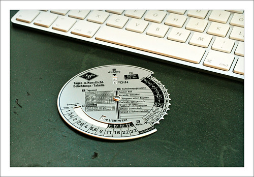

For really small, I use a calculator downloaded from Internet that is about the same dimensions as a STICK of chewing gum. Carry this in shirt pocket when carrying Minox III.

For fun, I'd like to suggest THIS as the ultimate lightweight, easy to use, no batteries, dirt cheap "exposure meter." From Fred Parker.
http://www.fredparker.com/ultexp1.htm
For about a year I carried this in the form of a two-sided laminated card. It served me perfectly. I also have a Luna Pro analog 9V meter - because, well, why not. But, for 90% of the applications where I am shooting, the paper chart works every bit as accurately. Enjoy.

This table is great to use on a Minolta 7s because you have a direct readout of the EV for a particular shutter speed and f stop on the barrel of the lens (not sure if others in the Minolta series have this too). I have a screenshot of it on my iPhone and use that as my exposure meter. A lot easier and cheaper than Wein cells.

My Konica III also has EV scale on the barrel. Nice.
