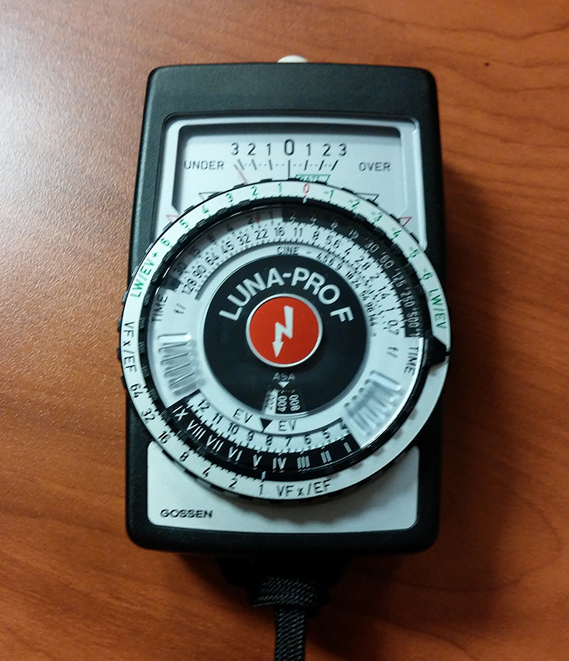

I've been using a Gossen Luna Pro F for about a year now, and you should be able to pick one up for $50-$75. It's not the most compact meter but it is light and will do incident, reflective, and flash measurements. It will also meter in very low light.
Found a Gossen Luna Pro at Adorama for $69.00, which was nice because I had a credit for $59.00.
I read the manual, and it's straightforward and concise. Thanks for the advice!
For clarity, that is a Gossen Luna-Pro F, not a Gossen Luna-Pro.
A good choice!
But if you start looking for information on a Gossen Luna Pro, you may get confused, especially since some of (but not all of) the accessories for the Gossen Luna Pro will work with the Pro F.
In most of the world, the US designated Luna-Pro F is badged as Lunasix F, even though it is more closely related to the Profisix.

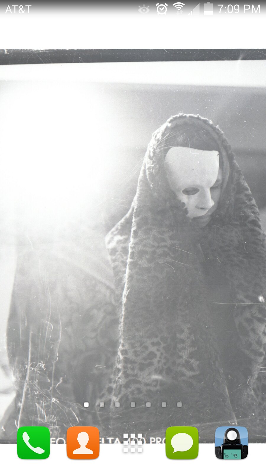

That will definitely be my back-up meter.. mine was like $3 and it's very close to the Gossen. :smile:
Cool! I use mine each time, and despite not really knowing the outcome, I think it fares well! I used it for this shot, indoors, with those spiral light bulbs, and in my opinion I think it gave me a better result rather than fidgeting with that which I don't fully understand! And as soon as I have some of my film rolls developed, I'll post the rest of the outcome as well!
