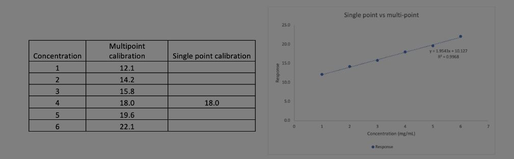

What's multipoint calibration?
  • Zero or span adjustment (one point)
  • Zero and span adjustment (two points)
  • A multipoint adjustment (three to eleven points)
For example:
I'm assuming that you aren't interested enough to wade through this, but the pictures may help for context of an in-camera multipoint metering system. In case you are interested:
For example:
Brian, That's what I thought. When I was younger working as a tech, I always checked the instrument's scale's middle, bottom and top when calibrating. If you only check one point, you may find the instrument isn't linear and will be a lot different in other spots. If they aren't you have to estimate a mean average and calibrate to it.
For example, if you use daylight and adjust to f/16, you may find that the meter is then off at the more open end of let;s say f/8 or f/2.8. So you ought to check various light conditions unless you're sure the meter is linear. Are light meters linear?
