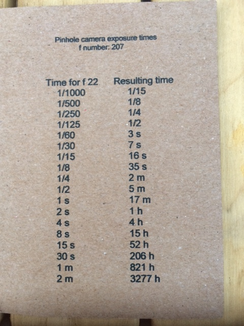

Wow! Those exposures on the card from 2 seconds upwards can't be right surely? I've used FP4 in a 35mm TTL Pentax with a lasered pinhole and the exposures were always in the ball park of a few seconds...?...
Terry S
The card came from the camera manufacturer. It is specifiuc to f/207 - an aperture much smaller than you would be likely to use with a 35mm film pinhole.
I don't use FP4, so I print my own tables using the "Pinhole Designer" program, and then shrink them down using a photocopier. I didn't have on hand an easily accessible jpeg of what I use, so decided to post the jpeg I had of the card from the manufacturer. The times on the card are similar to my table for Plus-X (which I still have a few rolls of).
There is a definite reciprocity related "edge of cliff" with all the times for all the films I've looked at. The T-Max films and Ektachrome films I've used just have that edge farther into the long times.
If you take a photo in bright sun, the times are short, and there is little reciprocity failure. If you take something at dusk - be patient.

It isn't a calculator or wheel. It is just a little card, and is specific to one film and one pinhole.
I take a reading for f/22 - my meter gives me a time.
I read that time on the table, it gives me another time to actually use.
Here is the card, as supplied by the pinhole "manufacturer (it is for FP4):
I think these numbers are actually off for a few reasons, the primary one being that a light meter displaying "f/22" actually uses an internal value of f/22.63. The same issue arises for all EVEN numbered f/stops. Those use an oddly rounded value, for historical reasons. For calculating exposure compensation, the precise value should be used. You would take the precise f/stop of your pinhole at the desired focal length, divide by the precise value indicated by the meter, and square the result. The correction factor is then multiplied by the indicated exposure time to arrive at the correct pinhole exposure.
A further issue is that the times indicated on a light meter are not the times used internally, in some cases. Times on a light meter internally follow powers of 2: 1, 2, 4, 8, 16, 32, 64, etc. A light meter will display 15 but use 16 internally, 30 but use 32 internally, and 60 but use 64 internally. The correct internal time numbers should be used or the exposure will be off.
All that considered, your table would look like this: The correction factor is the square of (207 / 22.63) = 83.67. Multiply 83.67 by the indicated times to get the correct corrected time, fixing the cases where the meter is using a different time internally: 1/1000 (really 1/1024), 1/500 (really 1/512), 1/250 (really 1/256), 1/125 (really 1/128), 1/60 (really 1/64), 1/30 (really 1/32), 1/15 (really 1/16), and similarly for 15, 30, 60, and 120 seconds. The nominal numbers are OK for direct use from the meter, but when multiplied by a large factor for extrapolating pinhole exposures, the inaccuracies multiply as well.

Don:
If you convert the variance into fractions of stops, you will see why the margin of variation due to these numerical round-offs is not statistically or practically important in the context of most pinhole film exposures.
Especially when you use a black baseball cap as your shutter timing mechanism!
DonF
Jul 19, 2016
285
Saint Charles, Il
I did a few practical calculations and found the timing error to be around 5%, which is not significant. The error does multiply, but as the overall exposure time does as well, the error remains about the same if the uncorrected values are used. The rounding of certain exposure times and f/stops produces NO error when transferring light meter reading to a shutter/iris as the variance is accounted for or perhaps within the mechanical/marking tolerance of a mechanical shutter. Electronic cameras “know” the real values, as do light meters.
Trying to keep the corrected light meter time when using an exposure time correction factor table is tedious and not worth the effort. I guess if I was going through the effort of making a table or calculator of timing correction factors, I would use the corrected f/stop values as there is little effort involved in doing so and is not confusing to the end user as the f/stop used is not obvious in the resulting correction factor or corrected times.
Practically, no real difference, I agree.
