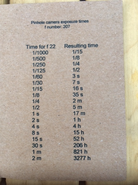

I have tables printed on to cards that have columns for the recommended exposure for f/22, the resulting exposure for my pinole (f/207) and the necessary in field exposure (to take into account reciprocity failure). The tables were generated in a pinhole related Windows program.

It isn't a calculator or wheel. It is just a little card, and is specific to one film and one pinhole.
I take a reading for f/22 - my meter gives me a time.
I read that time on the table, it gives me another time to actually use.
Here is the card, as supplied by the pinhole "manufacturer (it is for FP4):
NedL
Aug 23, 2012
3,368
Sonoma County, California
Matt, that last row is particularly useful.
My calotypes are about ISO 0.006. It tells me my exposure should be 6129.04 years. I'd better start soon.
( If we use a regular commercial photopaper negative, we can cut this down to a quick 6 years! )
I've often suggested a folding chair as part of one's pinhole kit. :D
For quite a few years now as a user of Pinhole Designer, I have taken advantage of its ability to crank out an exposure compensation table for a specific film in spreadsheet format. It can also optionally include reciprocity adjustment, although it only covers a limited selection of currently available films. The program is old and has not been updated for at least a dozen years, so some newer films are not included. And the aforementioned spreadsheet is an early Excel format, but (so far) Excel complains but opens it. It would be nice if the program could be updated for newer films and maybe even a user configurable reciprocity setup. Unfortunately the original programmer has apparently moved on to other things.
The Pinhole designer approach comes up with a multiplier based on using a regular meter reading at f/22 and applying the multiplier to the shutter speed. Given pinhole tends to be a slow process, taking a quick look at a pocket sized card to adjust the exposure seems easy enough. I have also experimentally come up with numbers for other material -- such as X-ray film.
Wow! Those exposures on the card from 2 seconds upwards can't be right surely? I've used FP4 in a 35mm TTL Pentax with a lasered pinhole and the exposures were always in the ball park of a few seconds...?...
Terry S
I don't know what film those were for, in general the table looks suspiciously like the output from the Pinhole Designer utility I mentioned upthread. In that case, the built-in adjustments could be suspect as outdated. One of my early pinhole outings used a 120 roll of Delta 100 and I was left with the impression that the published reciprocity data was maybe a little excessive. There were too many variables in the overall project to point fingers at one parameter, but I believe just recently Ilford has released some updates on their reciprocity info. For the tables I've carried in the field I have generally chopped them off beyond an hour of adjusted exposure. (It's too hard to carry a folding chair along with all the other stuff. :blink:)
