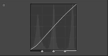

Wiltw has demonstrated that incident meter reading does not easily tie to a gray card exposure.
Because the angle you hold the card can dramatically alter the effective luminance of a gray card held in a given amount of incident light. It's a dramatic demonstration that you would need to be careful if you were trying to relate an incident reading to a gray card exposure.
But you can setup a reasonable test using a spotmeter to read gray card from camera position, and then take that picture without moving the card.
In this test, I used the spotmeter function of OM-4 to meter 18% gray of a target with several patches between 3.6% to 90.7% and seven patches closely surrounding 18%. I have marked all the patches on this graph. In the same shot I've got my dog and you can see where his eyes, ears and nose fall on the curve. The curve is from a sensitometer exposure on the same roll of film. All the marked densities may be considered to fall on the curve (but assume the test shot received the same development as the sensitometric exposure - a fairly valid assumption, however you must know that in small tanks sometimes different parts of film can receive different amounts of development).
I expected the density of the 18% gray patch on the curve to fall immediately under the -1.1 (10) mark on the film speed & log mcs scale.
Stephen Benskin and I looked at this and from the result, I conclude there is an 0.05 or 1/6 stop error in my meter (or experimental error resulting in 1/6 stop deviation between expected and actual results).

So for the short story. That graph is how I would check an exposure meter if I didn't have a 4700K calibrated light source.
