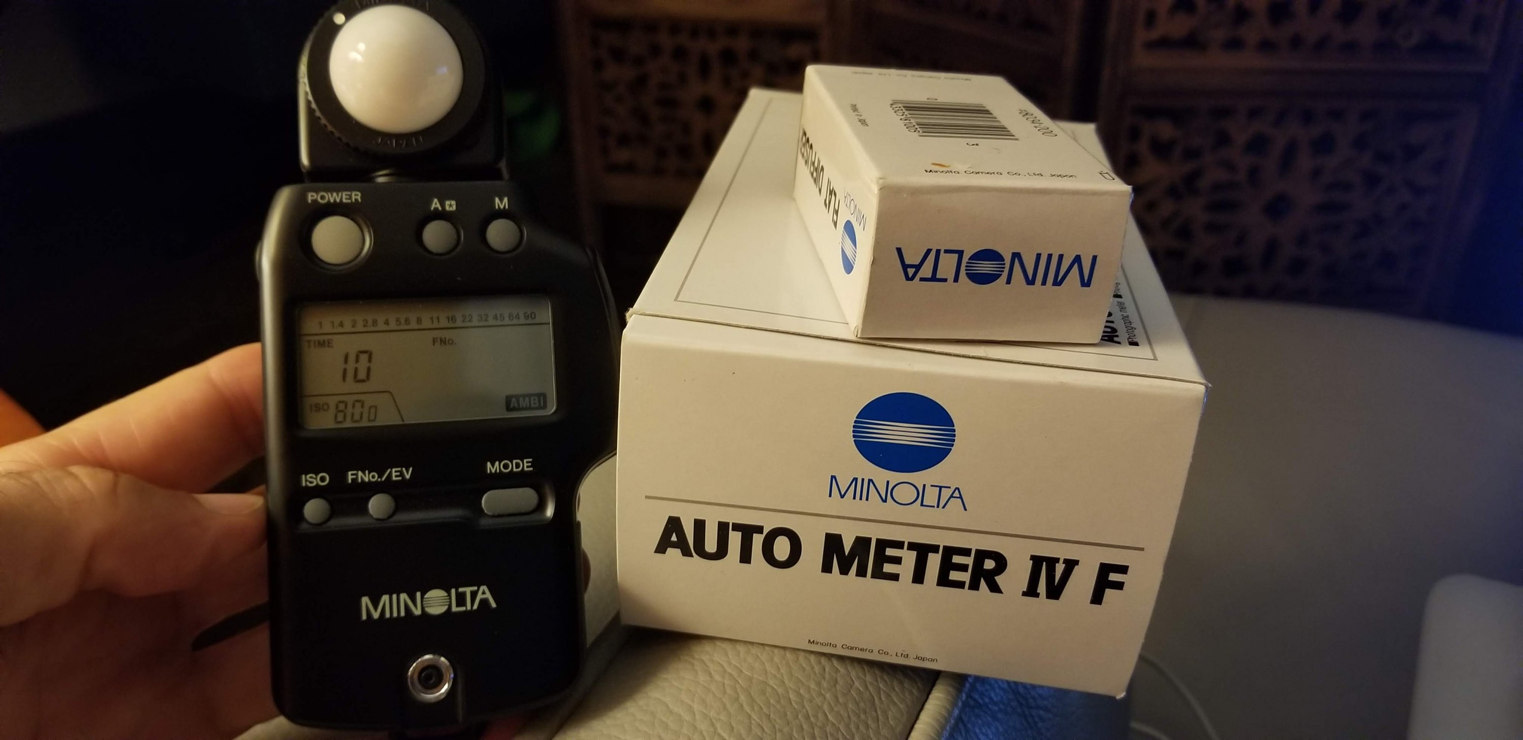

You know, after all the great advice I got in this thread... I wound up buying a used meter on Craigslist. I'm pretty happy with the results thus far...
BradS
Sep 28, 2004
8,126
Soulsbyville, California
Wow!
You found that on Craigslist?!?!?
Nice.

It's been a few years but I bought an unused Sekonic 398A (latest version) in the box with all accessories including the direct reading slides for fifty usd off of a craigslist listing. Good choice on the Minolta.
