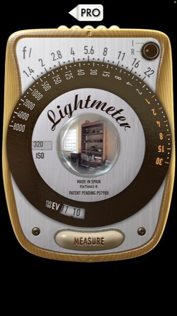

No, not heresy at all. Many of us have discovered and regularly use various light meter apps. I personally like and use one called simply, myLightMeter.
Which mode are you using it in, reflected or incident?
I have only used it to meter reflected light. I do not have the necessary diffuser for incident measurements.

Screenshot of myLightMeter, classic mode
on iPhone....
and here’s what pro mode looks like...
