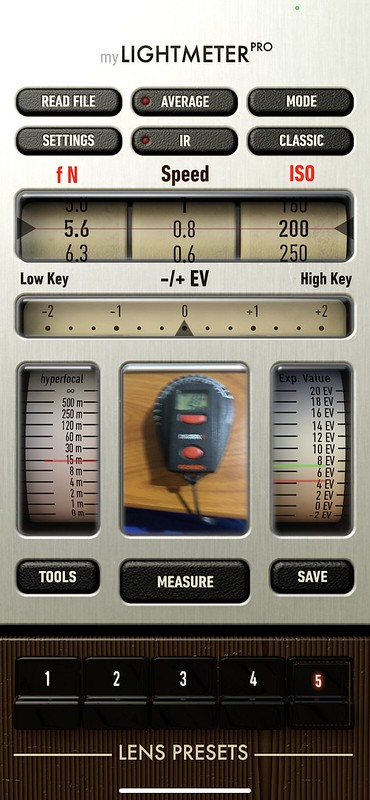

I forgot to mention that I have the PRO version of myLightMeter. Wow. Pro mode is really informative and offers so much more information and so many more abilities than an old handheld like the Vivitar 45 ever could. I think the cost of the app was just $3.99. It seems like a no-brainer to use it until I step up to a Digisix or the Voigtlander.
I like the five presets for different lenses on the Pro version. It has settings for focal length, minimum aperture, maximum shutter speed and format. The latest version even offers a setting for Daguerrotype photography.
Yep, that's it. I think it would be a great learning tool since changing those settings causes the other ones to change.
I've got a big problem with it, though.
I put 58mm, f1.4, and 35mm in the app for the first preset and measured an object. Then I measured the same object at the same distance with my SRT-101 with the 58mm lens and my Nikon D200 lens set at 55mm. Both of those cameras metered the object at 1/125th at f8. The myLightMeter app metered the object at 1/500th at f16. Huh? ISO was set at 400 for the SRT and app and Auto ISO on the D200. I find it hard to believe that my SRT and D200 are off. What the heck. Is there something I'm doing wrong with the app or is my phone not playing nice with it?
First, measure a UNFORMLY illuminated, UNFORMLY colored wall with all three meters.
angle of acceptance is removed as a consideration when such a metering target is used. The result of metering that featureless target area with all 3 meters will give you an idea of any separation of reading (or agreement of reading) between the 3 meters.
OK. I'll try that.
