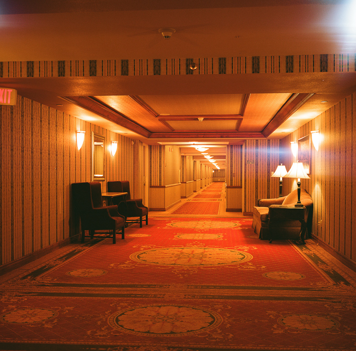

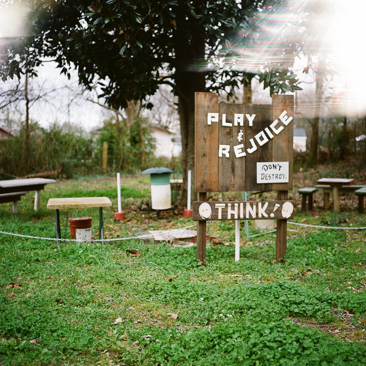

Recently I've noticed problems on the final (12th) frames of rolls run through my Rolleiflex 3.5E. What could be causing this? No issues with the first 11 frames of each roll, and also it didn't use to do this -- it's only on the last few rolls I've shot. Am I screwing up when I unload the film? I'm having the films developed and scanned at Precision Camera in Austin and I find it hard to believe that they'd be messing up. Far more likely that it's me and/or the camera. Thank you for your consideration. Joel Brouwer

This may be a little difficult to pinpoint the exact cause. Looks to be a light leak in the camera. Odd that it doesn't show on the other 11 frames. How straight/square is the camera back? Rollei backs can be bent in use and you won't notice it. Why the 12th frame only, could be that since it is the tightest wound part on the roll it has enough spring to cause a light leak, older/outdated film can get quite springy. Have you opened the back and dry-fired the shutter to look for leaks. If you still can't find the source then a trip to the repairman is in order.

Also, it could be the exposed roll isn't wound tight enough when you take it out of the camera therefore letting light leak in around the paper.

My opinion is the fact that it only happens on the last frame rules out a light leak in the camera. I am guessing the first thing you thought of was the loose roll so that probably isn't it. I don't know how labs load processing machines these day but some years ago I found a lab that did fog the last frame on every roll by something they had to do to load the roll. I would check with them even though you think they are beyond the error. It might be that they have to unroll the roll a certain amount in the process and they are unrolling it a bit too far allowing the frame nearest the outside to get a bit of light.

My thanks for your replies. I don't think I'm letting light in but maybe I am. I just sent the lab two rolls, one from the Rollei and one from my Hasselblad. If they both come back with light stains on the last frame, we'll know it's not the Rollei's fault, and that it's either my own fault or the lab's. Thanks again.

I had this problem and that was because of loose winding after finish shooting. :-( My case was even worse...

Unload your film in a dark closet or changing bag. Seal it tight in the dark.
If the problem doesn't go away, I'd guess it is the lab.
Yup. That's my vote.

OK y'all, seems maybe I've gotten sloppy is the consensus! I'll be super careful next time and we'll see. Thanks so much for your time. jb

I've got a couple of other things you might consider.
You'd know if the lab was having a light leak if you just ask them. If that was the case you probably wouldn't be the only one asking about it. Meantime, send a roll to another lab and double check.
Film tensioning at the end of the roll and leaking around the last frame? I doubt that. 120 film has a paper backling throughout the roll unlike 220 film that only has it on the front end and the back end.
Seems that if you had a tensioning problem you'd likely have flatness/focus issues on the rest of the roll that would get worse towards the final frames as the take-up spool collected more film and it was so loose that the pressure plate couldn't keep it flat. I think that light leaks from failing to tension up the film after downloading produce far less consistent results then what you have here.
Finally, try unloading the camera in a darkroom or light tent. If the finished negs/slides show light leak, then it ain't your technique but that would point me to the camera and how snug the film is being wound. Seems like you've covered all the other bases except one:
As the take-up spool thickens towards the end of the roll, is it twisting the take-up and pushing against the camera back? Check the spool alignment. You can take a test roll and watch it run through the camera paying close attention to what happens to the spool as it gathers up the last frames of the film. That might be a worn gearing problem.

Excellent plan. If they are both bad, it is likely the lab. Hasselblads wind things tight in my experience and are easy to remove from the insert without any unwinding. If it is only the Rollei, I'd guess that the roll is loose. I can't imagine a light leak happening on just the last frame
