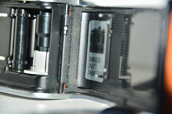

I have a problem concerning lightleaks with my Minolta XD-7 (all samples in following link: https://drive.google.com/drive/folders/16zZreX5ygkC-_nAiuSSPPMEdAqgw2GR3?usp=sharing). I have already replaced the lightseals at the back of the body almost a year ago or so and had less problems than before (i still had minor lightleaks but nothing that annoyed me too much). The light leaks always appeared at the same two spots as seen in img153.jpg. However, now they have reappeared and im unsure why. I already put a maglight to the front of the camera without a lense and checked the back of the camera and the hinges for light when on bulb but didnt see any light escaping. I also did this the other way around with a roll of film loaded and didnt see any light leaking around the film and the roll was flat. I have attached a sample of a light leak before the fix (img156.jpg) and after the fix (img342.jpg). I'm thankful for every answer and help :smile:

Hinge mount pin bent!
That is an eagle eye right there!
If you want to verify the location of the leak, put the neg in upside down and the leak area will probably hit right where the pin is bent on the edge. It is definitely coming from the bottom side of the camera. Remember, negs are exposed upside down in the camera....
To take the door off, just press that little screwhead that is toward the top of the hinge down with your finger nail. Some cameras have a plate for the hinge. If you peel back the leather on the body near the hinge and there are screws under there, then there is a plate. You could remove it and straighten it. Or just straighten it on the camera body, but I'd remove it. Check the pin too and see if it is bent.

How did I miss that geez
Eyes out of calibration or snow blind? :D

Probably just blind haha. It's with both open and closed. I had a quick check this morning but I'll go over it more thoroughly tomorrow. I fixed the crooked pin it was quite easy actually I just bent it back into position without removing the leather worked a charm. Thanks anyways huge help :smile:
yea i thought i was missing something there. i think ill just develop the next film and see if the bent pin maybe fixed my problem. Thanks though.

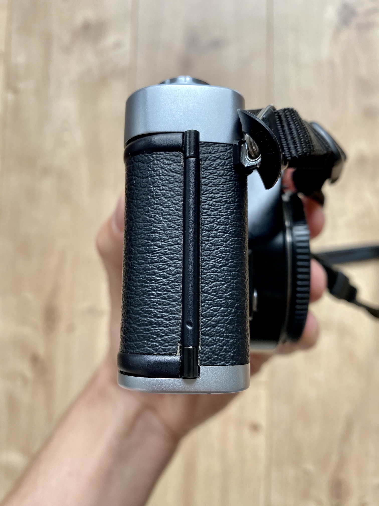

I've just got a Minolta XD-7 and found this discussion so decided to not make a new one since it's a similar topic. I haven't tested it yet and still need to change the light seals, but I've already noticed that the back door is a bit loose in the bottom left corner - you can see on the photo that the lines are not parallel. Please find the photos here: https://www.dropbox.com/sh/n81rsw3ji5w60d1/AACZIJSUe8ODaSf23EGMMl7Pa?dl=0. I can press on it to align but then it springs back. I don't see any bent parts and can't figure out the reason, is that something that could cause a light leak as well? Or can it somehow fix itself when I change the seals? Thanks!

I don't think that's a problem. It should still be light tight enough with good seals, and the cassette side is less critical anyway. Mine don't have so much play there, the door latch on yours may just be more worn.

im unsure but i feel like your bottom hinge pin is maybe a bit bent as well (i cant really judge from the photos) but i couldnt imagine anything else causing the loose back door besides maybe an entirely bent back door.

Actually you might be right, but after trying to align it with the top pin I feel like there's even more freeplay; the back door also seems to be even (I detached it and put on the table, it might be a tiny bit uneven but almost unnoticeable). I'm a bit afraid to bend it too much though :smile: So I guess it's the door latch.
The hinge pin socket at the bottom is about .025 to .035 inch out from the bottom plate and leather while the top is tight against the top plate and body leather. The back may be warped also. Remove the back and lay it on a flat work surface, the hinge and latch ends should be flat on the work surface without any pressure on the back. If they are not turn the back over and determine where the bend begins. Holding the back firmly in your hands and giving a twist opposite the warp or bend or pressing in with your thumbs on a bend area you should be able to get it to lay flat and close on the camera with equal gap on both ends and top to bottom. It will likely leak light as it currently is.
I managed to make the gap more or less even from both top and bottom - it's about 0.5 mm (0.02 inch) now. I still can't cover it completely but it's better than before. Double checked the back and it's not warped.
that looks better i believe that gap is fairly normal :smile:
Here are some more pictures. I think the top and bottom edges are equally bent out
