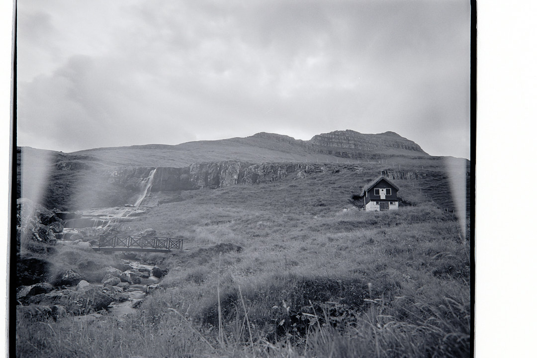

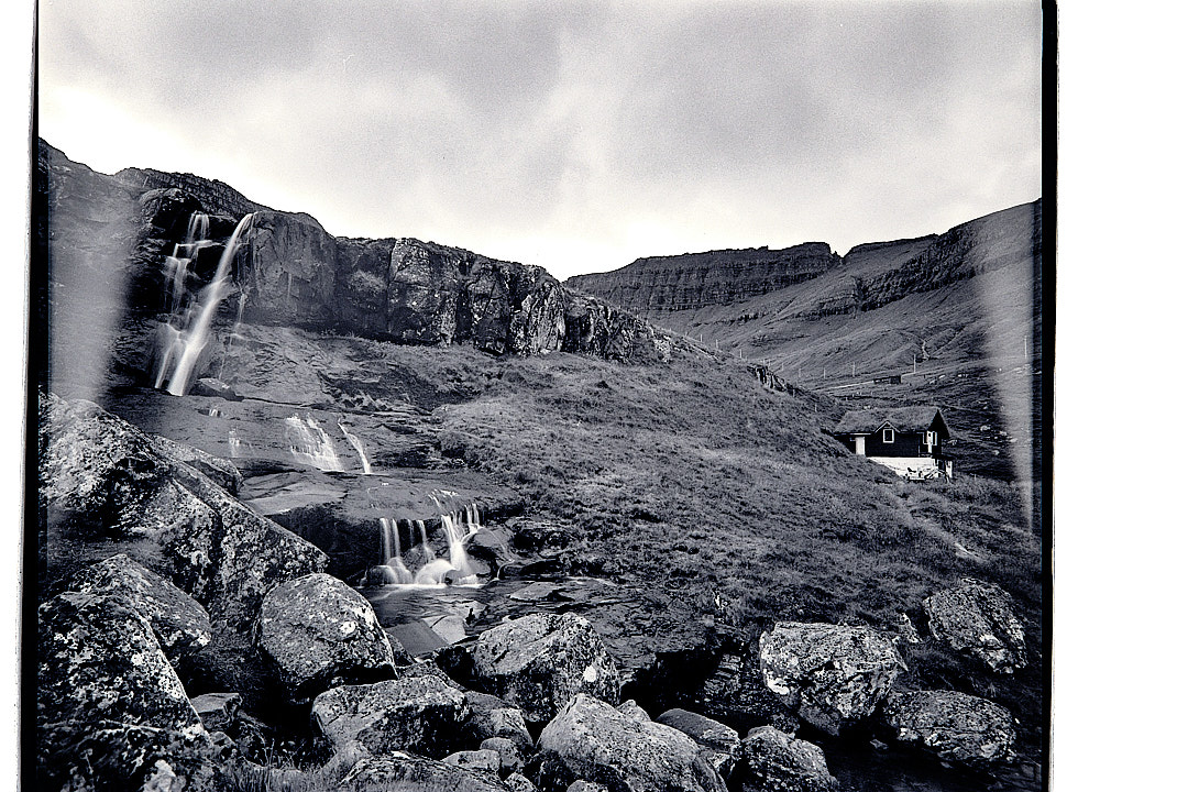

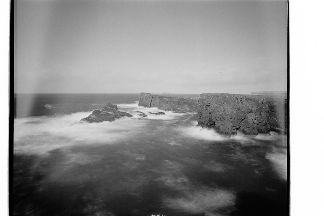

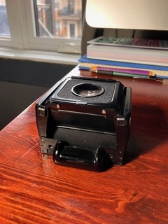

I am trying to figure out what hapenned on these long exposure shots (around 30 seconds). I was using the WLF, the 45mm lens (and a tripod obviouly). I think I left the WLF opened after focusing. Is this a known problem? Can the WLF cause light streaks on P67 long exposures ?
Thanks!

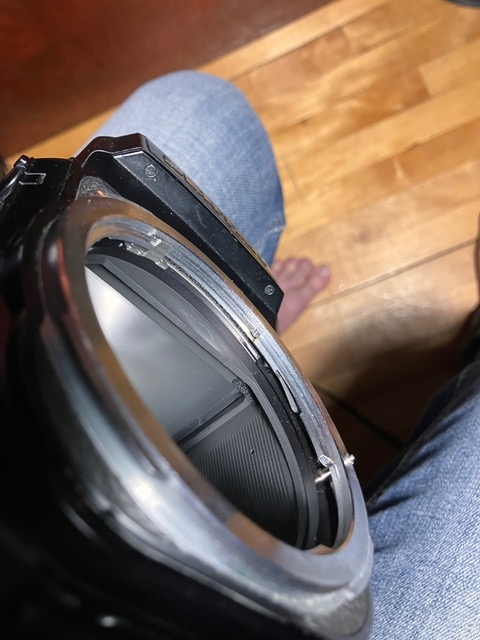

Again, is it a possibility that the problem comes from the waist level finder left "open". I know I left it open (as in the attached picture) while exposing. It didn't cross my mind it could cause a problem. Now I remember several models of 35mm reflex cameras do have a viewfinder blind for long exposures. That gave me the idea that maybe the open WLF could be the problem. Could it make sense ? Or do you use it this way without any trouble ?
Of course I can test it next time taking the same shot with the WLF opened and then closed.

WLF itself cannot cause light leaks. It's natural to bleed light onto the focusing screen by design.
It occurs to me that a different finder might block light from a problem area in the body, while the WLF lets the light through to that problem area.
In that case, using the WLF merely reveals the issue.
You could do the test folks use to find out if the bellows has light leaks on their folding cameras. Shine a bright LED flash light into the body with the lens off in. a dark room and look through the find and see if you see any leaking light. Then. do it into the finder and look into the body for the same leaks. Worth a try!
If the mirror foam is incomplete or degraded, you can get some light leaking from the waist level finder into the mirror box when the mirror is up.

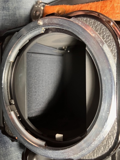

In the darkroom I removed the lens and pointed a strong flashlight inside with the mirror locked up, looking in the viewfinder. There are small light leaks through the sides. So far they had an impact only when using the WLF with long exposures, which makes sense. I attached two pictures here. One can see that the back of the mirror has the same shape as the defect in the sample images in the original post. Also one can see that there is only a tiny bit of foam in one corner. It has a clear cut and doesn't seem degraded. It looks like something to dampen the shock of the mirror, but I don't know. Is there really supposed to be foam all around ?
Also, I can see very faint light even through the "black backing" of the mirror when in up position. Is it normal? It's a strong flashlight and I place it very close to the thing.

BTW can you confirm that there is foam just in one corner on your copy, as per my photo?
The other solution would be to put your black baseball cap over the finder during long exposures - unless you are already using it to shade the front of the lens from flare :smile:
Yes, rectangular piece of foam on the top right only. Mine has completely degraded.

The P67 leaks light from the VF screen to the inside of the camera when the mirror is up. You can test it yourself by raising the mirror and shining a light at the screen.
The leak is small so this is a concern only for long exposures times AND when the screen is left exposed in a high ambient light setting. Plus if you look at the OP's pics, the leaks aren't affecting the rebate area, meaning the source is in front of the shutter. This excludes problems with the door or rolls.
PS. the folding and chimney finders show 100% of the screen.

Summing it up... It happened outside in strong light with the WLF left open with relatively short long exposures (between 20 to 30 seconds) and using mirror lock up.
One can see by comparing the sample images from my original post and the picture from inside of the camera (one can see the up mirror forms a slight angle and is not perfectly parallel to the sides of the blocked area...) posted later on that the shape of the leak confirm the leak is coming from the focusing screen. Inspection with flashlight in the dark confirms it. OAPOli did the same and confirms it.
