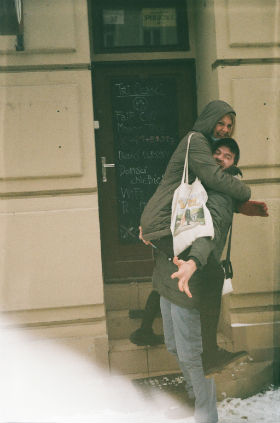

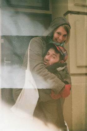

Dear photographers,
I am a newbie here, so pardon me please if I am in a wrong section of this forum, newertheles, I am confused by a light effect that started to appear on my photos and since I am an complete amateur in analog photography, I decided to ask you, wise photographers.
There are a light triangle edges on every picture, somewhere even multiplied. I thought it's something with shutter, but since the camera - Smena 8M - has leaf shutter, I don't see how this could happen. So my second thought - a cranny/crack somewere in the back of the camera (near hinges)?
I am grateful for any opinions.

It looks like the camera has a light leak. The seal need to be replaced. What kind of camera is it? Once we know that we can refer you to a repair person or where you can get new light seals.

Either crack and light leaks in camera - or light leaks during loading in developer machine. Film was developed in some local lab?
Try to inspect the camera and see do you see any damage or cracks? Which film was it (Kodak, Fuji, old or new film...)?

I'm thinking that, as you say, perhaps a light leak near the supply-side of the film path. A leak where an obstruction inside the camera is partially shadowing the leak (creating that hard-edge on the bottom).
In the left photo the camera may have been unused for a long enough period to allow the light to penetrate several layers of the unused portion of the roll. Each successive layer showing as a less dense, but identically shaped, defect.
In the right photo perhaps the frames were made in more rapid succession, such that the light fell on the unused portion only long enough to mark the topmost layer before it was moved away by winding. That layer being the one about to be rolled into the film gate for the next photo.
Just some guessing here. I could be wrong...
I'm sure others will add their guesses as well.

Gentlemen,
thank you very much for your welcoming and your ideas.
Sirius Glass: The camera is Lomo Smena 8M and unfortunately, they are not repairing it, at least in my country, since it is old bakelite camea worth 4 dollars.
Ken Nadvornick: Very clever idea about the layers of the unused portion of the roll, thank you! The only thing that is confusing me, that according the position of the triangle it must be somewhere in the bottom near the supply-side of the film path, as you said. But in that area, there are no visible cracks at all.
I will put new film and ducktape the bottom of the camera in hope it will help.
Thanks again, Sirius, Darko and Ken.

From what part of the film pictures are ? .. Beginning ? How many are defective ? Are all in sequence ?
Anyone, can be a faulty manipulation of a film extractor ?

Was the picture with 3 triangles very near the beginning of the roll? I think the leak is near the door hinge, that there is no crack, but the light is coming in between the door and the body. This camera is at least 30 years old and not robustly manufactured to begin with. I agree with Sirius, the seal - the material that keeps the light from coming around the door - is probably deteriorated from age. It can be replaced.
I suggest doing a test. Run a roll through the camera and after every few shots add electricians tape to cover one end of the door, then the other, then the top, and finally the bottom. If I am right and it is between the door and body, this will find the leak .

The first photo seems to be exposed by moving the film rectangular behind an covering edge, in a repetitive way.
Also the structure of that rather sharp shadow-edge might be telling.
What a about a light leak in the take-up chamber and staggered transport via the winding lever?

F4user: These pictures are no 15 and 16 from 36, so in the middle.
During checking the numbers i detected something strange.
1. picture - light leak
2. - 8. no photos
9. - 12. - NO light leak. Perfect pictures. Taken indoors with flash
13. - 36. light leak
pbromaghin: The only 3-triangle picture is no 15. You are probably right about the gap between the doors, since it is old and 'cheap' camera. The test is appealing. It will take me a little time to do it, but could be worth it. Thank you.
My english is quite poor so I have no idea what does it mean, sorry. The 3-triangle photo is the only one in whole 36-pictures film (but not first with the light leak and not the only one which has been taken after some time of not using the camera).
Might be, the shape is always the same with a little notch on every triangle, but I have no idea from which part it could be.
You could be right. But I don't see a reason, why the staggered transport happened once only.
I don't know either. But be at the camera or elswhere, at least once there must have been such staggered movement. Of the film or that cover.
