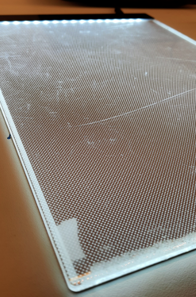

the panel is noce and bright, but the little dots are about 5 mm apart. so I am not sure how much diffusion it would need to view film. 3 brightness levels the highest draws about .4 Amp at 5Volts.
it might work OK as a tracing surface using tracing paper.
I'm guessing that you meant to post that they are 0.5 mm apart.
It is unfortunate that your panel has such a course pattern. I need to use a magnifier to clearly see the pattern in mine.
koraks
Nov 29, 2018
26,146
Europe
No, I think @cmacd123 probably really means 5mm. It's similar to mine, look here:

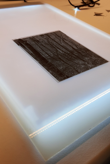

To solve the issue, I just place a piece of milky plexiglass on top of it for diffusion; I think it's 1.5mm thickness and does the job:

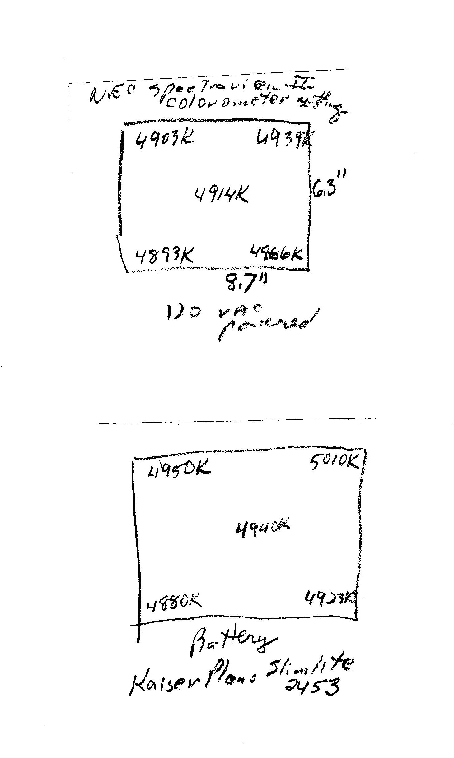

I have one of the clear translucent ones for cutting.
Dahle - 10660-12584 Vantage 10680 Self-Healing Cutting Mat, 9"x12", 1/2" Grid, 5 Layers for Max Healing, Perfect for Crafts & Sewing, Clear​
I use this mat over my Kaiser Slimlite 2453 which has a nominal Kelvin of daylight 5000K. I tested it with my NEC monitor puck and the photo below shows the readings at different areas of the light panel in both battery and AC mode. So this is also a good unit to check slide colors.
