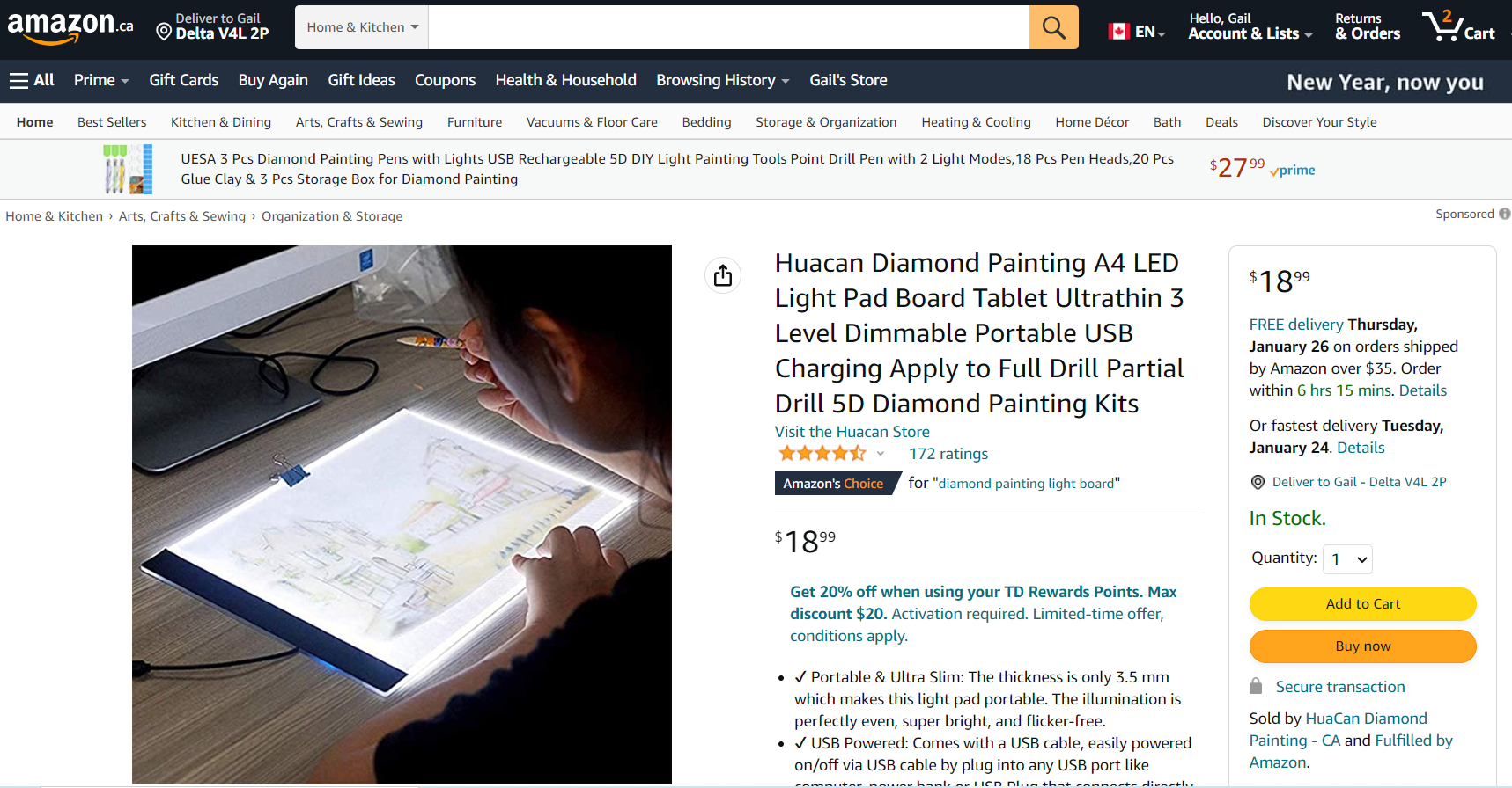

The one I use is marketed as a tracing panel.
It is USB powered.
It works well, and is similar to this:

For some reason, not everyone can see some Amazon.ca listings.
Here is a screenshot:
It is USB powered.

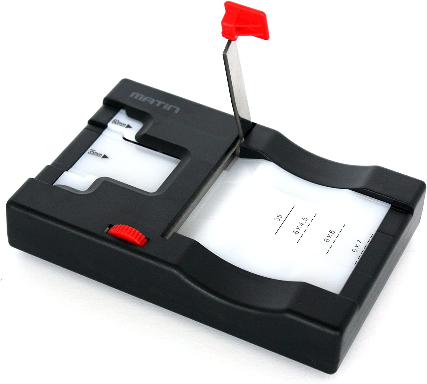

The same here, and I stick a dark red foil filter over it so to use it in the darkroom to inspect/clean the negative without needing to turn on the white light and sometimes forgetting to firmly close the paper box in the heath of the fight...
And when I have to cut, with a box cutter, the edge of a piece of film, then I lay a sheet of glass over it.

I also have the same thing, but I lay a milky white sheet of perspex on top of it to even out the light. Without it, it's a kind of a grid of very bright dots, which makes small details difficult to evaluate.

Thank You.
This is cool. Especially if I go larger than 120.
I use this for cutting and it is very good.
Sirius Glass
Jan 18, 2007
50,734
Southern California
Thank You.
How does one see where the blade will cut. If I cannot see the space between photographs how would I be able to prevent a negative from being sliced?
The light from underneath helps also just like focus i roll past a bit and than correct.

I have an older version that was probably made in the 70s. If you line up the edge of the negative with the marking for size, it gets you close. A little adjustment and the blade cuts between the negatives.
+1 - it works great on top of the light pad. The light parts are translucent.
If your slides aren't too dark, it works great with them as well.
