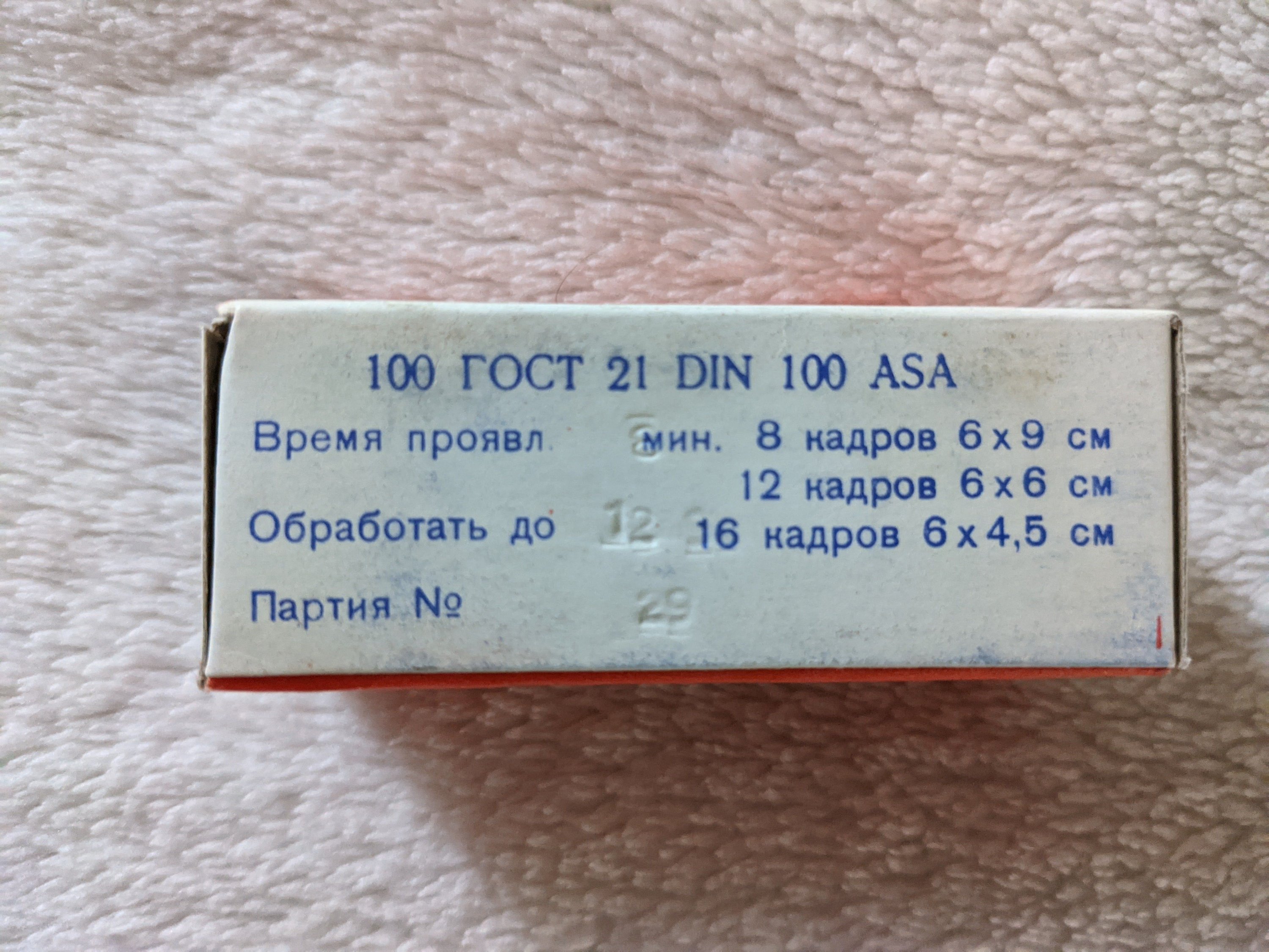

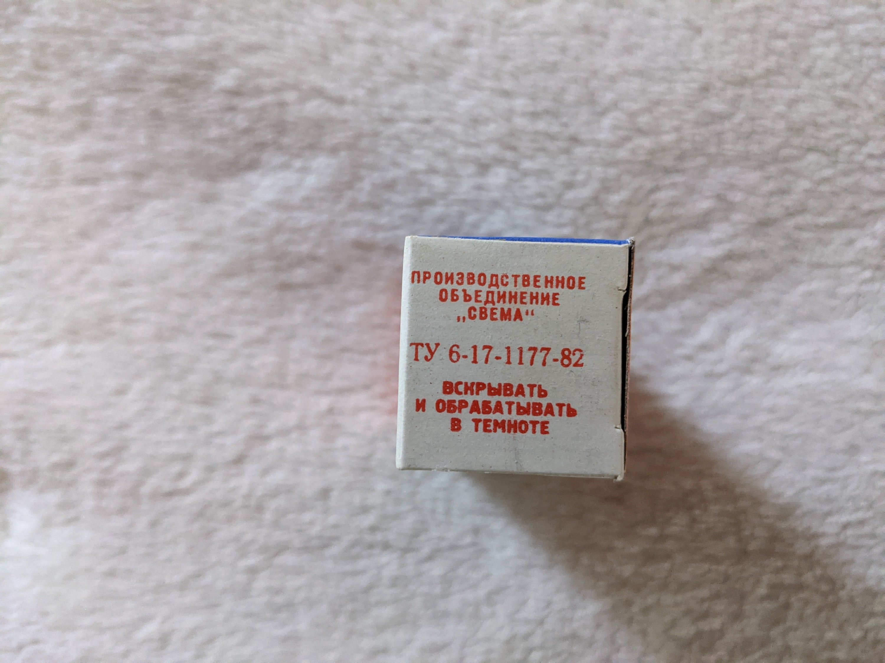

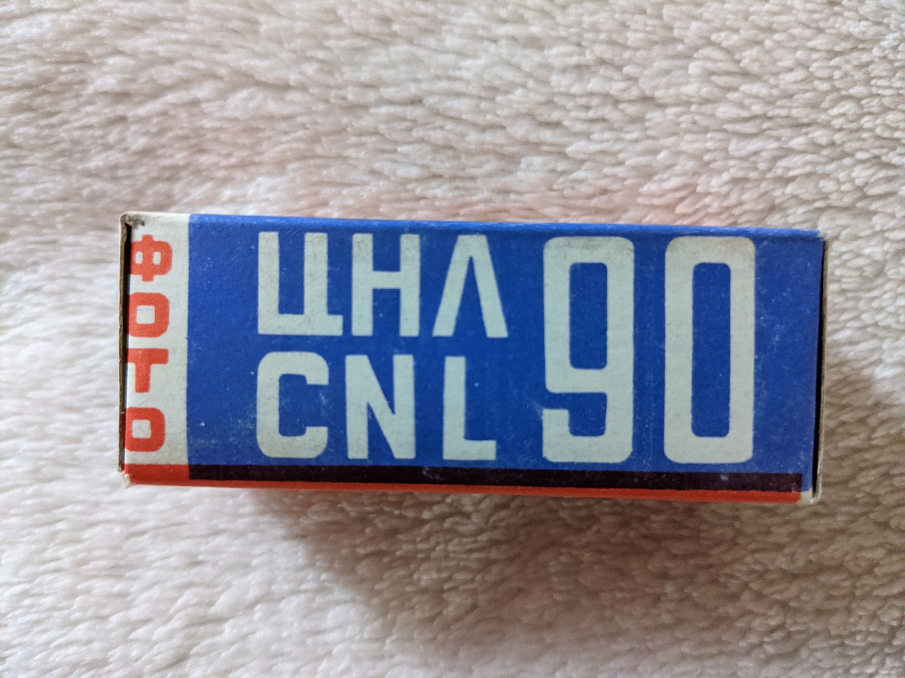

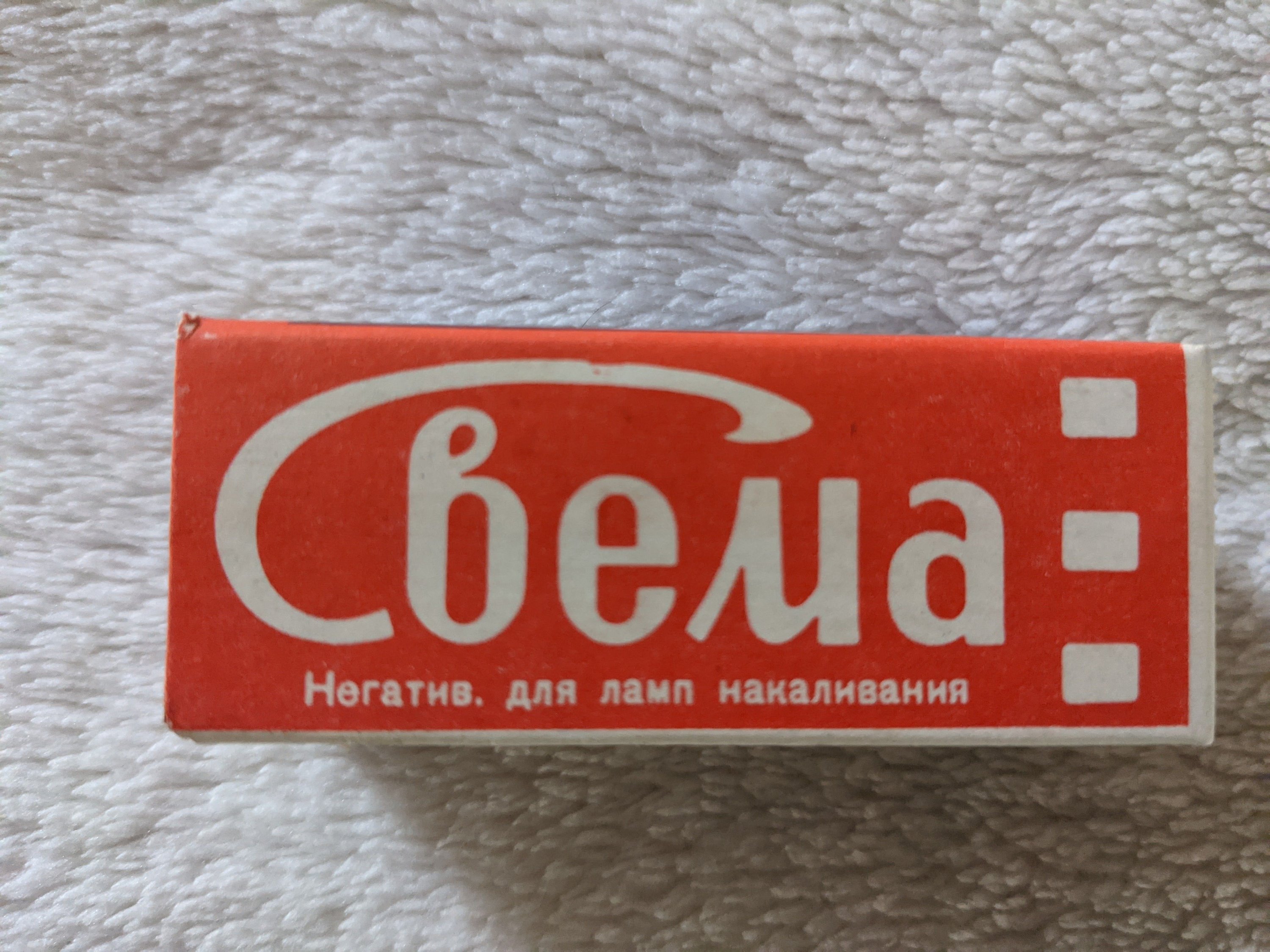

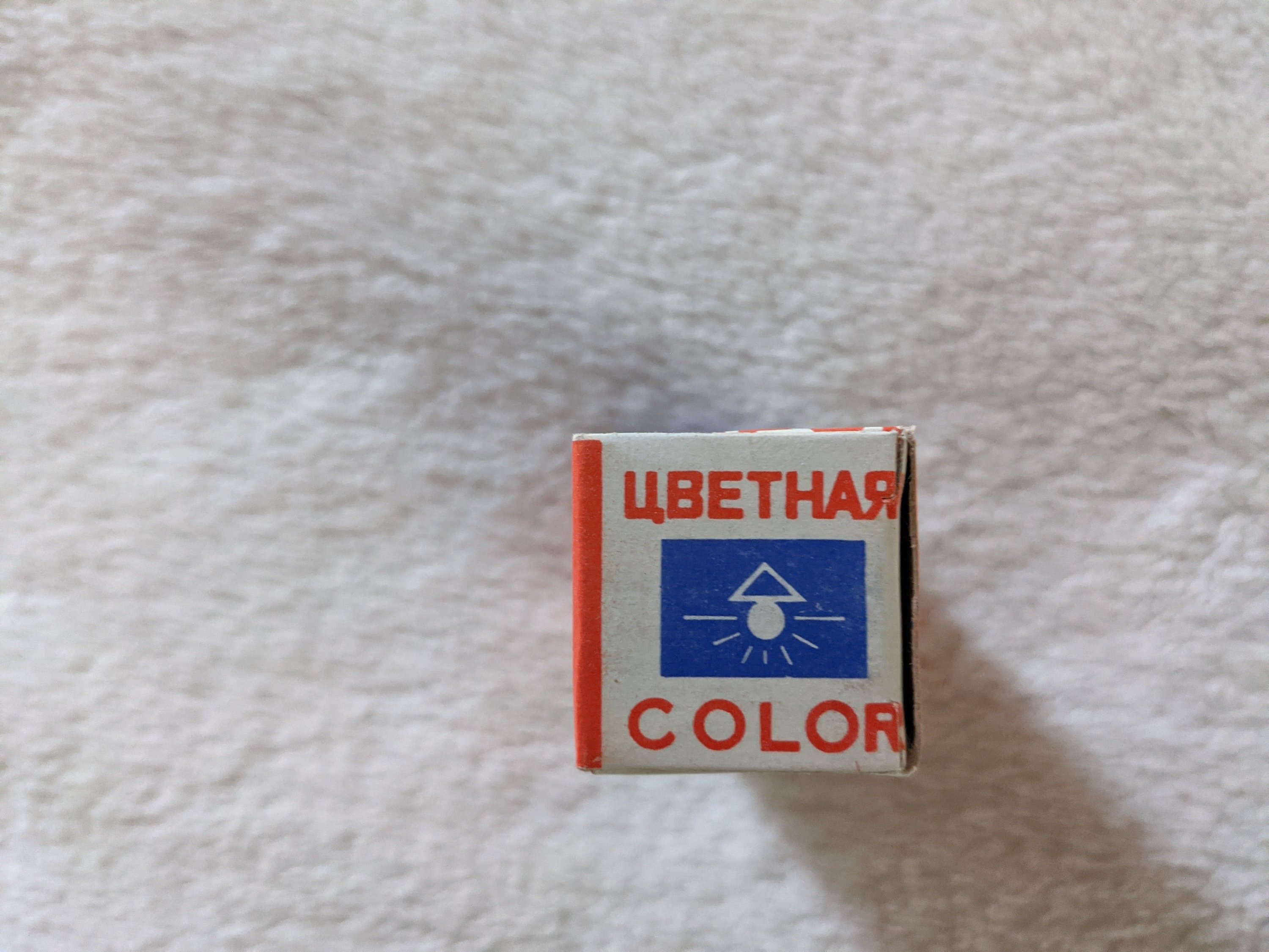

OK, I finally got some more info on this.
Since my friend is mostly a 35mm B&W photographer, I assumed the film was just that. But it's some rolls of 120 color film. When he processed them in C-41, he got blanks. Then he tried processing in 70°F B&W chemistry (he figured that if the emulsion didn't support the temperatures of color chemistry, it should at least give something in B&W) and the same thing happened.
He's coming to the conclusion that the film can't stand water (maybe he should process in vodka as it would make the film feel more at home? :D), but that makes no sense.
Here are a few pictures of the boxes.
PXL_20210602_221154084.jpg PXL_20210602_221200024.jpg PXL_20210602_221206606.jpg PXL_20210602_221216698.jpg PXL_20210602_221222601.jpg

My guess: it was blank because it was not exposed enough. That being iso100 film, it should not have slowed enough to get no image exposed at iso100. Maybe it would fare better at iso80 or 50 - but it should not be blank. Perhaps his camera is actually at fault.

My understanding is that the Colour film was similar to the old Agfa CNS process so the developing temperature would have been 20C.
As you say developing in C41 would have to be at 20C otherwise the emulsion justs melts off.
Maybe with the age of the film, no matter what you do the emulsion melts off and that is the black goo you are getting.
Out of interest, when the colour film was developed in C41 was the film base orange?
When the film was developed in B&W was the film base dark and orange looking?

Anything over 20oC will begin to soften the gelatin on that Svema film (and most of the old Agfa/ Fischer coupler type emulsions that are barely hardened) - It'll definitely run to one extent or another in C-41 at 20oC or a little below (18oC) without taking the emulsion off, which makes me very suspicious of other parts of the process being used. Temperatures that are off by a significant degree (always double check and verify with a second thermometer at least, or better still, to a calibrated reference thermometer) or a very high pH may be contributing to significant emulsion softening.
@foc I think Svema DS4 is maskless, but not sure about CNL 90 (which is more than likely long exposure corrected and tungsten balanced) - I encountered some within the last decade, but it was quite unmemorable as to the base colour.

I never thought it could be anything other than a C-41, E-6 or ECN-2 process. He says that the film was dated 1996, so I wonder if the old Agfacolor process was still in use in Russia at that time... that it would be much older than that would make sense as he says it's hard to read the date on it.
I asked him to find a country of manufacture on the box. If it says CCCP, I know it's before 1989, it's Soviet and if it's after, it's Russian. That could say a lot in terms of quality control.

When you look up the CNL film, you find an ebay listing where the seller says it has to be developed cool, has to be overexposed, you should add this and that and something else to the developer to get it to do something. Other results say the emulsion falls off at anything above 18 degrees.
My new bet is, there would have been results developing as b&w if the developer had been cooler. Colour sounds like a crap shoot.
