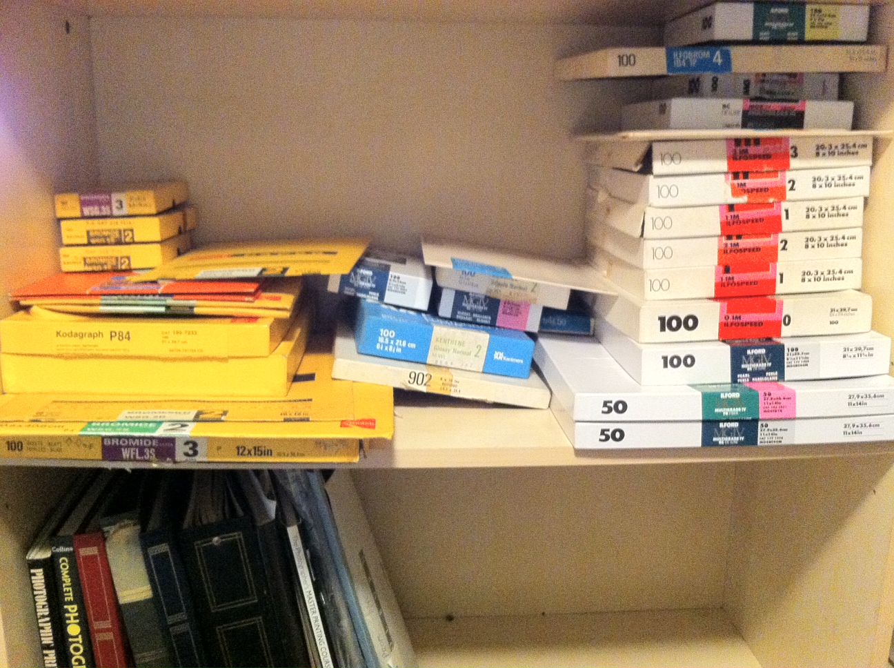

Here's a snap of the papers...the bottom 2 Ilford I already had...
Doing more tests but so far the 2 kodak papers, Bresko and Bromide are good, the Ilforbrom is fogged. papers.JPG
The absolute WORST offender in this panoply is Kodak Panalure (for B&W prints from color negatives), long discontinued but relevant to the discussion. Perfect one year and was heavily fogged the next. - David Lyga

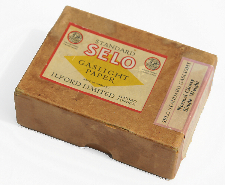

I'm hoping this box of Ilford paper (batch no 254XS) may still yield a few prints from a camera of similar vintage (& format) :smile:
Ian
Dear Ian,
The question is do you have a gaslight with which to expose it?
Simon ILFORD Photo / HARMAN technology Limited :
Bit of a spooky co-incidence this as I have today been looking at original paper labels of several dozen paper types that have been found in a store cupboard in our marketing department that were removed from the old RAJAR Photo works at the top of the Mobberley site. I have a virtually identical label in mint condition ( never seen the light of day for decades ) except it says Gaslight Postcards.
I am going to have them all scanned and put on the website, the old Rajar ones are very interesting including Rajina brand.....and one I had not heard before ILFORD Valora paper.
Simon, does Ilford have an archive of it's historical artefacts etc. The period between WWI & WWII saw the almagamation of many companies Rajar, Paget, Marion etc to form APEM/APM which along with Illingworths etc later merged with Ilford.
Ian
