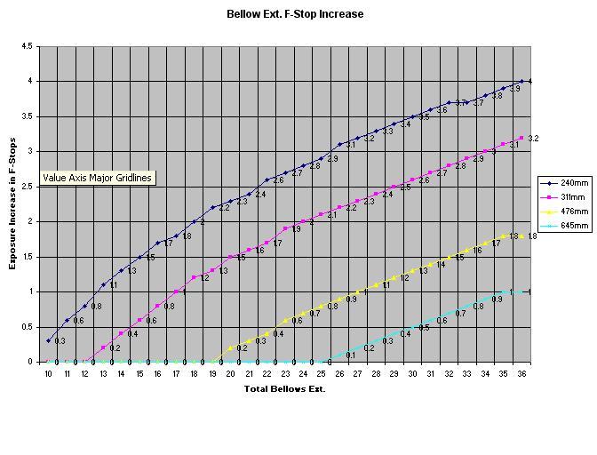

Attached is a .bmp file containing the chart, focal lengths from 240mm thru 645mm. I printed out a nice small chart in Courier New font size 8 and it will fit perfectly in my notebook.
I am also attaching a line graph of the chart for those that prefer them.
If you want something made up for your series of lenses that you use on a particular camera, let me know. I need to know the total bellows extension for the camera and the FL of each lens.
So long as the requests don't get too big, I'll make up a chart or graph for your lenses\camera.
Thanks.
-R

reggie
Oct 27, 2005
274
8x10 Format
Here is the line Graph.
