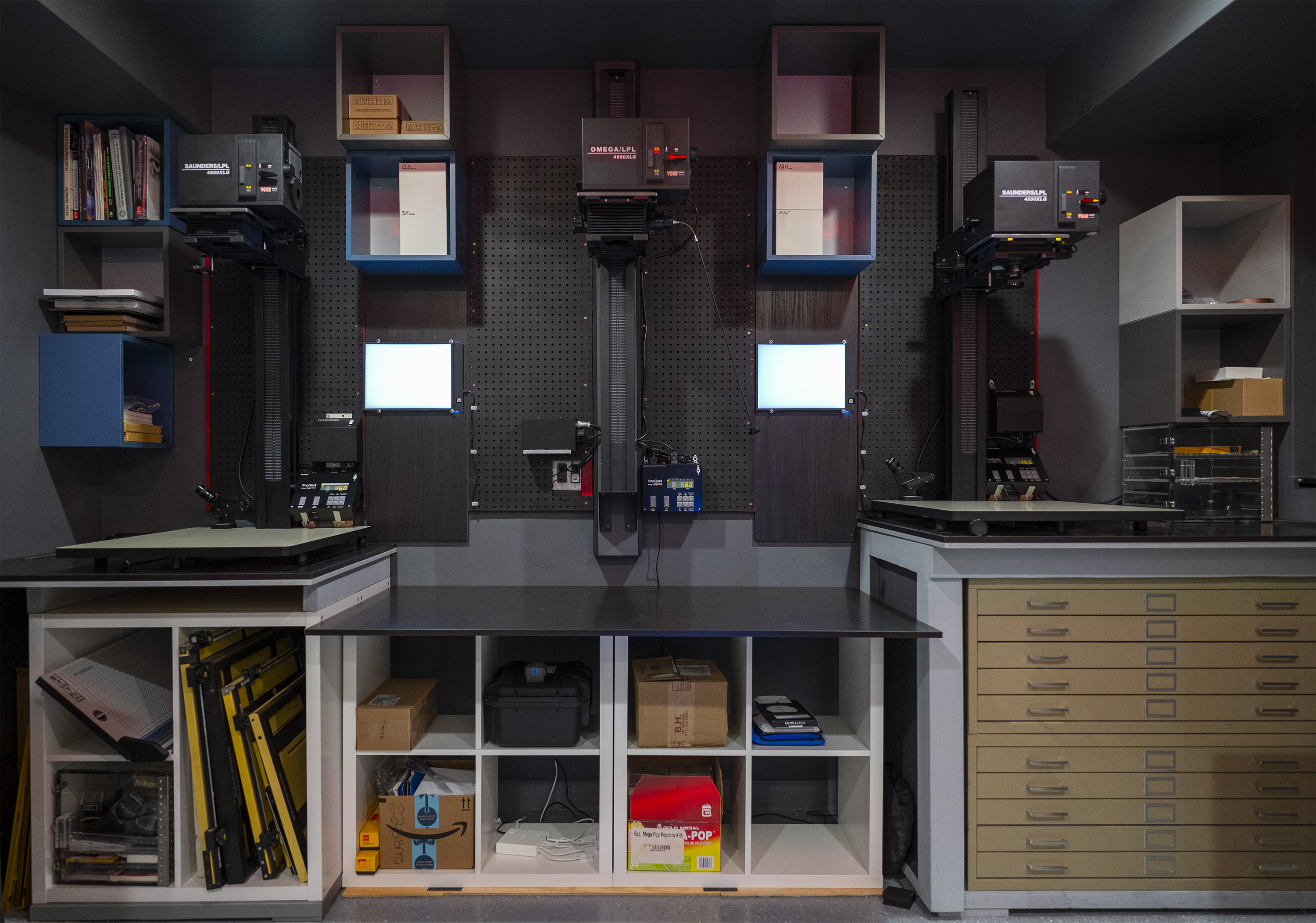

I figure I will make images and contact print for a couple years, I need to give it due time and enjoy my great set of 4x5 enlargers as is for awhile.
As for a horizontal enlarger, it just does not work in my space, I would have to completely re-design it and that is not happening. For example, the center enlarger in the photo is wall mounted. We ripped a large patch of drywall off and made a standout that is bolted into the foundation wall of the basement in 6 places, will easily handle 300 pounds. So I will be mounting the 8x10 enlarger vertically to the existing standout in order to keep that max use of height with my 8.5' foot ceiling. The easy part will be the light source and camera as purposed for the enlarger lens, the tough part will be the film stage and associated negative carriers.
I'll get there and it will work fantastic, but for now I contact print...

That is a darkroom of a sick sick mind. Not enough junk and much too organized. We might be dealing with an AI here...
Besides that -- looks great! 8x10 contacts are a great size to work with and view.

Never seen a darkroom so neat :D
Can the units below the centre enlarger be slid out ? You may want to look at a 240mm or 270mm enlarger lens rather than a 300mm as you need a lot of height enlarging with a 300mm lens. The 240mm f5.6 Componon S lenses are designed for 10x8, makes a huge difference.

The build is still in process, things have not all found their home yet in the cubbies and on shelves.
The table under the center enlarger is temporary, will be replaced with a rolling one that has an align-able top. A floor easel will be made to handle the printable area which is 46” x 64”.
The rolling table is the next big project, all last week it was finalizing wiring on the enlarger wall, including the snazzy light panels on each side of the center enlarger that are used for inspecting negs during printing sessions. I also built my film loading counter that has a dedicated vac.
And yes, it is clean and organized, the room also houses my cameras and about $25,000 in computer equipment, it’s gotta be a tightly run ship....clutter makes it hard to keep things clean.
I already figured a 240mm would be the way I would need to go if and when I do replace the center enlarger for one that handles 8x10...

Sounds good. I had two enlargers 5x4 abnd MF/35mm wall mounted side by side in my old darkroom and part of the bench top could be flush or mounted at different levels including a couple inches above floor level. Then I bought my 5108.
In my new darkroom I have a storage unit (door less cupboard) with lockable wheels that fits below the 5108's drop bed which slides out easily when necessary it goes under the computer bench as an alternative location. I agree on a degree of tidiness. My only problem is over winter the darkroom also doubles as a workshop for the cleaner parts of camera and shutter restorations and repairs as it's heated which my garage workshop isn't.
Let us see it again with the 10x8 once set up.
