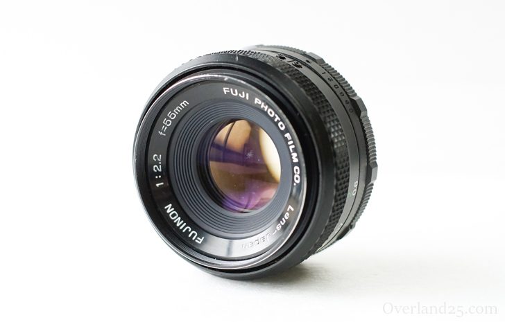

Almost each camera makers will make a standard lens for their products, from f/2 moved to slightly larger f/1.8. I have a Fujinon 50/1.8 and the only thing I could say is it did its job to call a day, like Tessar 50/2.8.
Do you like this design and the performance actually? I know there are some brilliant examples like CZJ Pancolor 50/1.8, but in contrast like Canon FL/FD 50/1.8, Takumar 55/1.8 are mostly ignored?
