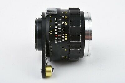

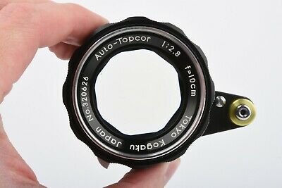

What is the name for this specific type of lens?
-Paul

Likely a Tessar type.
But these have not got that aperture anymore at 100mm, but 3.5
Well, I looked it up and it turned out to be a Sonnar type.. With a big chunk of glass.
Short tele? Exakta/Topcon pre stop down lever mount?
"Pre-stop down lever"? I do not know the exact English designation, but in effect it is a automatic-diaphragm. A external automatic-diaphragm (external concerning the camera body).
I know. That was how it worked when Exakta had to kludge it. Topcon corrected it, while keeping the rest of the mount.
You know, this could actually be a retconned Topcon lens, modded to work on an Exakta.
Early Topcons used an Exakta style external automatic diaphragm mechanism. Topcon had the shutter release on the front of the camera, like the Exakta, but instead of having it on the left side they put it on the right side - hence the diaphragm assembly sticks out of the lens to the right.
It looks like the diaphragm is semi-automatic. The silver lever opens the diaphragm and holds it open until the brass button is pushed, snapping the diaphragm closed; further travel of the brass button pushes out a prong that activates the shutter button on the body of the camera.
Assuming of course that you are talking about the diaphragm control.
If not, Mr. Racer gave you the answer, above: it is a telephoto lens.
