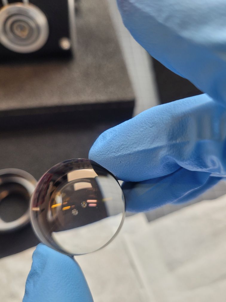

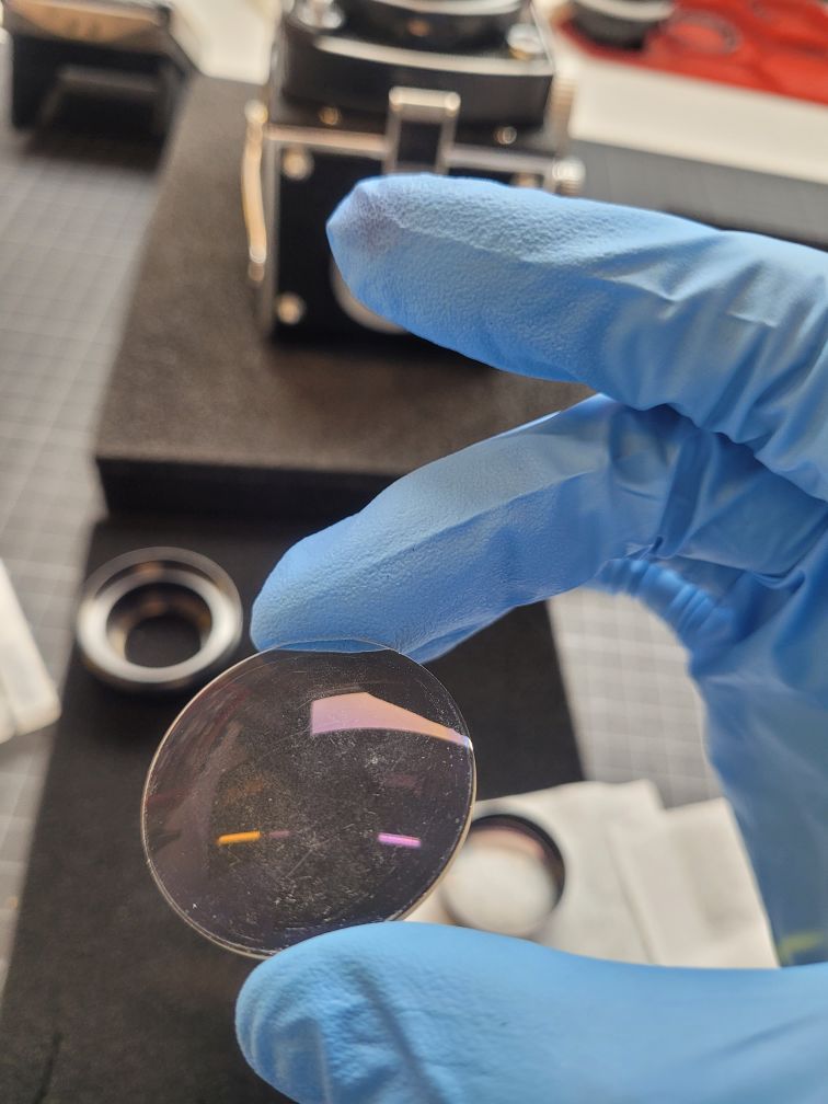

I think yes. My friend got the frontal element of his Rolleiflex restored recently. It's kinda hard to see bc he didn't take an intentional "before" pic(photo 1), but it's kinda worn and scratched, and pic 2 is "after".

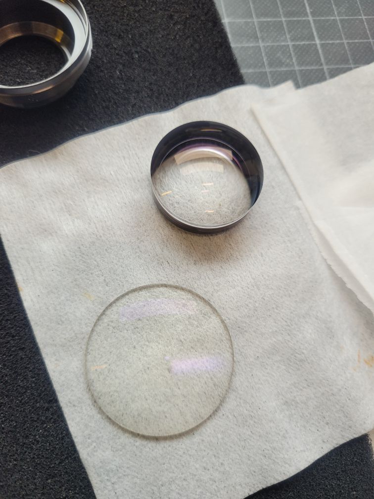

I have taken the front group apart last weekend and confirm the defects (1st lens coating wear and two point balsam separation in the 2nd/3rd doublet).
I have emailed Foto Olbrich in Germany based on the recommendation of other Photrio members and they referred me to Dr. Prenzel in Optik Labor instead but with some stark warning regarding the risk of lens cracking during re-cementing and recoating.
Personally, I think the lens cracking warning is a bit overstated. The most dangerous part is probably heating up the doublet to separate the glasses. However, I believe that due to the flat gluing surface of the Xenotar lens the differential expansion stress should be minimal. There is of course risk of stress cracking during polishing, but I would assume any optical technician with reasonable skill would know to avoid that. However, it would be good to hear from someone who actually have it done before to see whether my assumptions are reasonable.

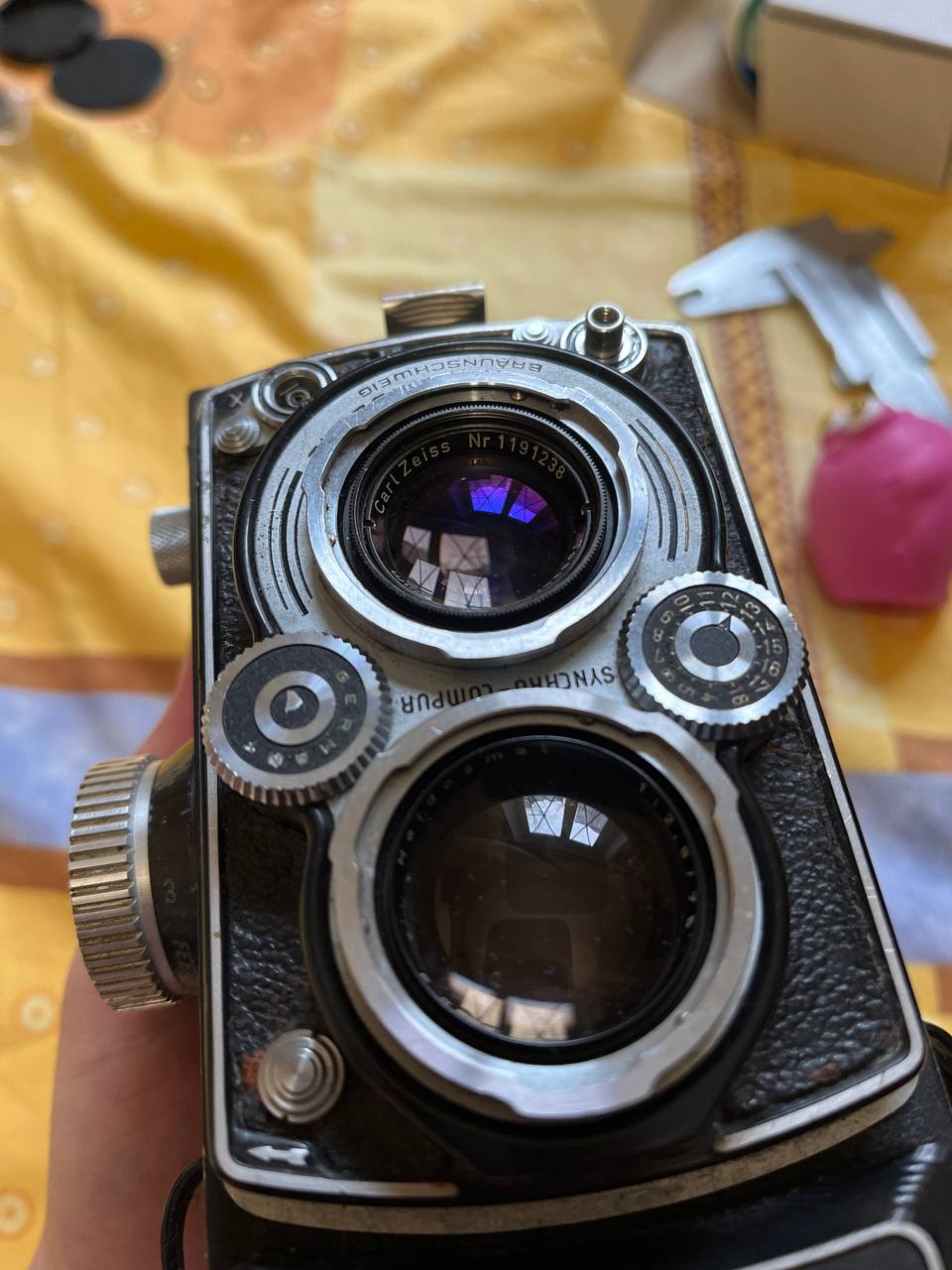

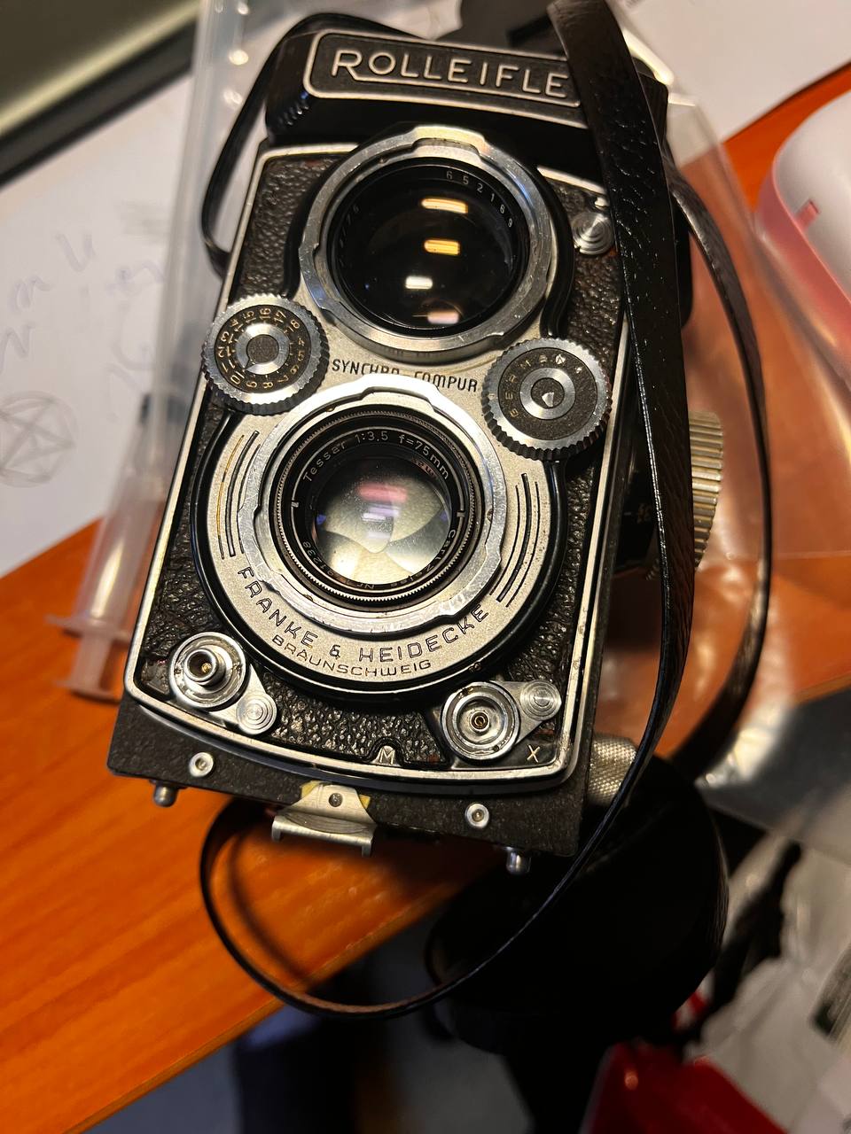

I have a Rolleiflex 3.5E with a front element of the taking lens that is so bad I think the glass is actually etched so badly that repolishing would likely change the grinding formula. Although I still have it after many years of being disassembled, i consider the camera to be a total loss. The glass isn't scratched or broken. But I still think the etching is just too extreme.
This front element can be salvaged without any problem.
The polishing process preserves the radius, and I don't think your infinity will change significantly. In any case, after reassembly, you'll be able to check this and, if necessary, adjust the lens to infinity, but most likely, you won't need to do that.
