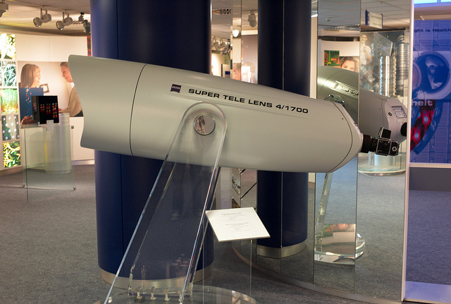

Zeiss to the rescue -- 1700mm f4 with a Hasselblad -- look closely.
