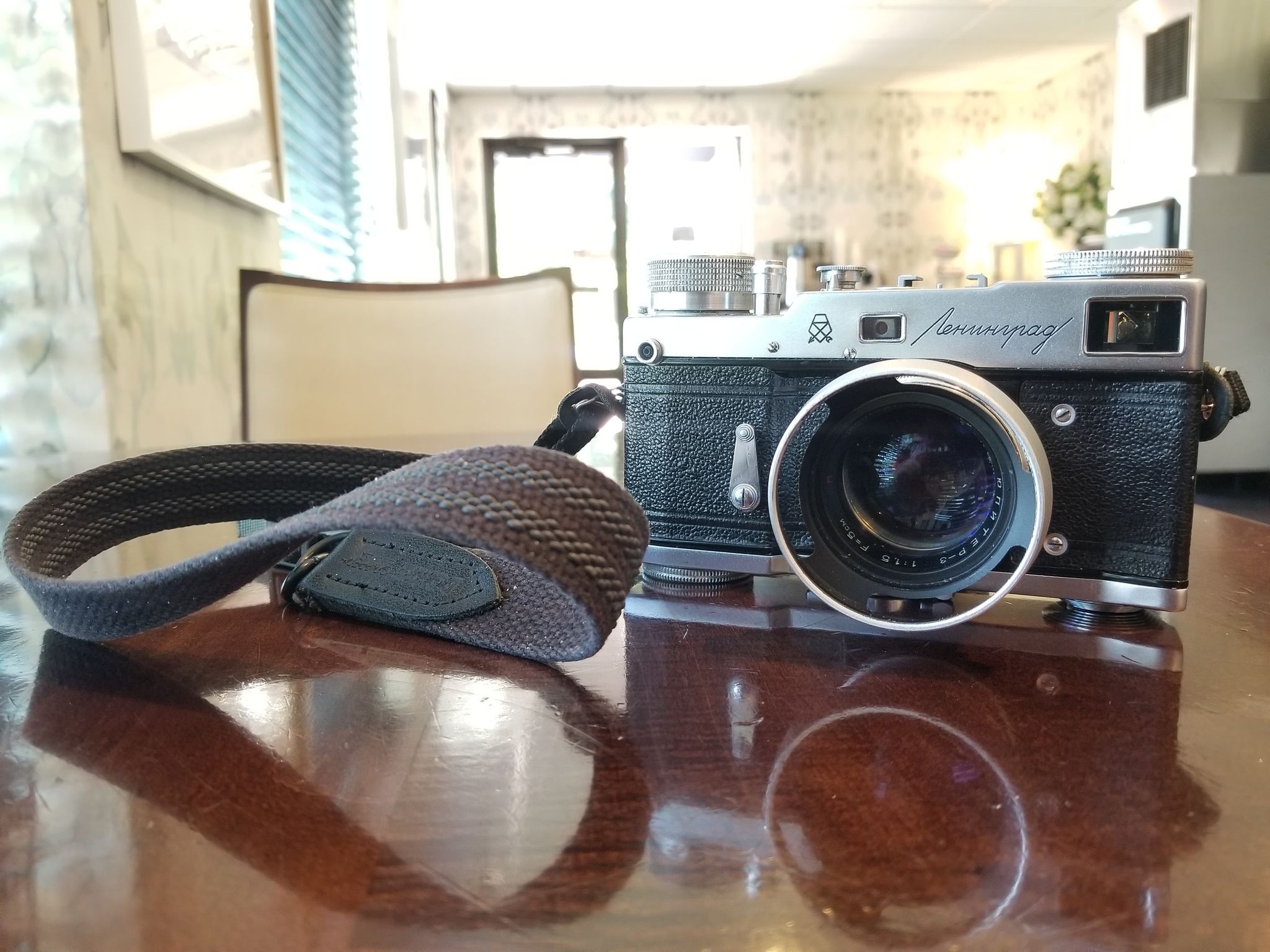

www.fedka.com send him an email his ebay store isn't always accurate. We've been good friends for a while and I will ask him to find me stuff without going to ebay. He found me this Leningrad with a complete CLA, Jupiter 3 50/1.5, 35/2.8, CLA'd an 85/2 for me, 28/6 Orion and he also found me that Helios 103 for my Kiev. Probably half of my Soviet collection he has had his hands on at some point. If you're really into Soviet era stuff those are the guys to talk to. The store is ran by Yuri Boguslavsky and his repair guy is Oleg Varvarin, both good people, not to be confused with Oleg Khalyavin from Kosmofoto. All three very good people.
They spent 4 months getting this Leningrad absolutely perfect and I'm glad I waited. They work on the other rare stuff, Drug (which I own one of those too) Mir, NKVD FED, early Zenit, Yuri helped me track down the correct versions of lenses for my Zenit-S and showed me which Helios-44 to get. They are good people
I don't know if they are doing repairs with the conflict in Ukraine right now.
