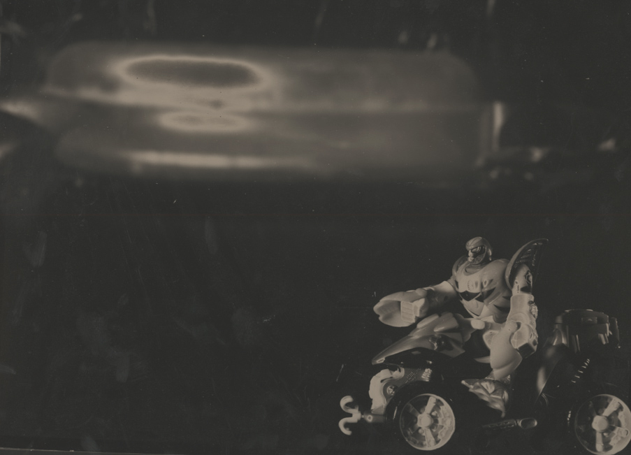

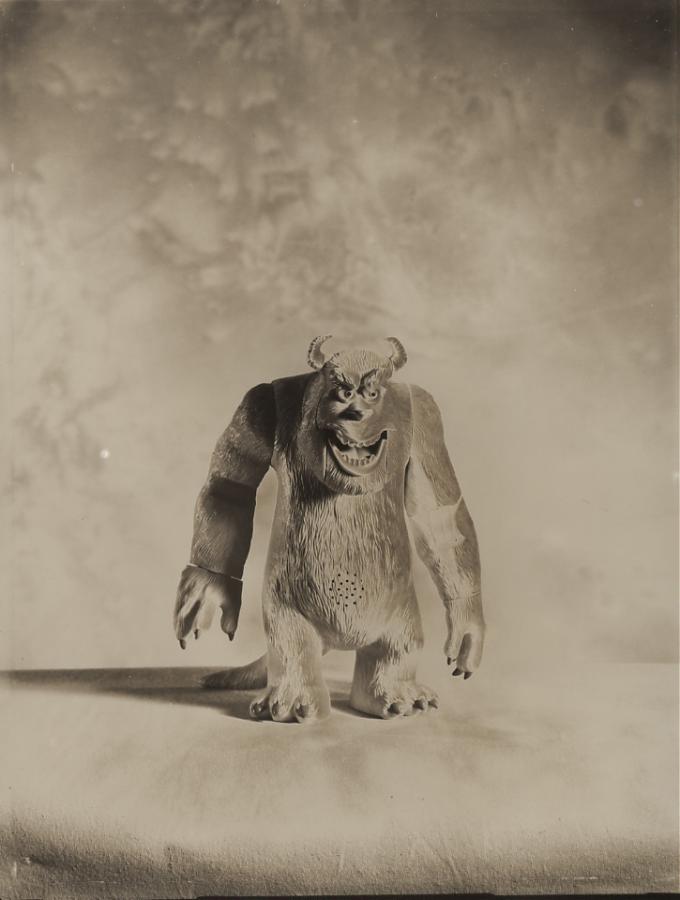

As promised here are two jpegs that are the start of my project.
The single image was my first idea, then I decided to put my objects in situations that suit their character,* powerranger leaving his space ship to dominate the world*
The portrait series is as silly as this.
I want to make these images in mural size there fore the big ass negative.
Sorry
Here is the first image that I took to start this series, but now I am going to put appropriate backgrounds around all my objects.
Eh- it's not so silly - I'm sure you know that. I've certainly seen sillier (Wegman, Les Krims, etc..) - I always say "it doesn't even matter so much what you start with - it's where you take it that matters... take it to the maximum and you can't lose.."
How are you doing that solarizing btw - is that on the print?

Yes all the solarization is on the print , and I have the setup made to do them very large,
Once you get the method its now only a matter of handling the paper size, Granted I will only be able to make one or two prints a day, and the Tri Toning is another day , but when they are finished I get a real satisfaction from all this sillyness, I am hoping others will enjoy them as well.
I am using a two developer solarization, basically the second developer is where the flash is hit, the chemicals are the same for both dev with the exception of massive amounts of potassium bromide so that after the development the grain structure is different for the unreal part of the image and when toned takes on a real colourful version of black and white.
I am using sepia for highlights, gold for upper midtones and iron blue for the shadows, this aspect alone has taken me months to get the right balance and methods.
The samples I have shown do not have the complicated toning .
