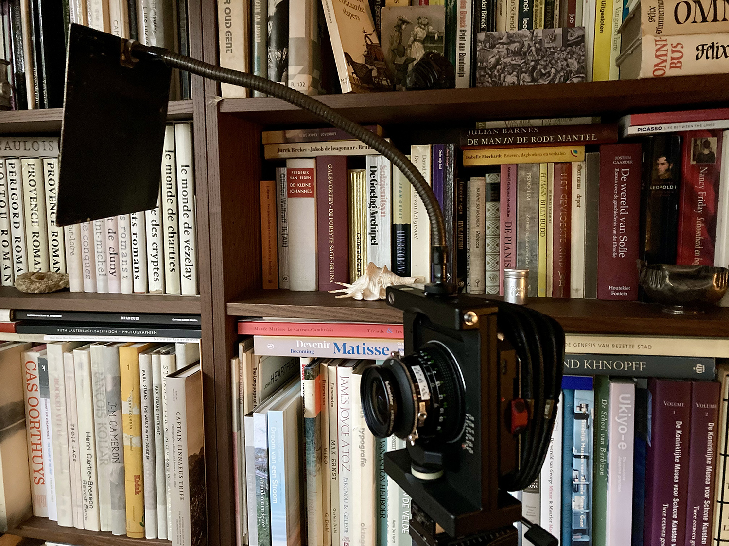

Inspired by some photography masters using their hat or a dark slide to shade the lens from the sun, I did some primitive and basic DIY...
My memory is a bit 'shaded', but somewhere I saw a simple system to flag the lens from disturbing light, it must be on a cinema set I think.
Anyway, I made something that looked useful to me, out of 100% recycled material: a gooseneck from a old desk lamp (about 25 cm long), the cold shoe mount of a broken smartphone holder, a 1/4" screw I found in a box, a piece of black painted aluminium plate, a left over of tube industrial glue, some black shrink insulator tube and what was left of my phantasy...
By this, I can see on the GG when that 'thing' is blocking the view, particularly when an extreme shift is applied, and my hands are free...
PS: the wide angle of the iPhone deforms the view and the gooseneck seems longer and the pannel larger than they really are...

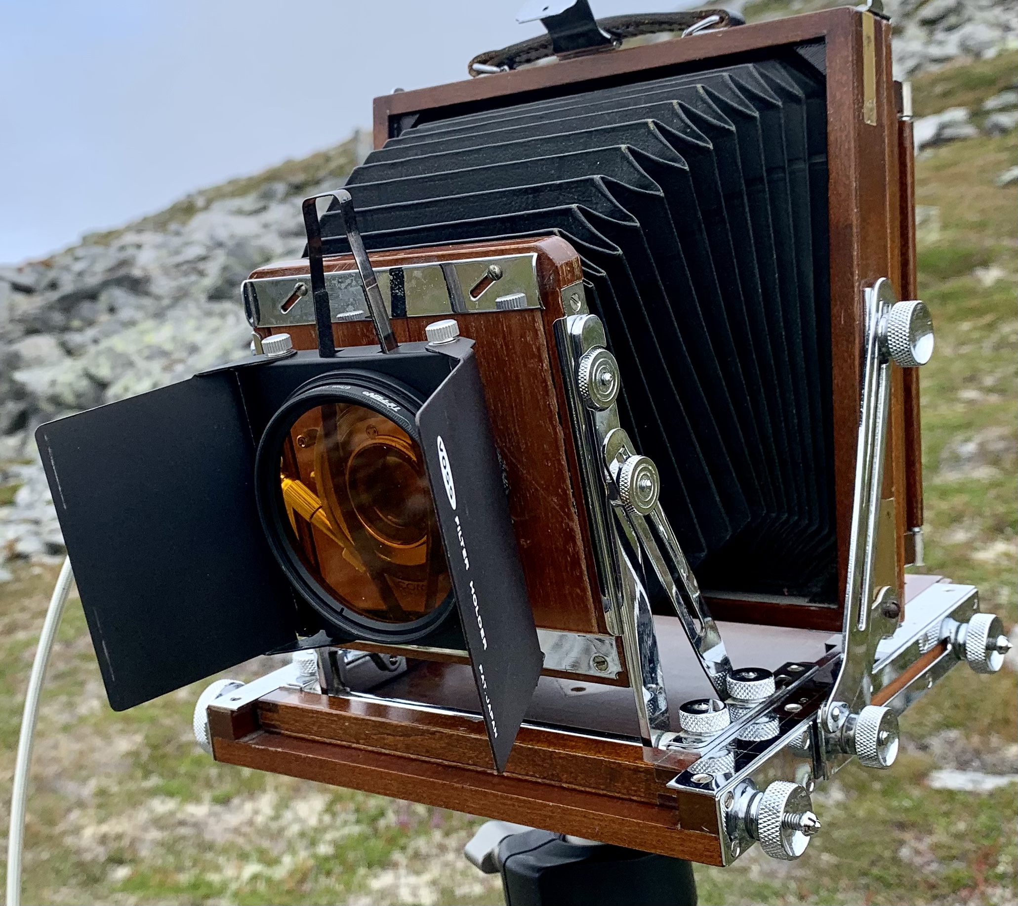

Here all mentioned set up with Anba Ikeda & Goerz Dagor ~ 150/6.8 & 67mm filter
I was using dark slide as third barn door.
