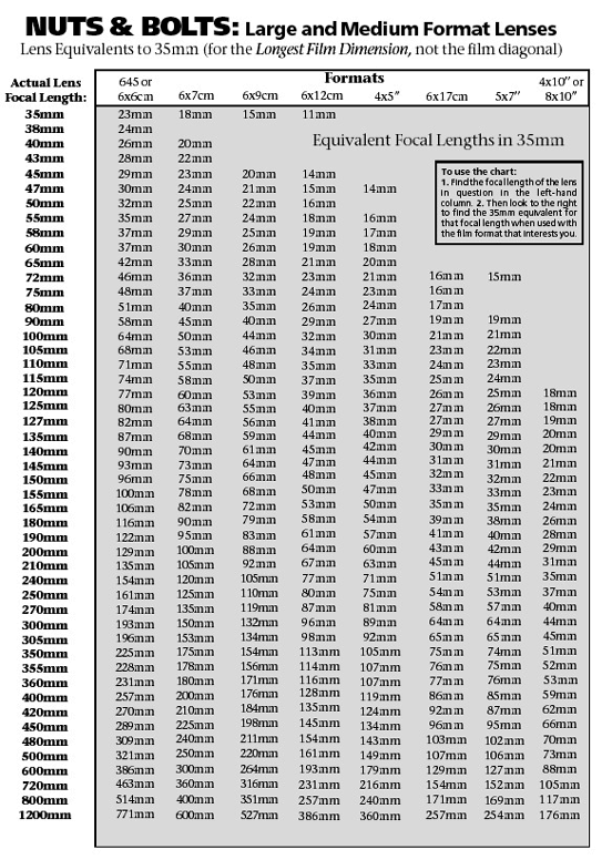

Will this chart help?
I think I got it somewhere on the LF forum.

Thank you david and Ole. David, I have that comparasion shart, but it isn't that :smile:
I guess diagonal are calculated by Pythagora's theoreme, square of hypotenuse is equal as sum of squares of cathetes, right?
